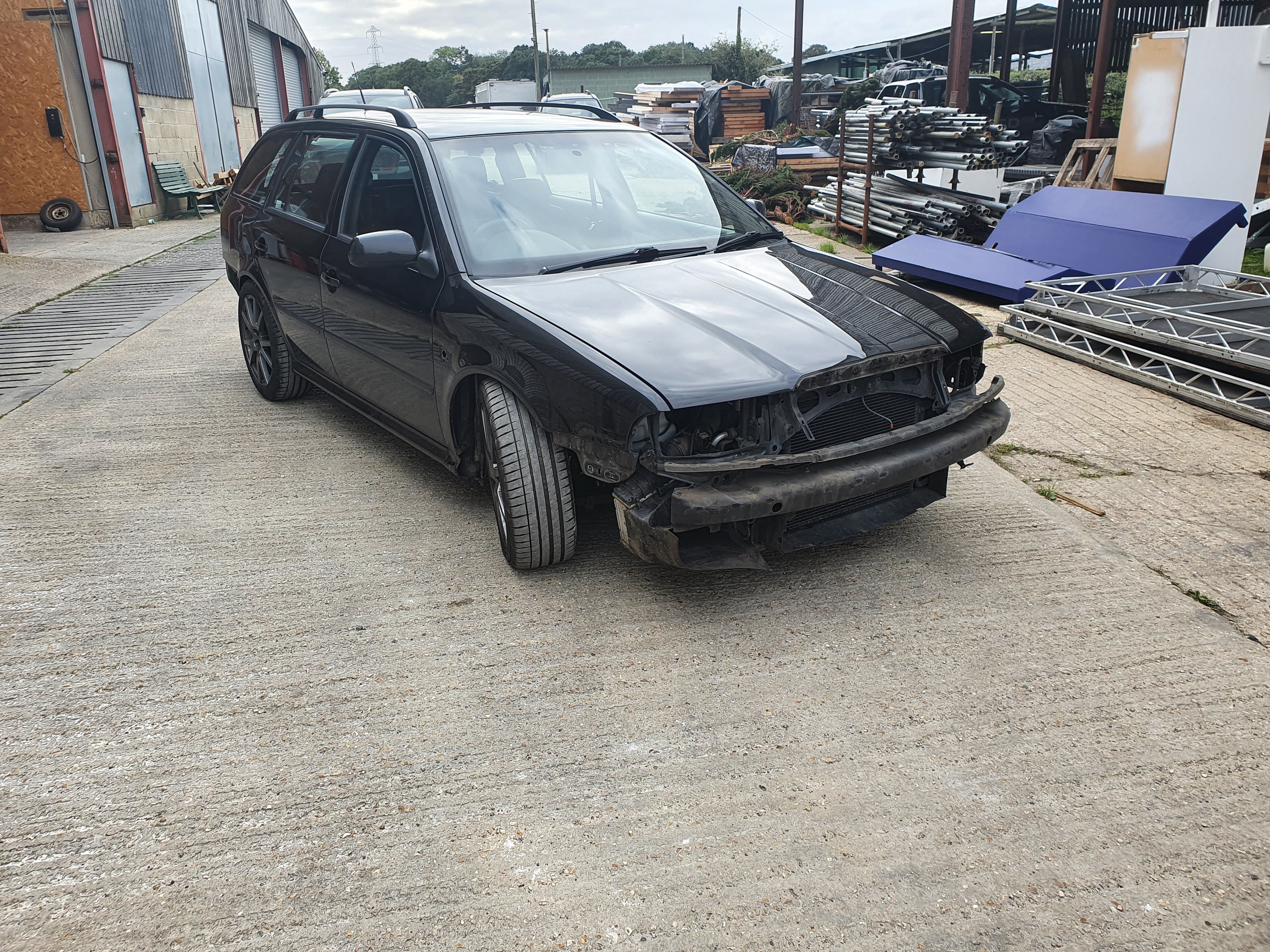

  • Slow progress, but here's a few photos of the first bits to be painted!   Both the front and rear bumpers took quite a while to bring back to a respectable condition, but I'm really pleased
  • Poor man's S4 Avant...  Until I can get the money together for a B7 RS4 this will keep me entertained! Got lots planned with a BBT K300 turbo next on the shopping list.
  • Got a few bits fitted, and out of the paint booth... First time it's seen daylight in 3 months! 😍

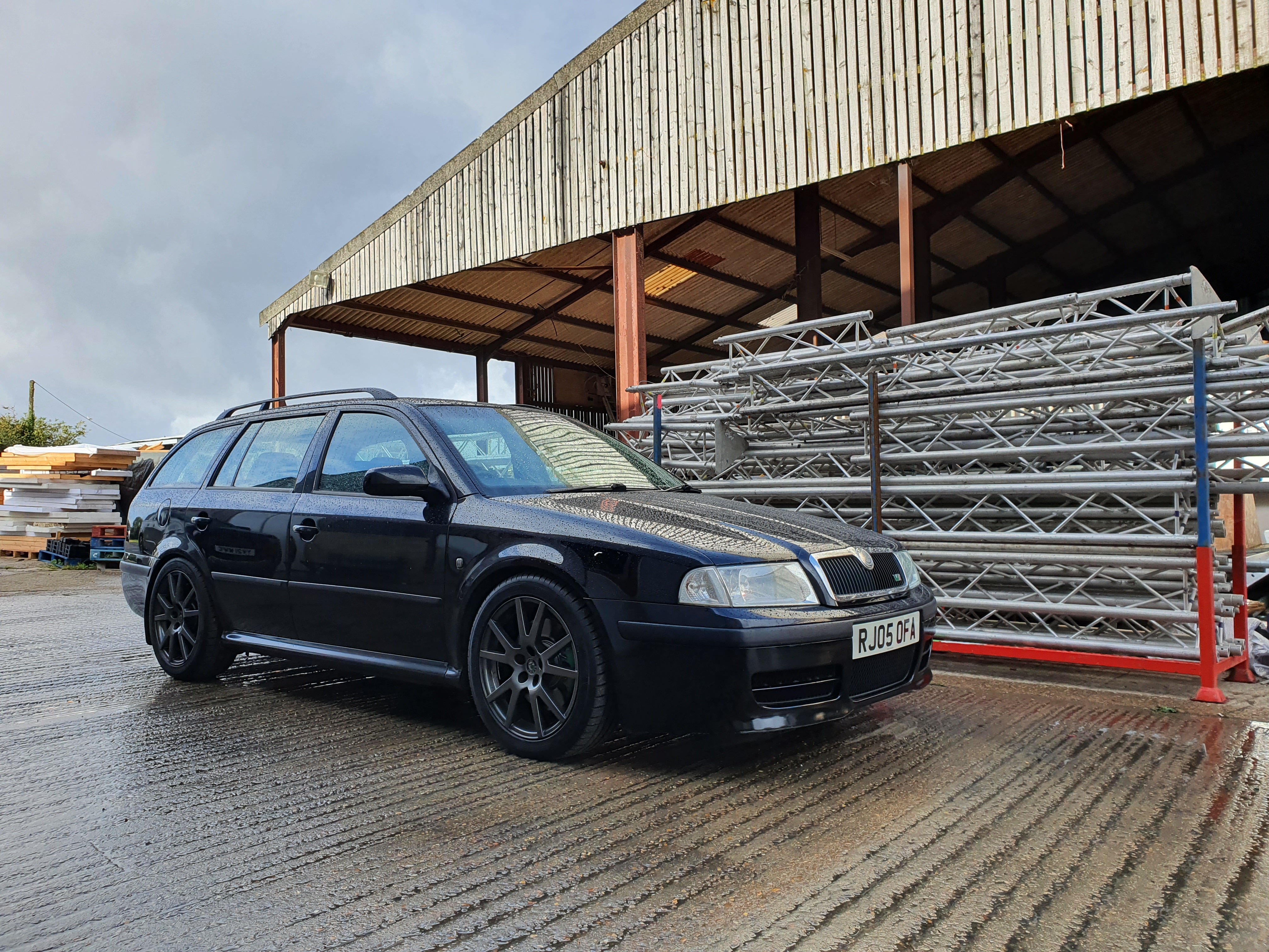

So the weekend just gone I had all the parts ready and I had the time to fit them, so here we go.

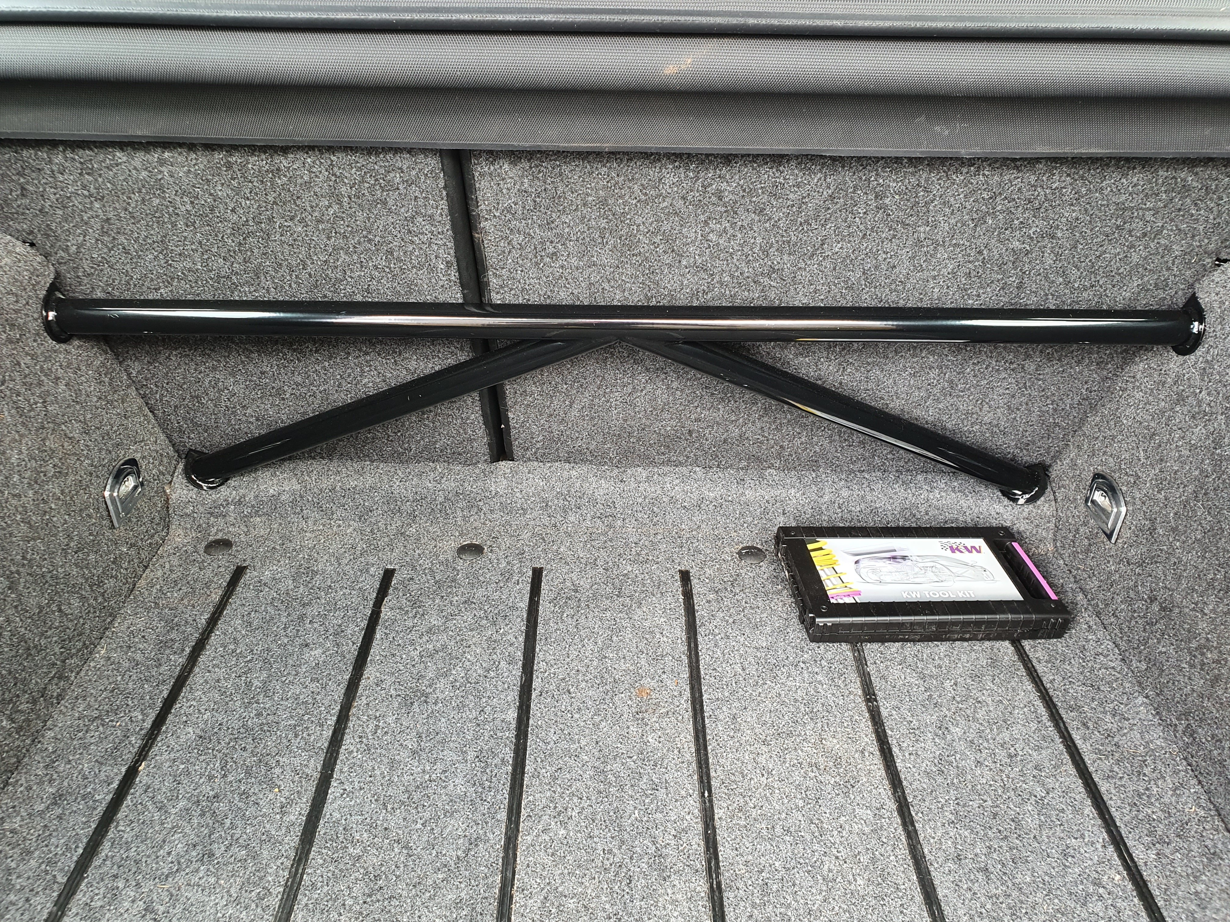

Firstly I fitted a Baf Motorsport rear 'K brace' as the Combi's don't come with any bracing in the boot like the hatchbacks.
IMO it looks great and certainly should stiffen the rear end much better than before!
I also replaced the rocker cover gasket as I found that was pretty worn and the plugs were wet with oil when I carried out my initial service a few weeks ago.
Nothing major but it needed to be done and has given me piece of mind.

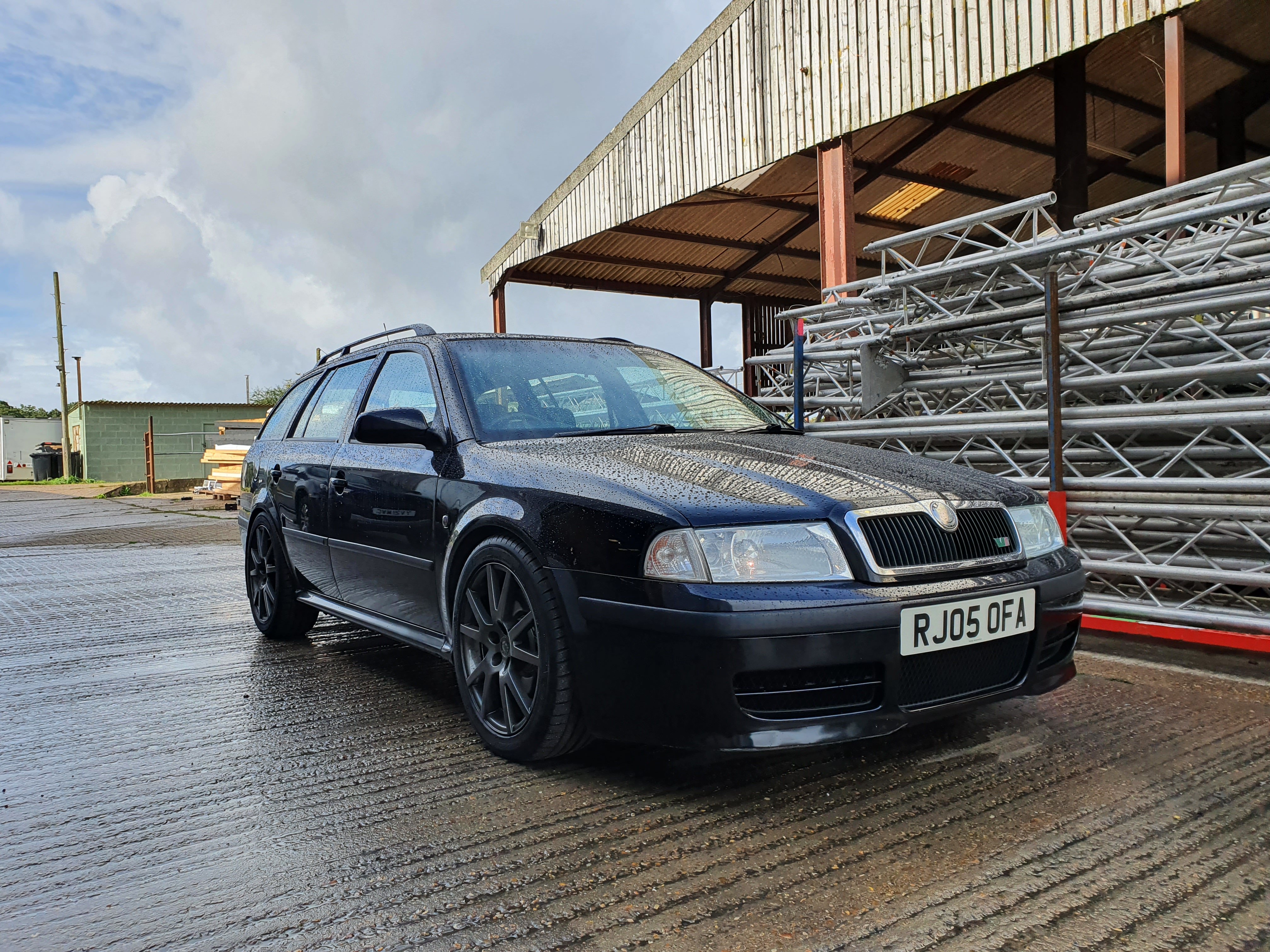

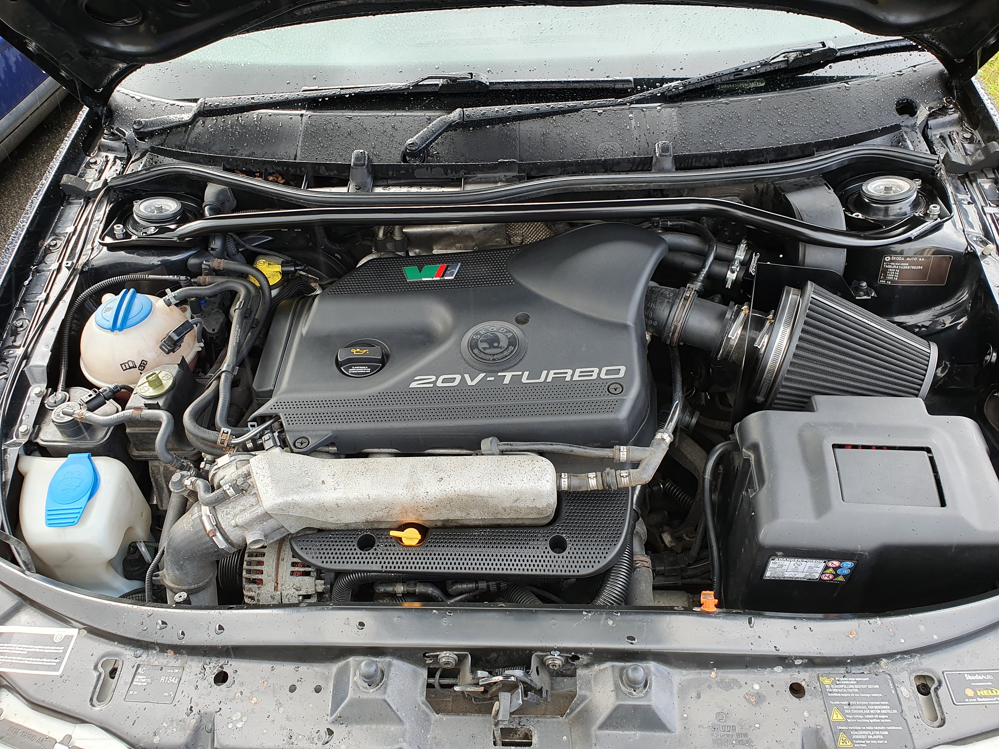

The suspension was next and I removed the very tired front and rear shock absorbers and have replaced them with some KW V1's and Poweflex front strut top mount bushed.
I had previously bought a secondhand Mk1 Audi TT front strut brace, cut the unneeded brackets off gave it a coat in gloss black and fitted it whilst the suspension was out with some nice stainless cap head bolts. Not bad for £40 all in!
The wheels went back on along with some huncentric H&R spacers 12mm up front and 8mm on the rear which has really improved the overall stance and I'm very happy with how they sit.
I kind of guessed the ride heights when putting the coilovers together, obviously measuring each side equally and it turned out okay. Although I'm going to let the suspension settle for a week and then adjust it to suit.

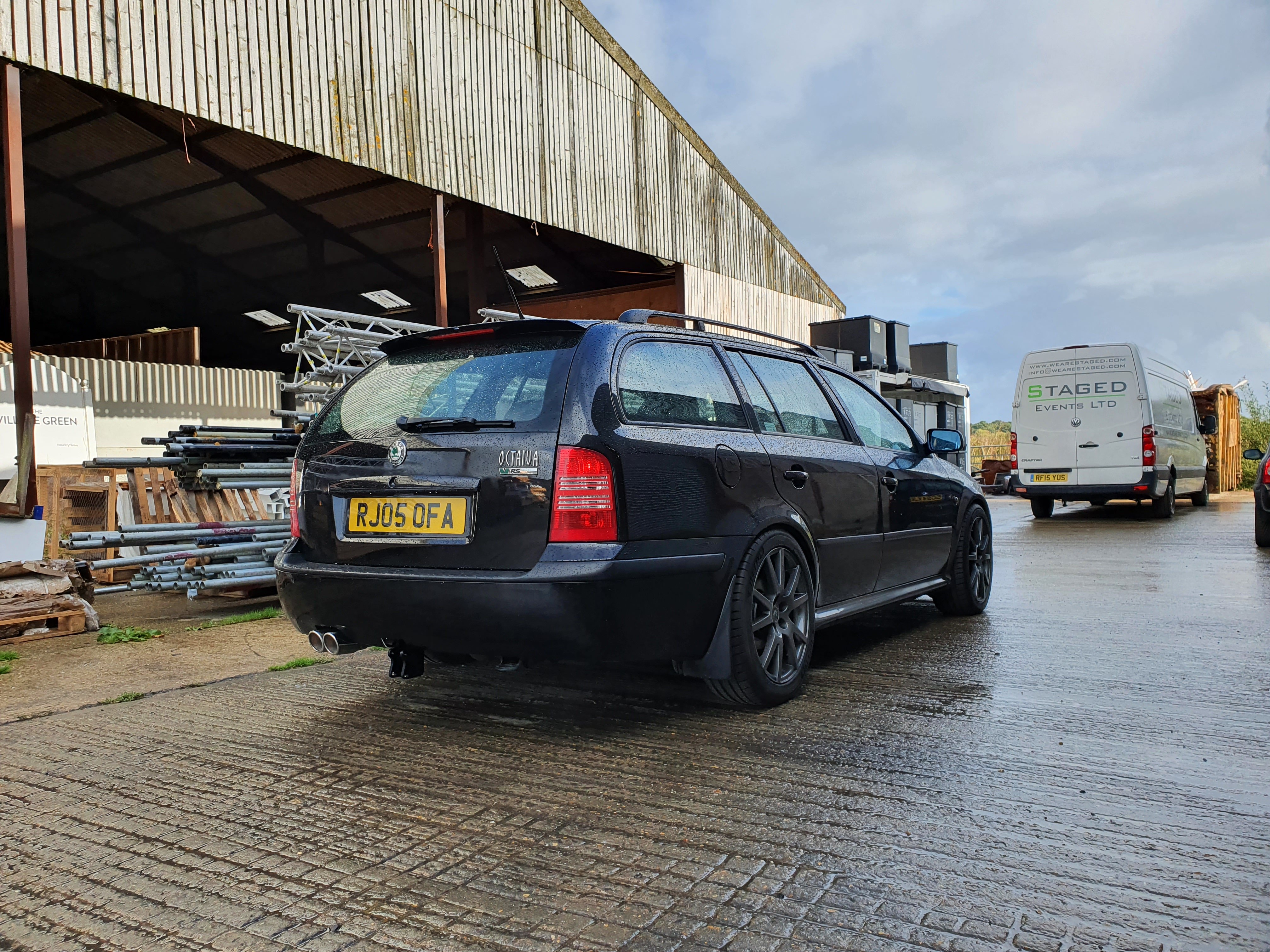

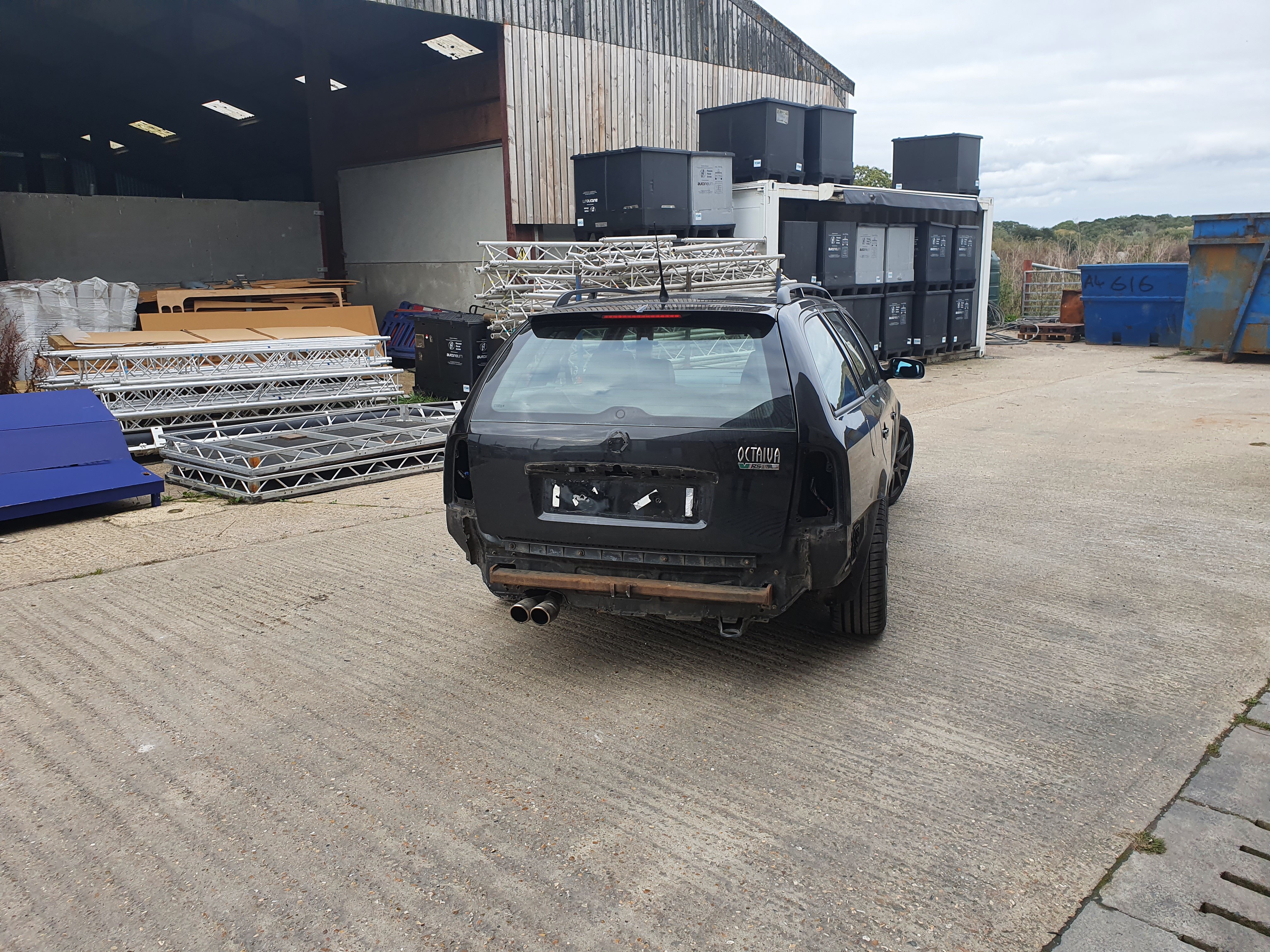

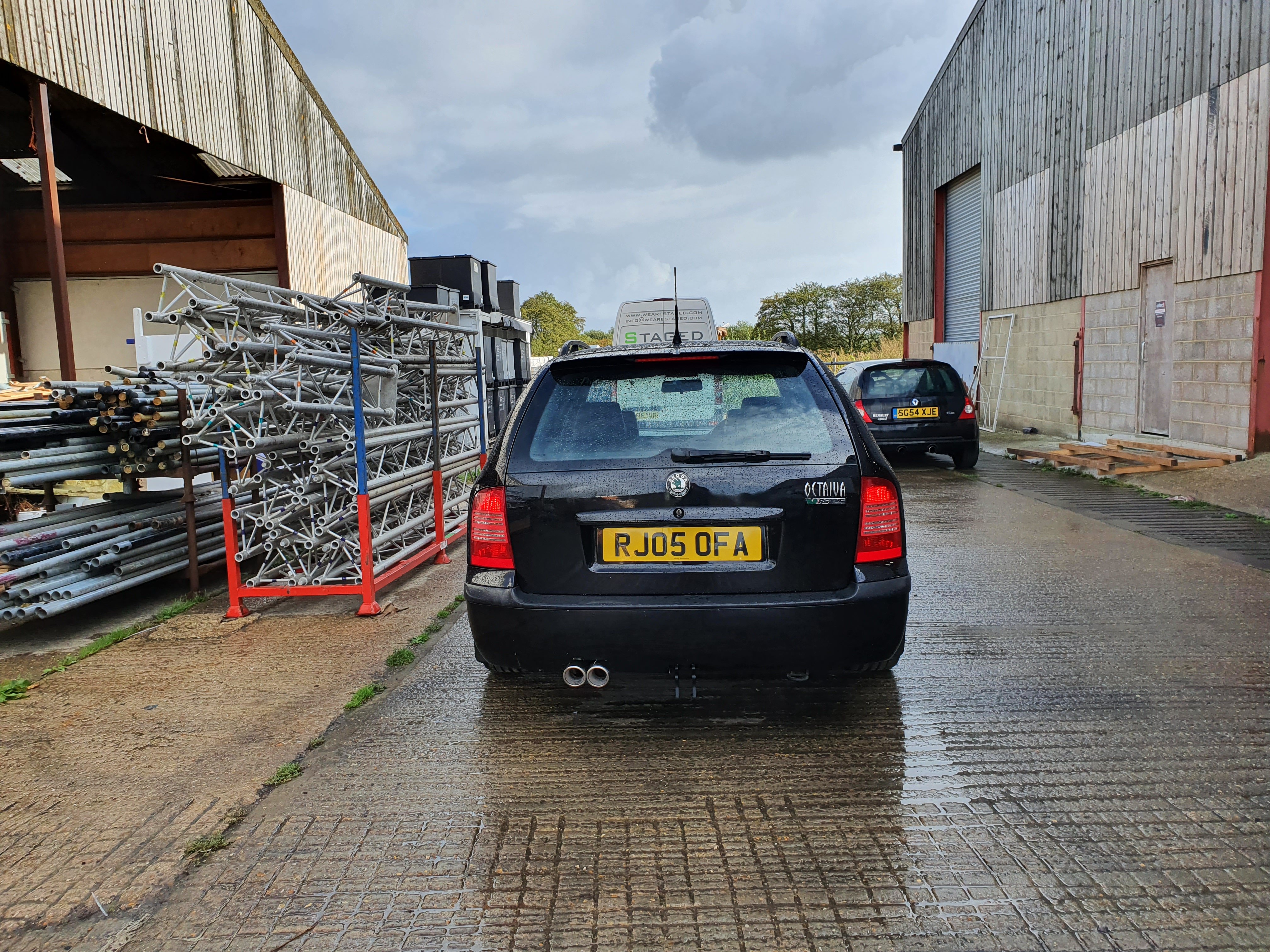

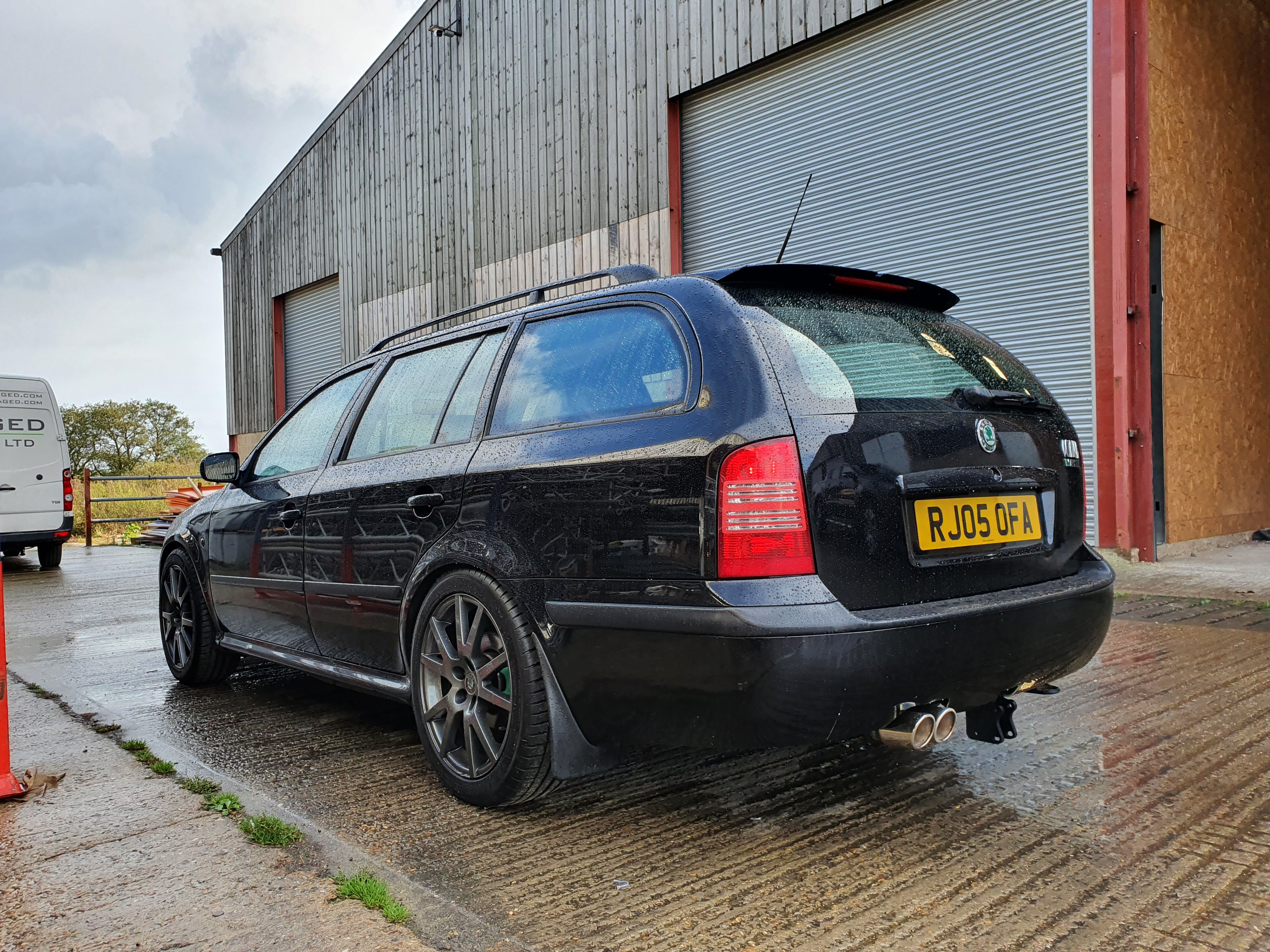

On Friday I drove to my local Longlife Exhaust centre and had a 2.5" system made no centre silencer but with a rear silencer. At the same time they fitted a MP Developments 3" downpipe with sports cat.
I'm really pleased with how it's turned out! I couldn't find an off the shelf system that I liked and I knew that Matt would be able to build something that I would. I've know him for years and this is the 6th system he's built for me and he's never disappointed!
It has a lovely deep note and no noticeable drone whilst on the motorway, the downpipe had definitely improved the pull under load. Overall a bloody good step in the right direction!
I'm sorry for the lack of photos of the various parts and progress of the install, but I get carried away and just crack on with the work! I have much respect for the people that catalogue every detail of their build. 👍

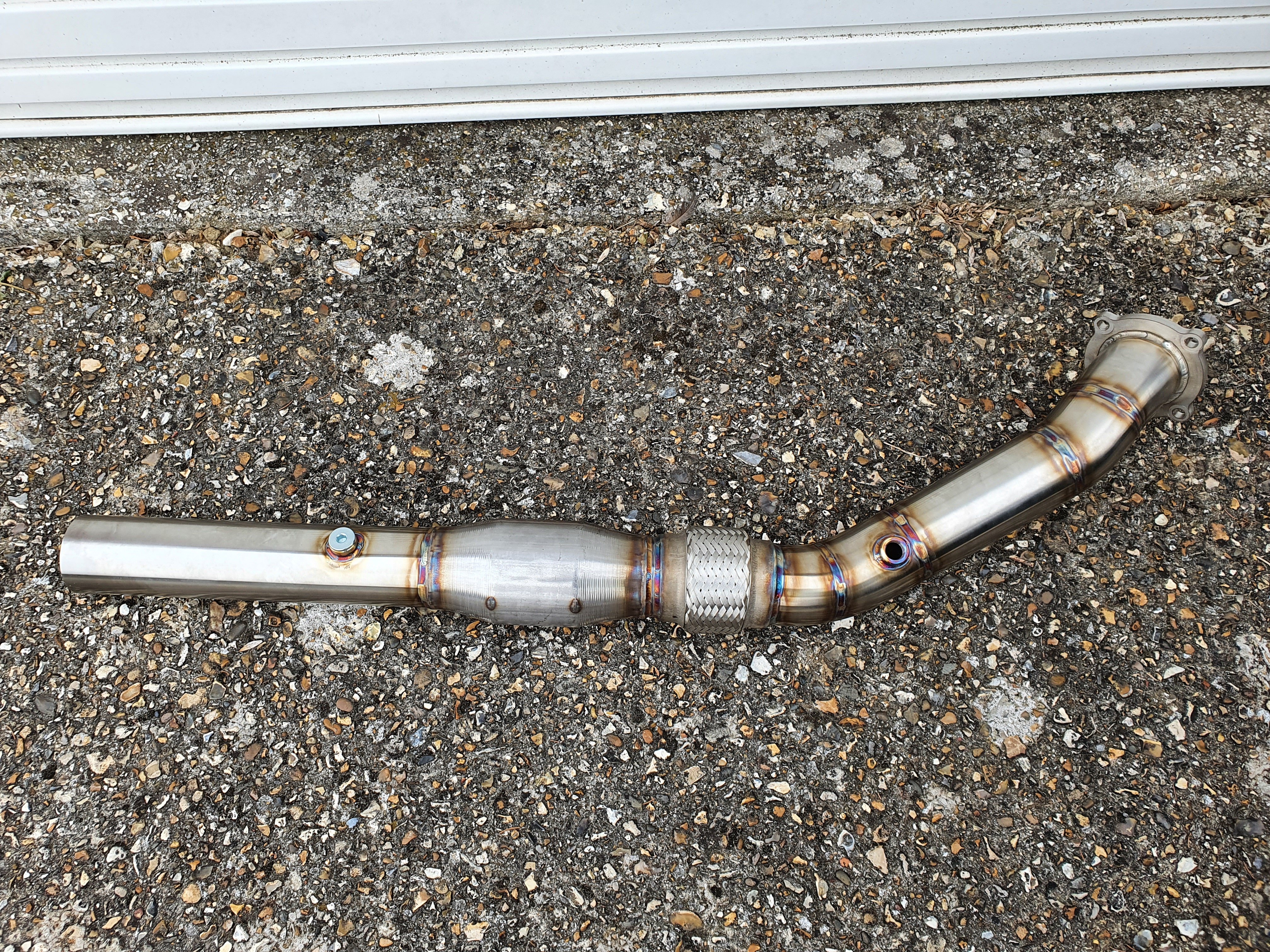

Happy to chat about the exhaust mate, I paid £550 and that included the fitment of the downpipe I supplied. I lucked out with that also and bought it brand new via ebay for £250 from a chap that never fitted it and had since sold his Mk1. 👍🏻
I did take a photo of the downpipe actually which I'll include here.

Got a k brace wating to go in mine (and waiting for swmbo to assist with bolting up the tt front brace), building up the courage to drill the holes.

The drilling isn't too bad, just make sure you get everything in the correct place and I would highly reccomend using a centre punch to assist the initial drilling.
Both for the strut brace, and the k brace.

Yeah man... I kinda cocked up the thread title, typically.. https://www.briskoda.net/forums/topic/492161-this-ones-ours/
I've already drilled the turrets, used masking tape, fairy dust and prayer - not the latter, I'm not religious. I just need a smaller pair of hands to get under there, save me jacking it up.

Haha I get that bud! It's certainly doable with everything in place but much easier with two people.
With the shock absorbers removed I had lots of access!

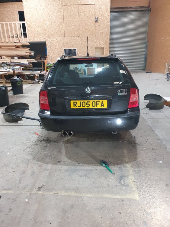

I've finally started the process of getting the car ready for its respray!

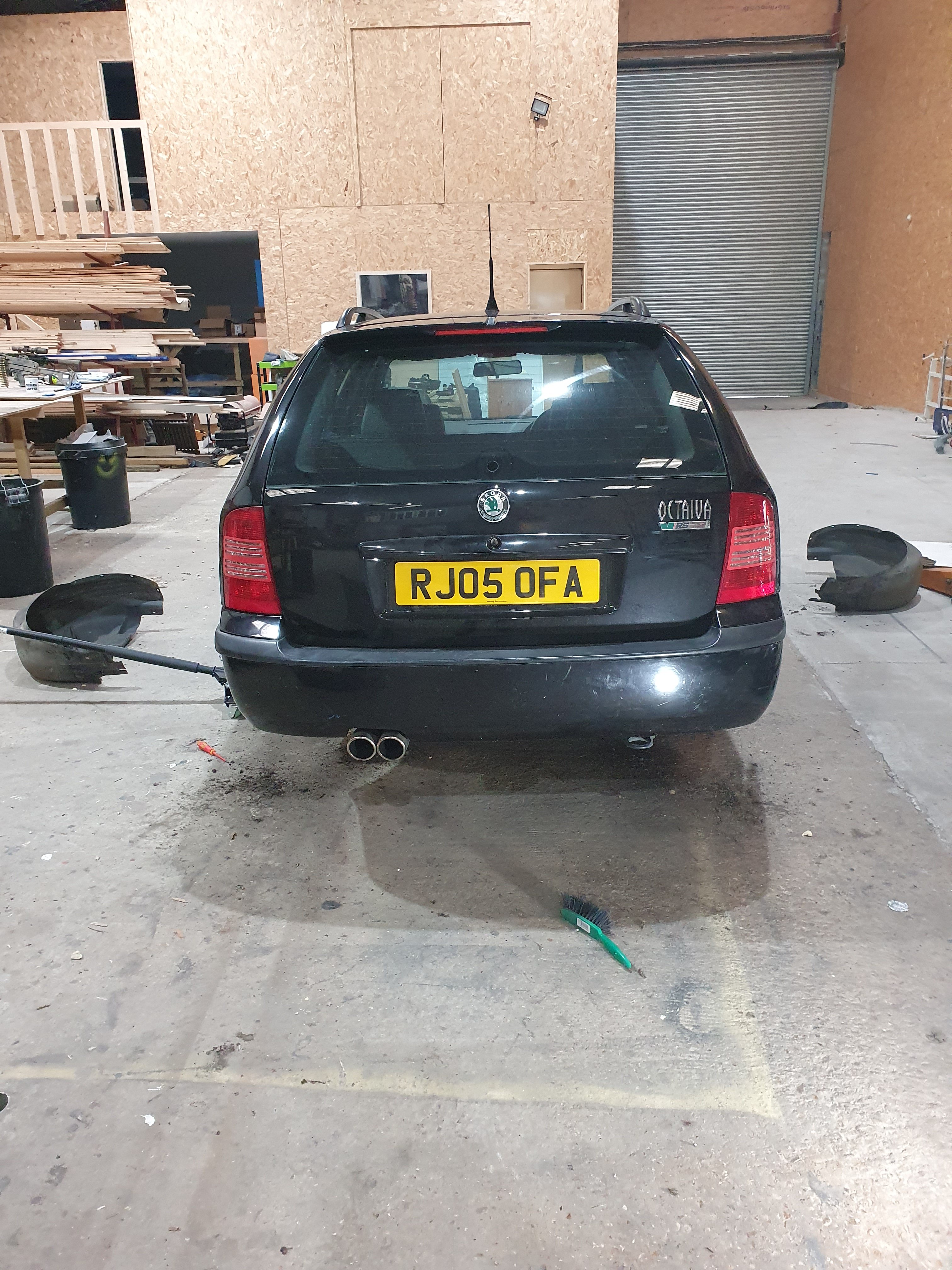

Today I got the rear bumper off and tackled something that's been bugging me for ages... The tow bar bracket IMO is hideous and I have no intention of using the car for towing.
I removed the crash bar and cut the bracket off with a plasma cutter - a little over kill but such an awesome bit of kit!
I bolted the bar back on and offered up a secondhand bumper I picked up without any cutouts and I'm bloody chuffed with how much better it looks.
I continued stripping and got the front bumper off, all four arch liners, headlamps, taillights, side repeaters, and the tailgate trim.

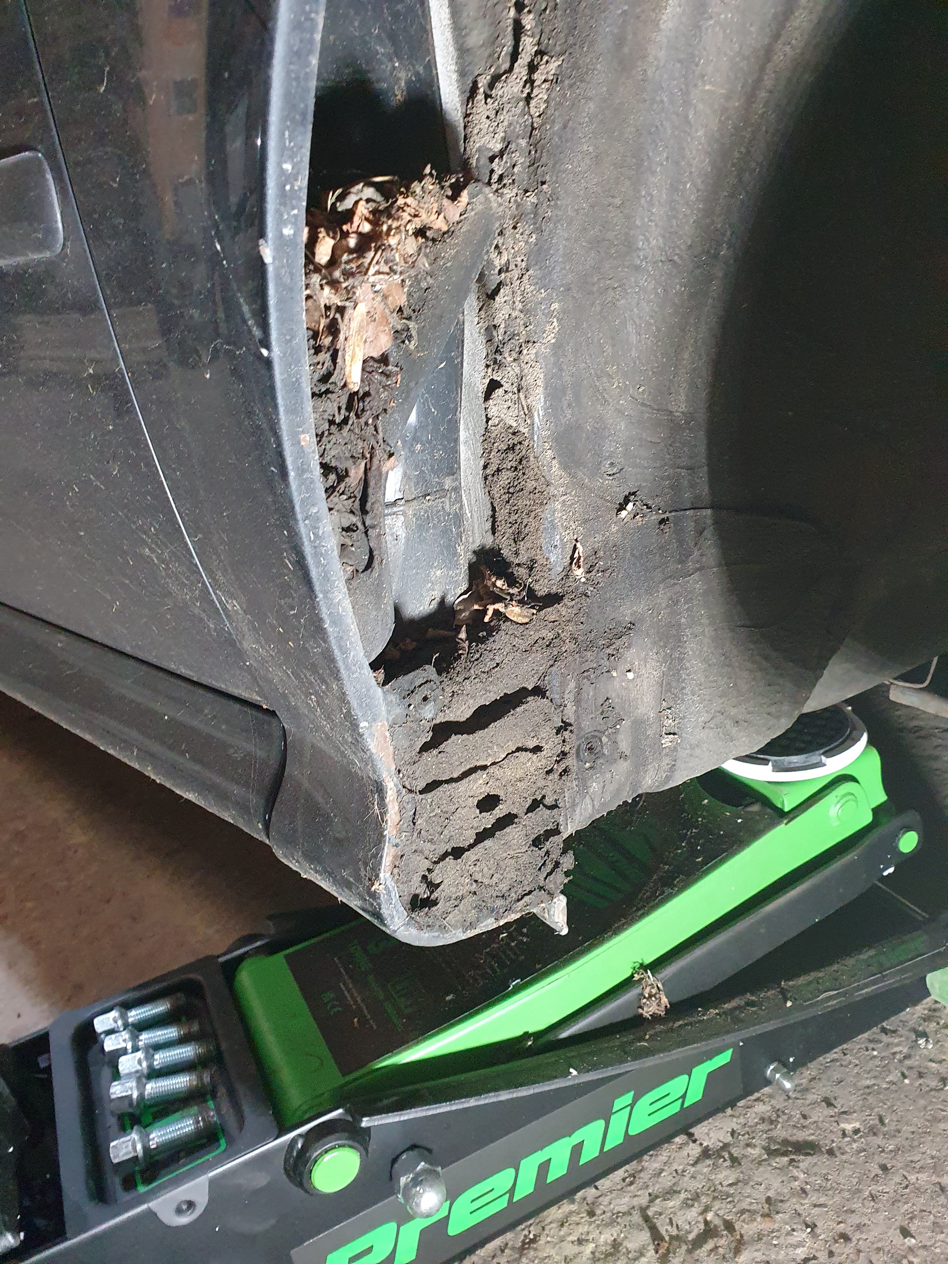

I didn't find any horrors when removing the arch liners etc with bodyshell in good condition, even the tailgate only has minimal corrosion a well known issue with the Combi.
The only corrosion I do have to deal with and treat is behind the window rubber on the offside rear door and the bottom of both the wings.
One note on the wings, if you haven't already I'd remove the arch liners and take a look behind them as I must of had about 2kg of earth/sand back there! absolutely horrendous, I can't imagine why the wings are suffering with rust! 😂

The grot behind the arch liners is well-known, I really need to do mine... only been on the to do list since March. 😐

I'd highly recommend having a good clear out behind those arch liners!
