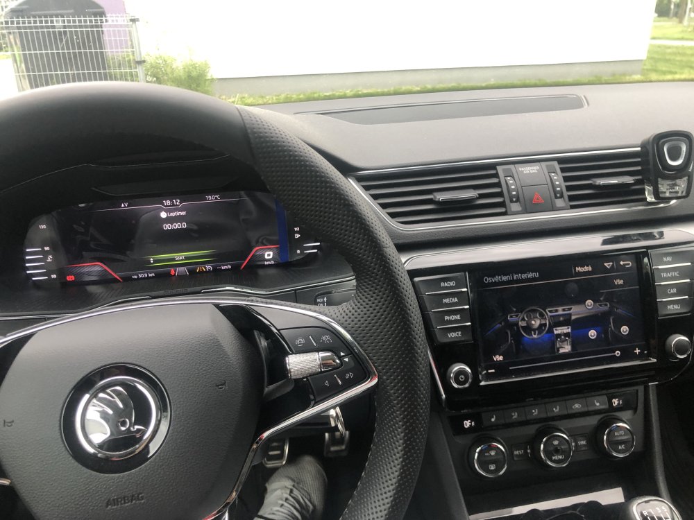

  • @Andrei1496 i have sent PM to You with scan from my 2016.02 Style with factory fitted ambient light maybe some bits will be handy
  • @MartiniB It worked!!🥳 My bad was that I had the IDE09732-ENG115870-Interior light: light configuration-Ambiente_Applikationsleisten_in_Instrumententafel not active and what was turning the color

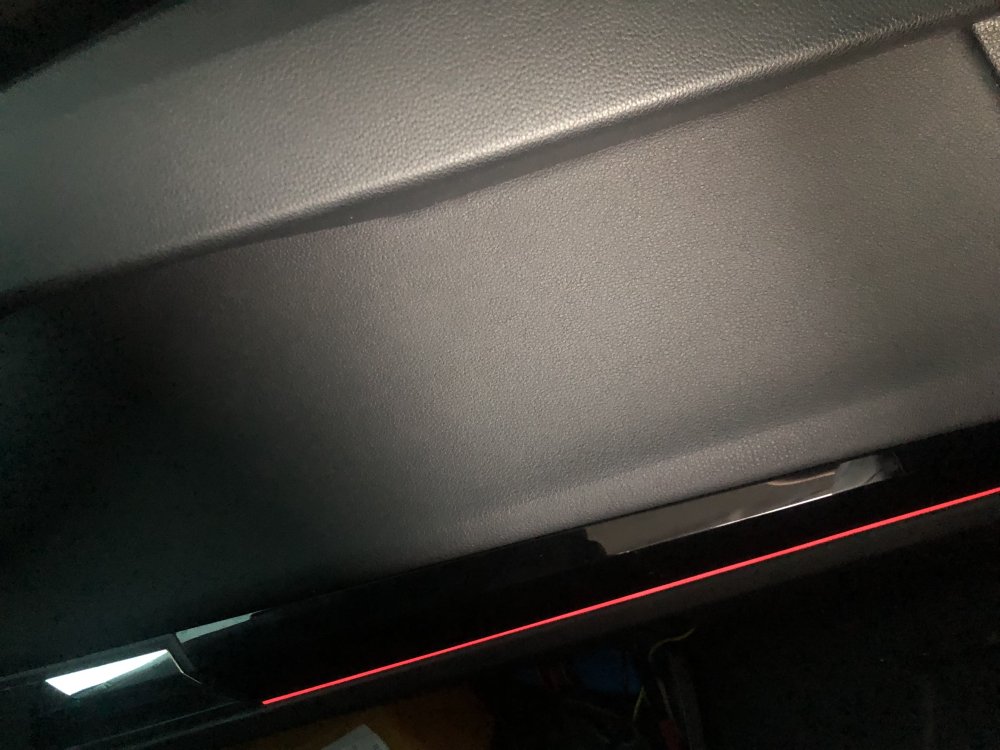

So I made progress today and finally got the paint on the door trim.
I managed to activate it, but with the error that it is not possible to select another color, the program only lights up in red, but only when the door is opened. Brightness adjustment already works on infotaiment.

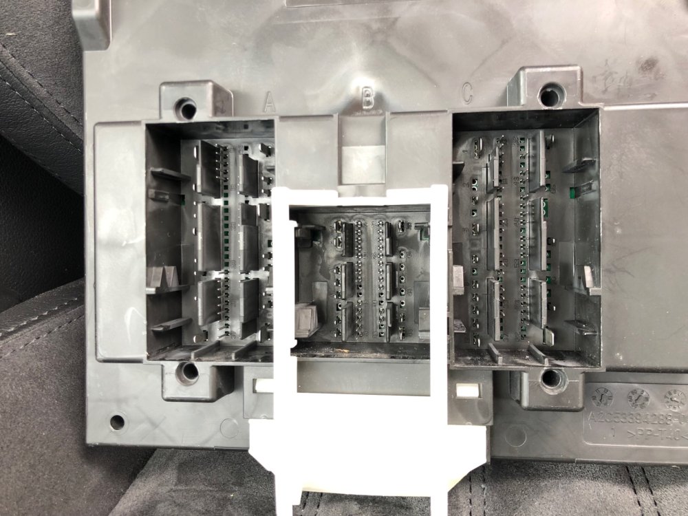

Somehow I managed to block all the rear lights of the vehicle, neither the blinkers nor the lights work, day or night :) .
I am attaching the details of my 09 unit.

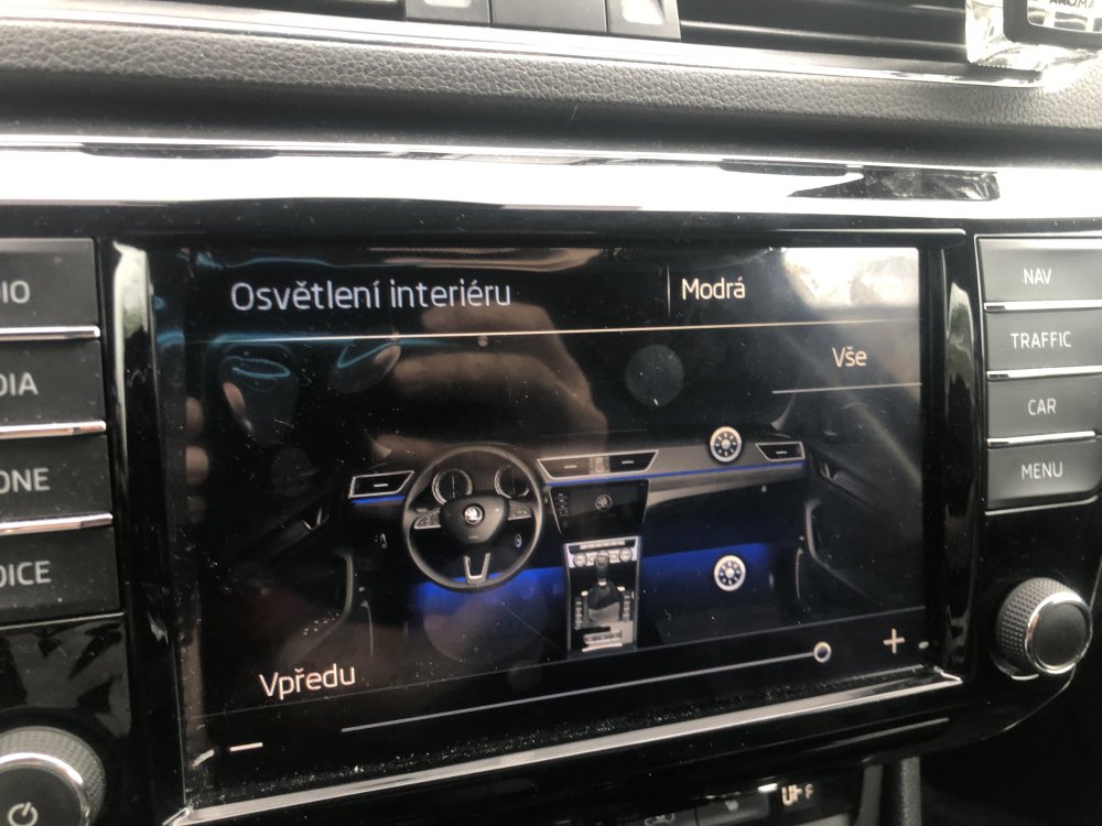

On 24/02/2023 at 17:25, Andrei1496 said:
@MartiniB yes.

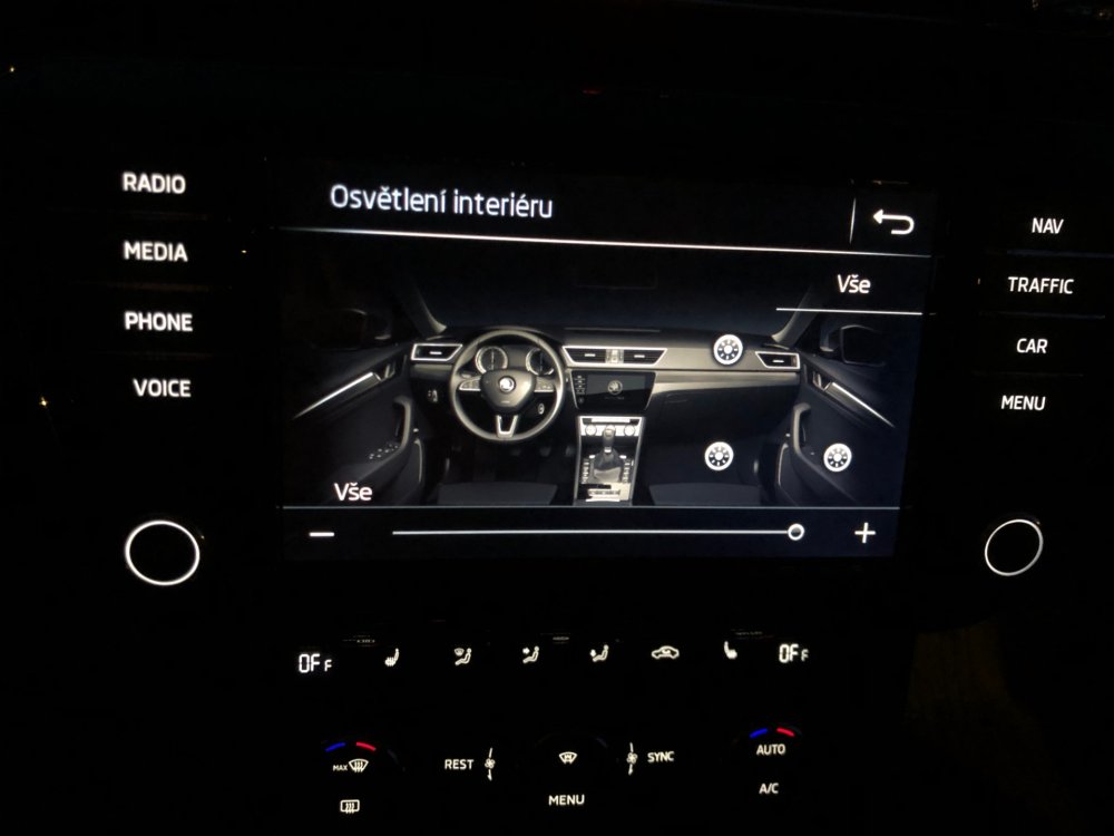

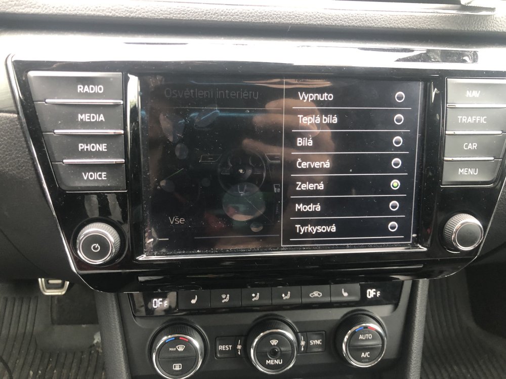

IDE11477-ENG128654-Interior lighting: parameter-p_farbauswahl_HMI is responsible for the color number in the dropdown.
I had the value 07 (00000111 - only 3 colors enabled) in my channel and I've changed it to 7F (01111111).
I tried this because I thought that maybe I could add a 7th color.
I think the correct value should be 3F (for 6 colors) but I haven't tried it yet.
I saw that you have the value 19 (00011001) in this channel. You could try with 3F or 7F too and see if it will enable the others.
These are the values that can be entered in there as I know:
00000001 - Warm White
00000010 - White
00000100 - Red
00001000 - Green
00010000 - Blue
00100000 - Turquoise
01000000 - Did not add another color
10000000 - Did not add another color
Use this conversion table as an example: https://kb.iu.edu/d/afdl
Let me know if it works 😁

@Eki1002 you can see the adaptations list in the last post😁
It's working now!!🥳
The problem was that someone told me that LIN is purple, 12v is yellow and GND is black and actually LIN is yellow, 12V is purple and GND is black.

Hello,
Does anyone know what are the pins in the Front Door modules for 12V+ and GND for the ambient lightning?
Thanks in advance!
Hello again,

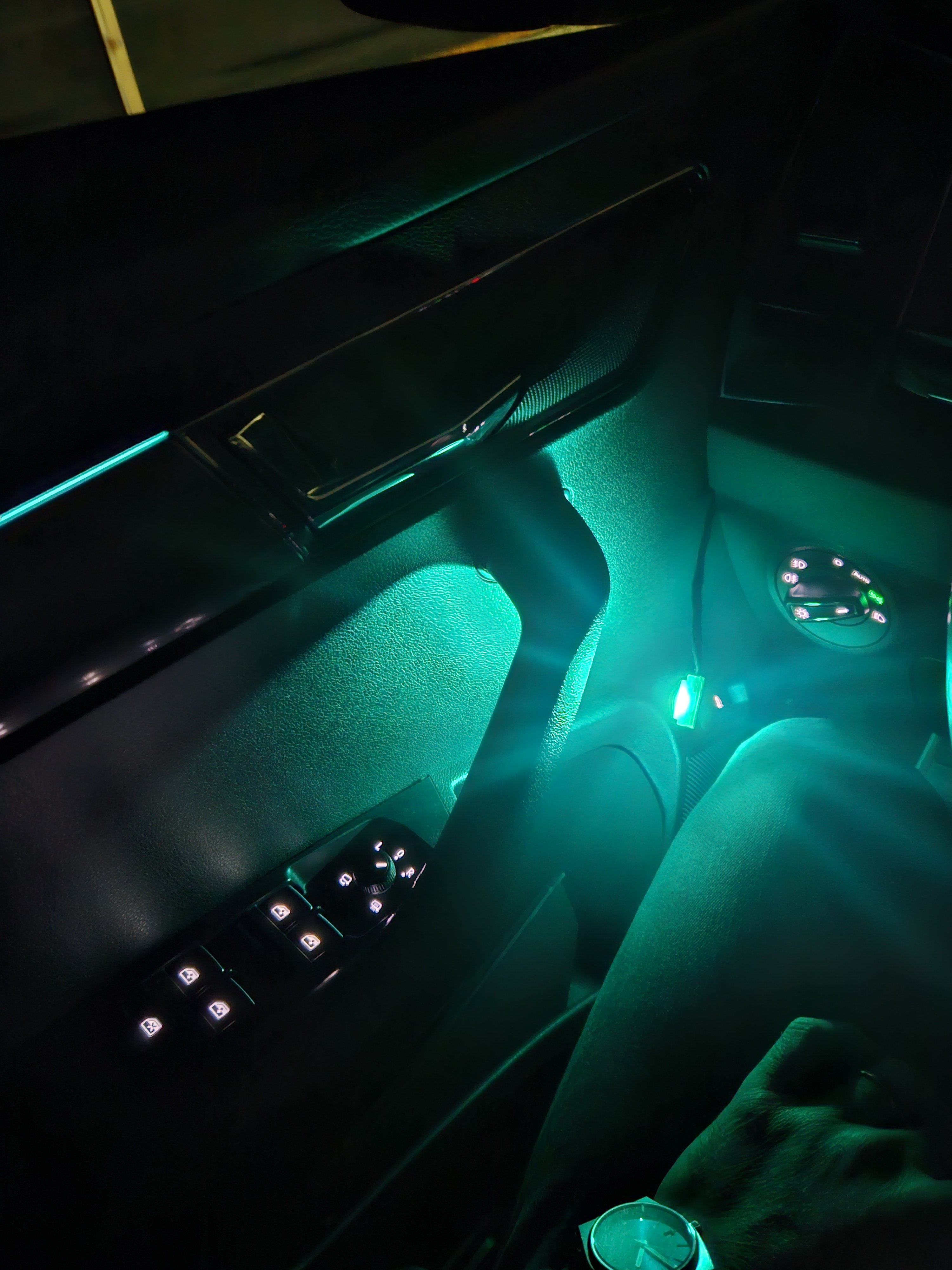

I got things done, all the ambient light strips are in place on the dash and on all 4 doors but I have a weird behavior. Everything works normal but when I go to the car and unlock it, without opening any door, only the dashboard ambient lights are turning on and the ones from the doors are turning on after opening one of the doors. I checked and there is constant 12V in them so what could be the problem?
There might be a coding issue?
I'll leave the AD MAPs here from 5F and 09.
Please help, I have no other clue on what to do here, thanks in advance!😁
adpmap-5F.CSV adpmap-09.CSV
As a solution for the problem on top, all I had to do was to change IDE11477-ENG128524-Interior lighting: parameter-p_helligkeit_entriegelt_tueren from 0% to 100%
Loosely translates to "door brightness when unlocked".

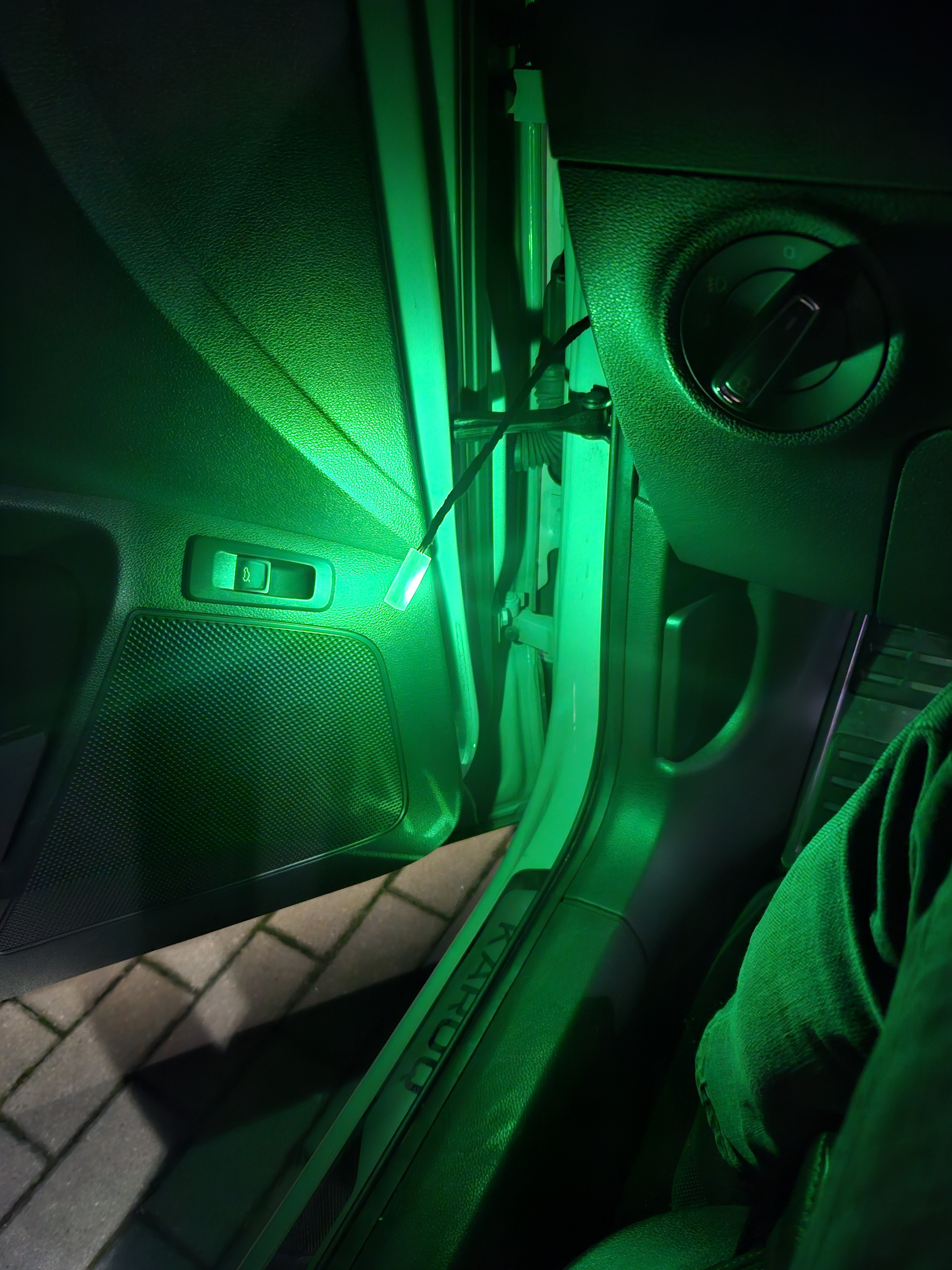

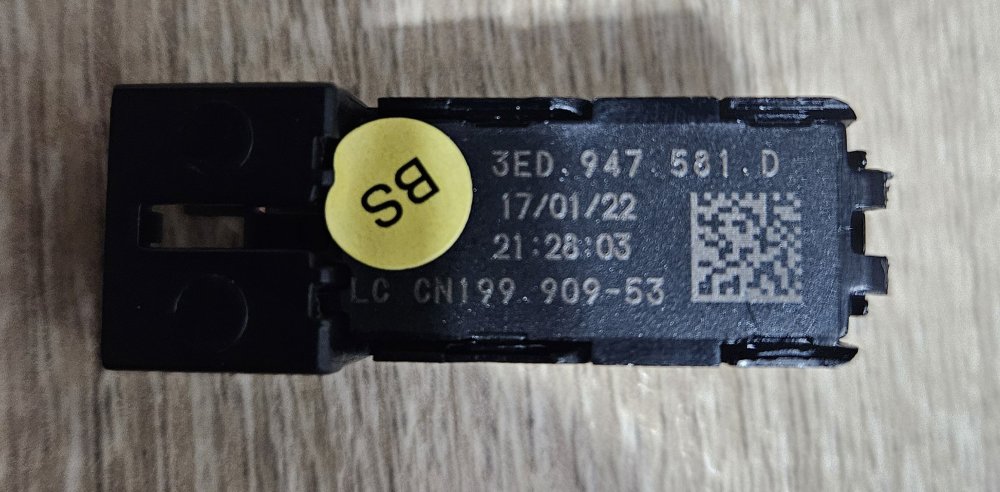

Hi guys,
I recently bought 2 RGB LEDs for the door handles from aliexpress. I have connected them to the car(using a Y cable and taking the power and LIN data from the dashboard RGB light) and the color changes as it should but I am not able to do any dimming of that LED. I assume I need to do some coding, maybe to assign the new LED to a group maybe, or something.
Does anyone has any idea?
Thank you!
As you can see, the light is too bright, way to bright to use it as a door handle light.
2 hours ago, Viorel_92 said:
Wie Sie sehen können, ist das Licht zu hell, viel zu hell, um es als Türgriffbeleuchtung zu verwenden.
Does that mean you can dim everything normally, but the AliExpress LEDs always stay at the same brightness?
Yes, the Aliexpress LED always stay at the same brightness. All the other RGB leds brightness can be controlled except the aliexpress leds
