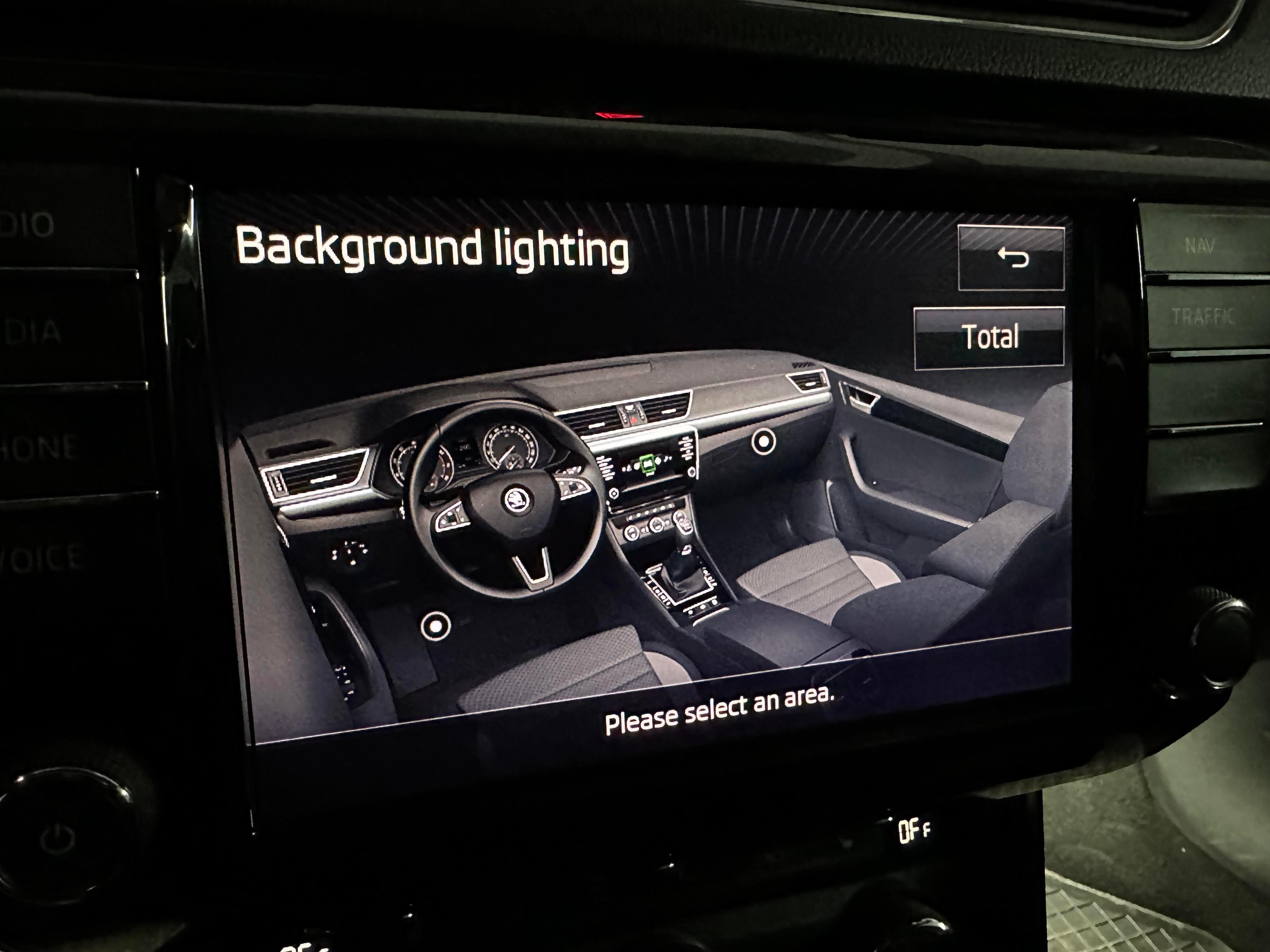

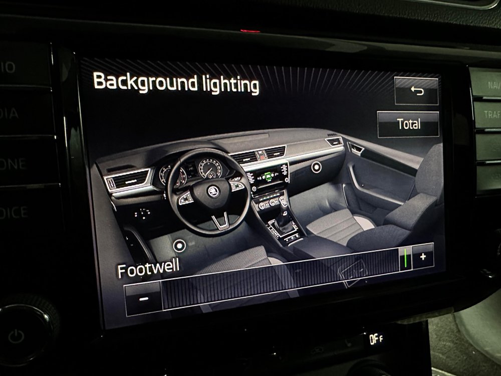

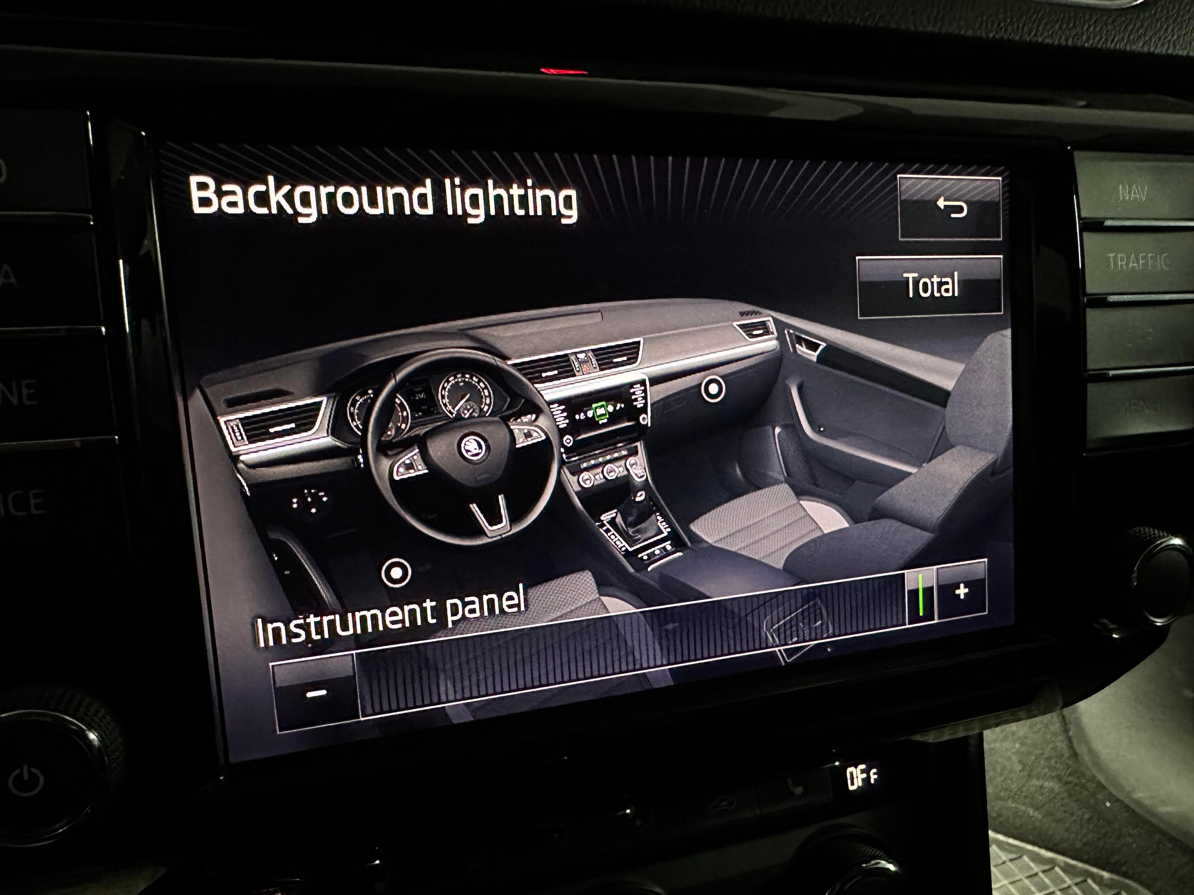

I followed the steps and I've got some things enabled and it looks like it's gonna work but there is something that it's blocking me.
I've managed to enable the Dashboard and Footwell selectors (I only wanted these two) but it looks like it's only the brightness slider active.
How can I enable the color dropdown that should be in the top right of the screen near the back button?
What are the settings that needs attention in adaptions that are controlling that colored dropdown?

@numskullyou missunderstood, I don't want the color slider, I want the color dropdown that has the 3 colors in it that is in the top right of the screen. I want to know how to enable it because it's missing from my screen.

@JR RSI know that, thanks. I just want to enable the color dropdown, not the color slider.

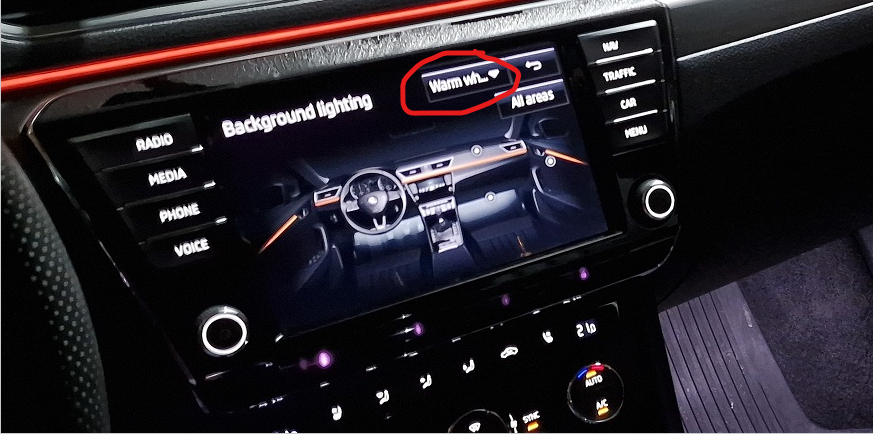

45 minutes ago, MartiniB said:
@MartiniBThank you but I already did that.
My problem is that the color dropdown is missing (I'll mark it on your picture below and you can make the difference that is missing in my previous post) and my question is how do I enable that dropdown that contains the colors I've set in the channels you've mentioned?

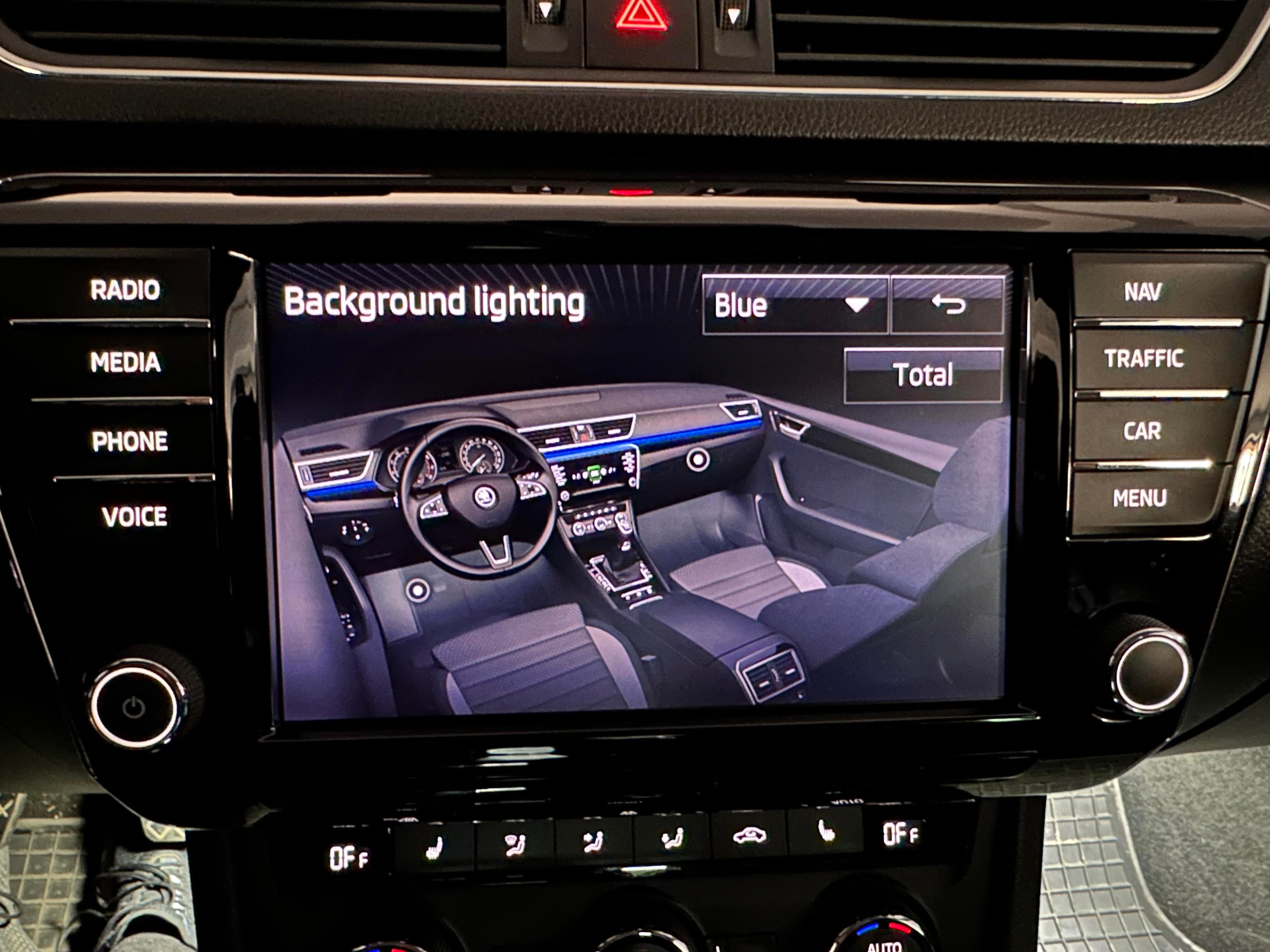

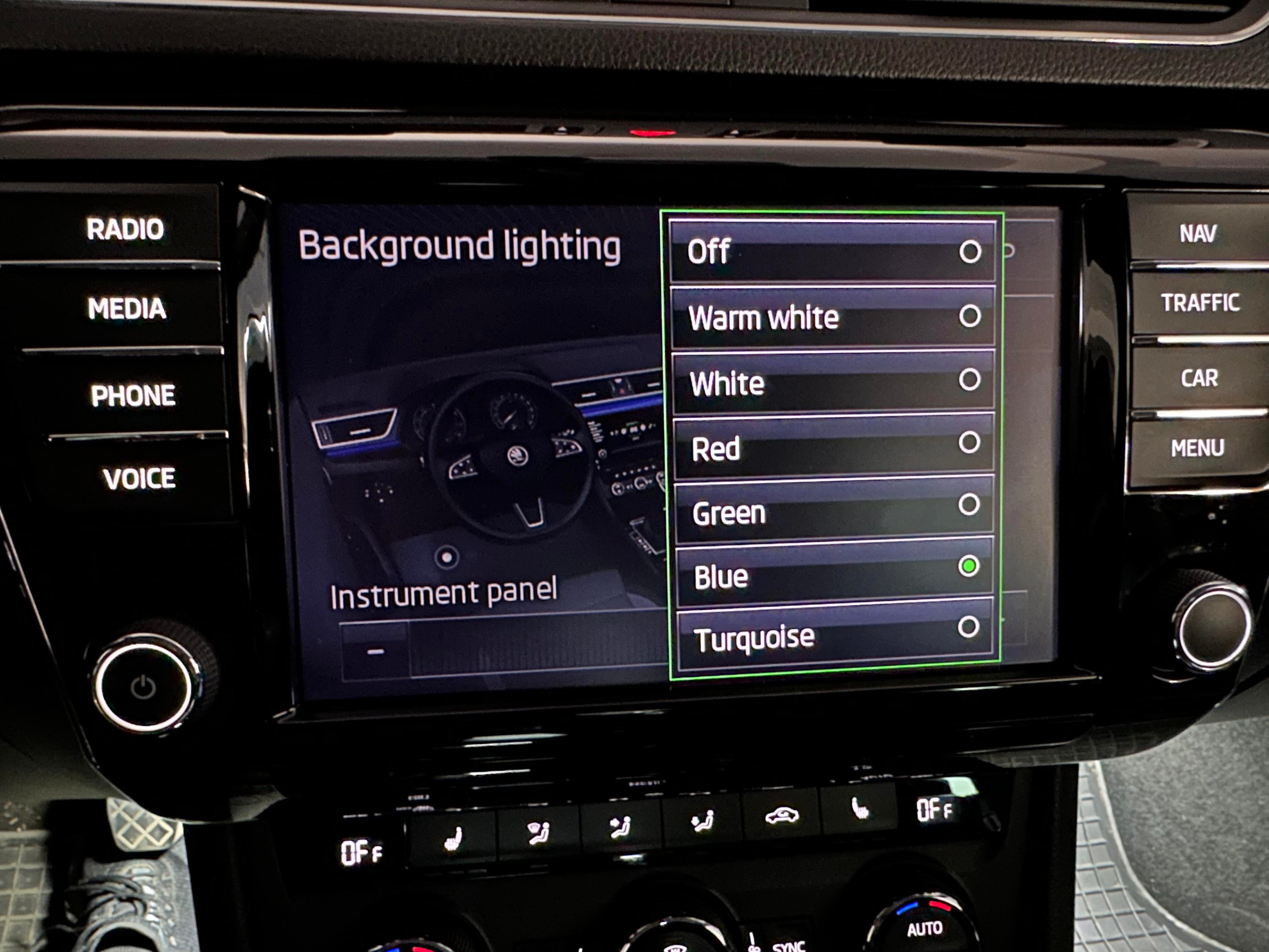

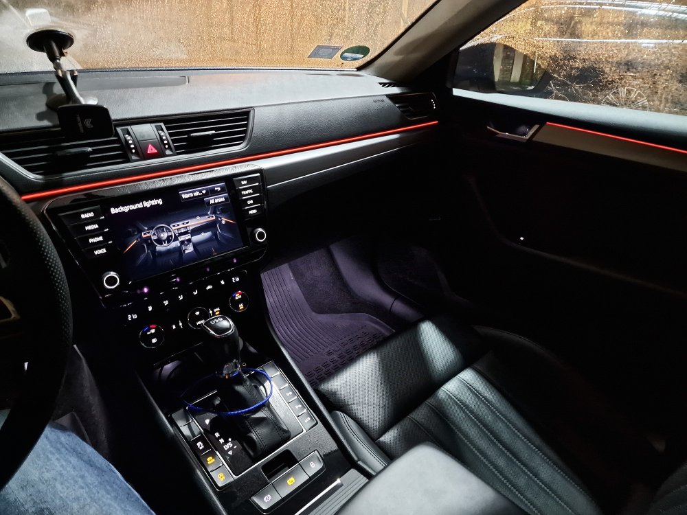

@MartiniB It worked!!🥳
My bad was that I had the IDE09732-ENG115870-Interior light: light configuration-Ambiente_Applikationsleisten_in_Instrumententafel not active and what was turning the color list off was that Ambient_Farbliste_HMI was active.
Thank you so much!!
I'll attach some photos:
Then 3 can be extended to 6?
@MartiniB yes.
IDE11477-ENG128654-Interior lighting: parameter-p_farbauswahl_HMI is responsible for the color number in the dropdown.
I had the value 07 (00000111 - only 3 colors enabled) in my channel and I've changed it to 7F (01111111).
I tried this because I thought that maybe I could add a 7th color.
I think the correct value should be 3F (for 6 colors) but I haven't tried it yet.
I saw that you have the value 19 (00011001) in this channel. You could try with 3F or 7F too and see if it will enable the others.
These are the values that can be entered in there as I know:
00000001 - Warm White
00000010 - White
00000100 - Red
00001000 - Green
00010000 - Blue
00100000 - Turquoise
01000000 - Did not add another color
10000000 - Did not add another color
Use this conversion table as an example: https://kb.iu.edu/d/afdl
Let me know if it works 😁

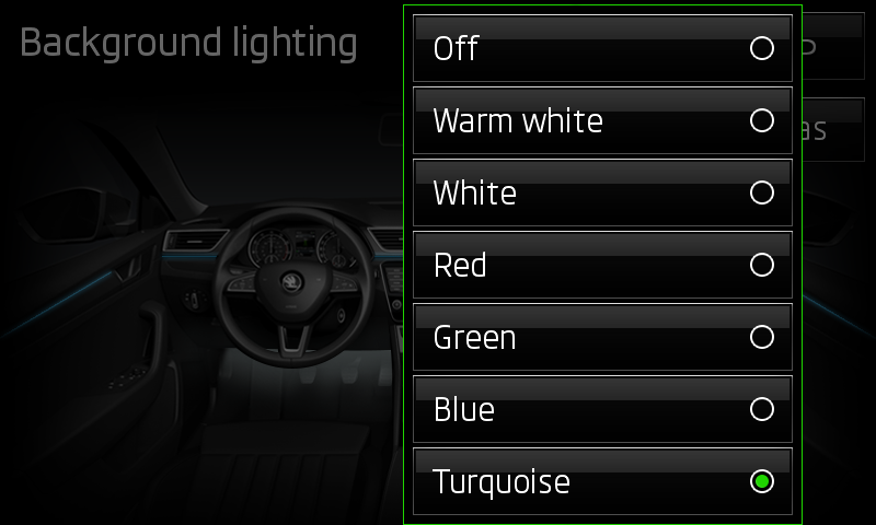

but colors are changed only in head unit screen not on LED strips 😞
That's a bit odd. Maybe there are other things that needs coding in order to apply the new colors.
So if you've had selected Turquoise, what color are the LED strips?
first, Warm white
I saw in your scan that the other colors are by default E1 (Hex = 225)
Try and modifiy the values below by setting another RGB code combination and see if that works.
For example, if you want to set color #4 to Magenta try these values: RGB(255, 0, 252). Use this tool to see what values do you need for other colors. https://www.rgbtohex.net/
As I know, the color name will remain the same in the dropdown list, only the color output will be the one that you will set.
You can give it a try, maybe it will work.
