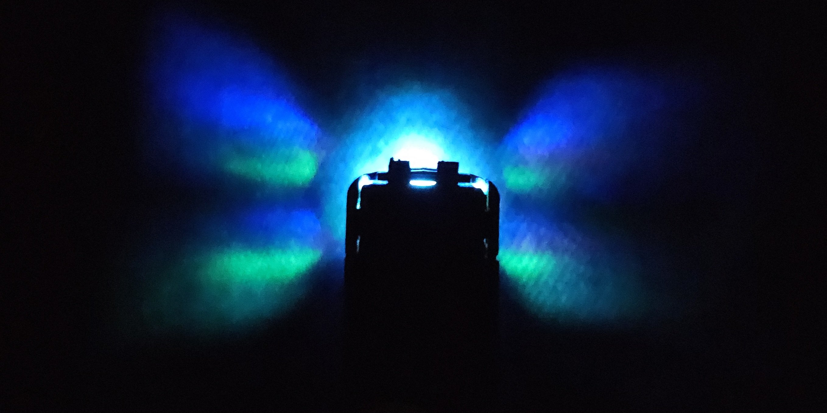

11 minutes ago, Viorel_92 said:
Yes, the Aliexpress LED always stay at the same brightness. All the other RGB leds brightness can be controlled except the aliexpress leds
Imagine the LED like a different module. Until you code the new RGB module, you won't be able to adjust the brightness. It must be assigned to a group. But most important is what OEM module or part it represents. Keep in mind that the module is from China, not OEM, so we are not sure if it's the correct group from LIN slaves.

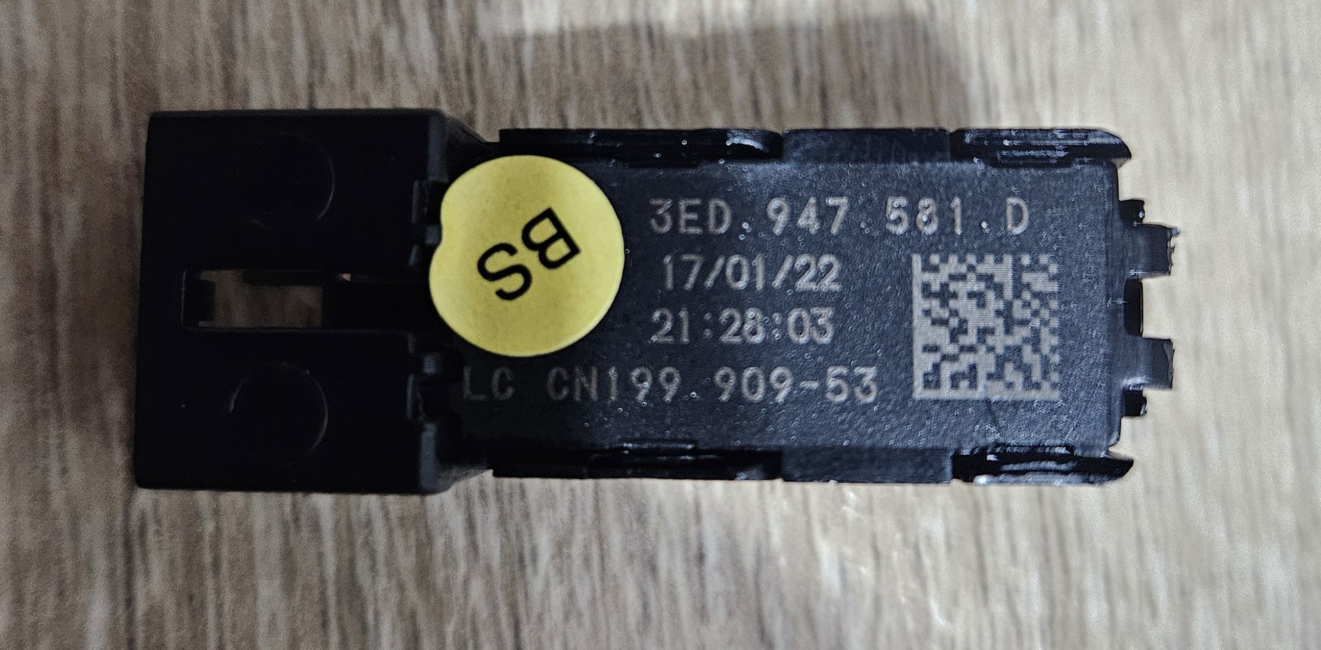

Is there any part number on the RGB module? Do you have a link from the seller or any instructions?

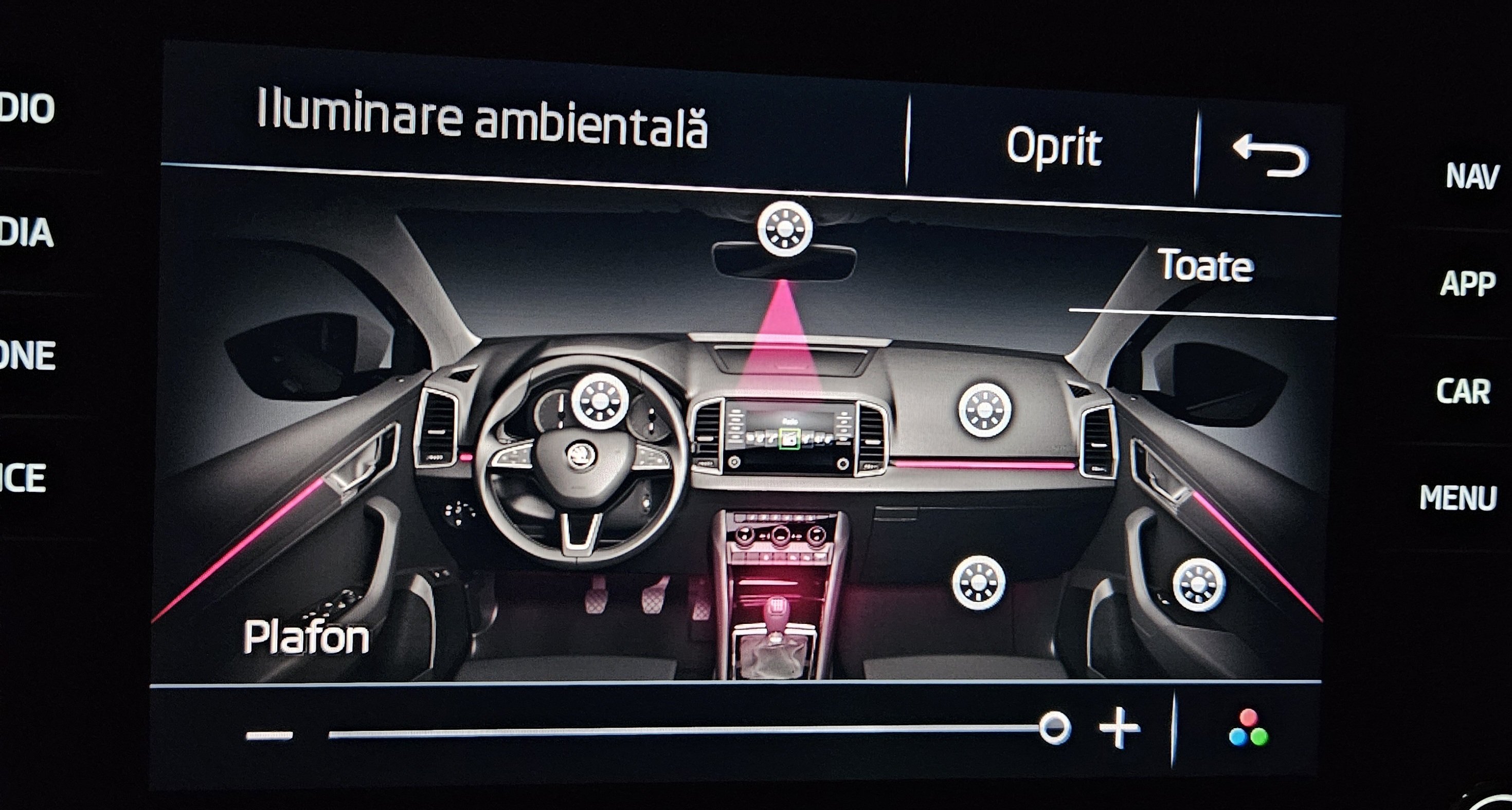

So, I tried as a first step to show the new "sun" on the MIB by setting all the ambienteumfang_mehrfarbig to 11111111 to try to show all of the possible controllable areas, but no extra "suns" were shown on the MIB.
All the changes were done on the 09 controller BCM, and after the coding was done, a reset of the MIB was performed. Do I need to code something of the 5F? Could it be that not adding the new LED to a specific group, the sun not being shown?

Ok, so I continued my research and I think the ambienteumfang_mehrfarbig is used to define if an area is colored or not, it explains the fact that after I set bit 3 in one of the channels, I made the MIB unit to display the footwell light as RGB.
So, now I will focus on ambientelicht_verbauinformation_HMI which it should activate the extra "sun" on my MIB unit.

After some reading over forums and trying different codings, turned out the issue was the fact that even after I did all the changes for the "sun" to be displayed, it won't be displayed until I add the new led to a specific gruppe. Once I did that I was able to see the new "sun" as shown in the picture.
Now, I still can not control the brightness from the new sun(interior mirror), but I can control it from the doors slider and here I have the biggest problem 😂 the china led will display a different colour once is very dimmed(see the pictures below) so I will not be able to use these leds as I was planning to, they are too bright for my taste.
Now that I am thinking, they are supposed to be controlled by the doors slider as the leds are intended for the door handles 😅(just as a side note)

Hello, can i ask you what part number are the Ambient light strips? im looking for some but cant find any for SKODA KODIAQ :(, also what if i buy a symphony ambient kit from aliexpress can i wire it to the OEM ambient kit?
Hello, any aftermarket ambient light that you add to your car will not be controllable from the OEM head unit 😔
Only original ambient light can be controlled from the OEM head unit
okey i see, do thanks. Do you have the ambient strips part number? i cant find them anywhere. i already have ambient in my car but i want to extend it put some more places but cant find the strips

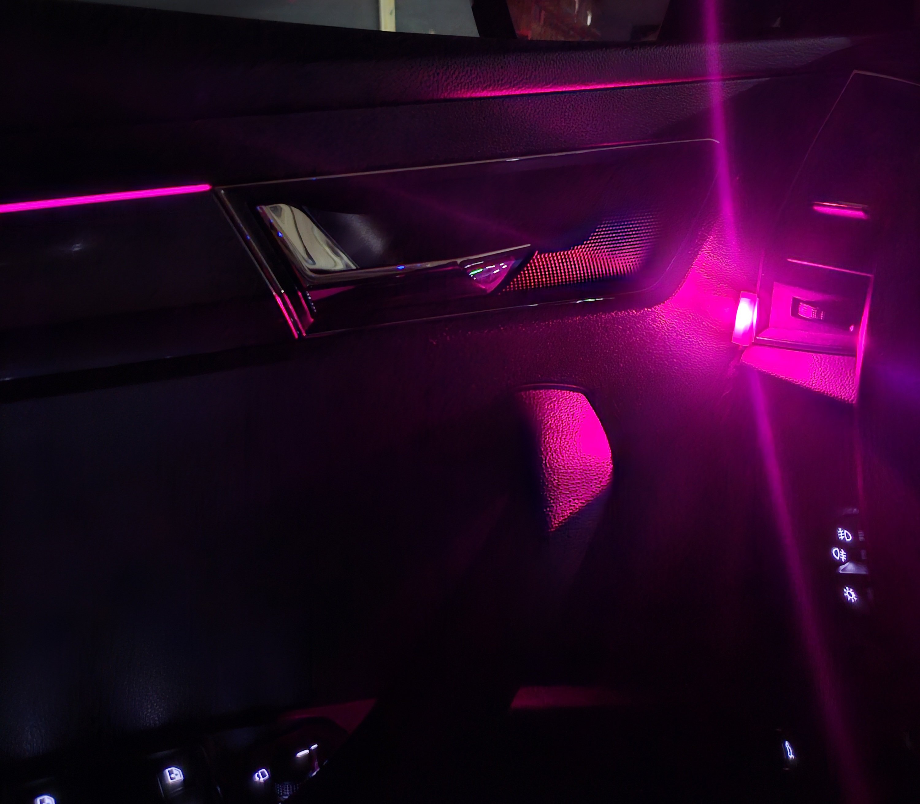

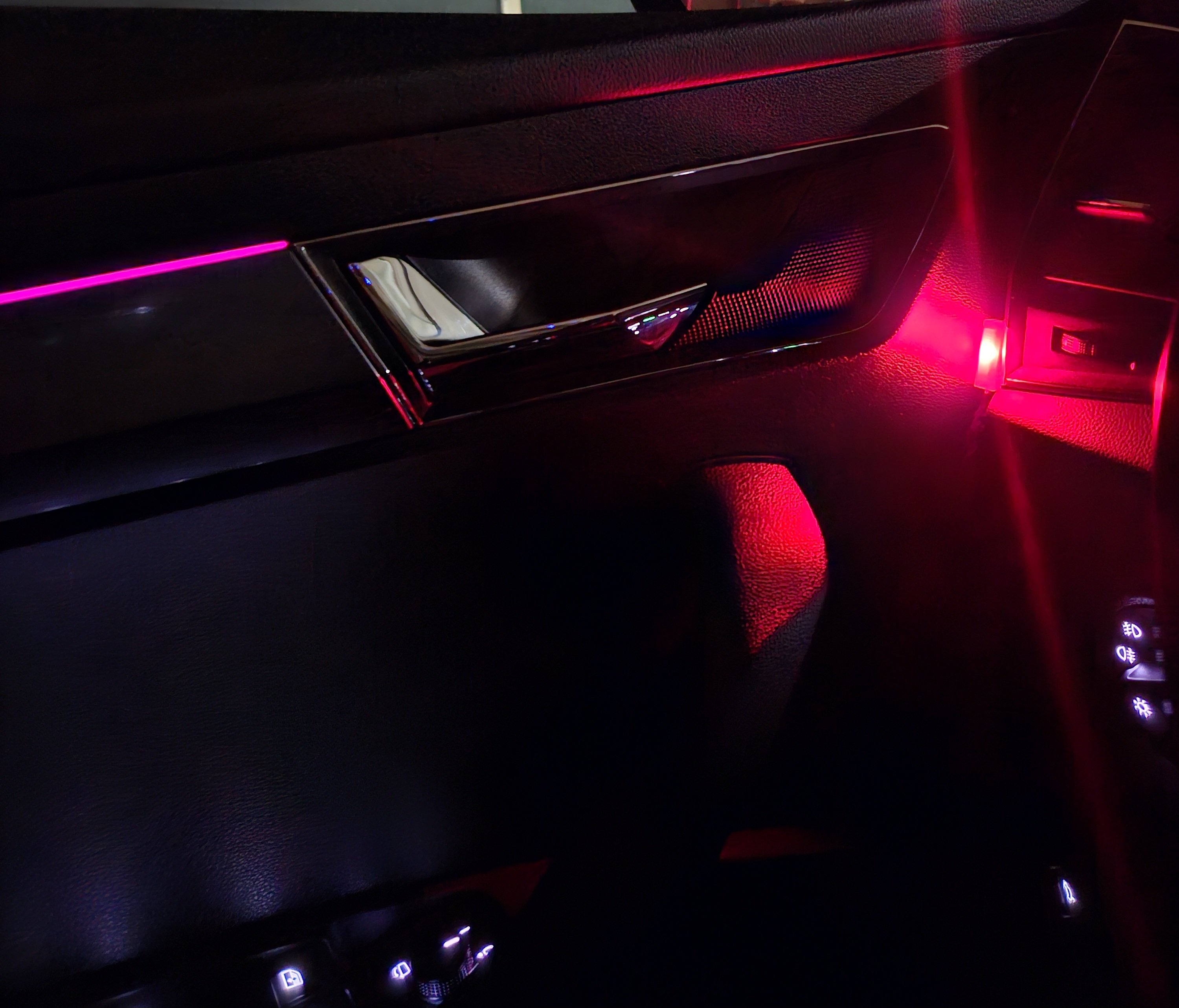

Today, I've received a new rgb led module from aliexpress. This one seems to be oem, the light is dimm and nice even though in some situations I can see the component colors, I think I can solve the issue.
For the moment, I did not make any coding but I am able to control the colors and the intensity.
Now, that the light is so nice and dimm, I am planning to use it for the door handles.
Now, I have(which I will not use) 2 rgb lamps for the door handles, and antoher 2 modules, 2 color(white and red)also for the door handles 😂😂
One question: Is the new "sun" icon only available for configuration once participants are actively connected?
No, the sun is available once I add in vcds a new function to a new group. If I remember corect, all the groups have the doors assigned to them, so once I change group 14 to celling light(or panorma) I was able to see the new sun. I don't have anything(no led) connected as a celling light but the sun is still there. I am unable to control any rgb light using the celling sun because all the leds that I buyed are doors intended(there are specific led codes which goes to the celling)
Strange, i have No New sun
Can you post here you the map file? I will try to have a look and maybe find the issue?!?!
