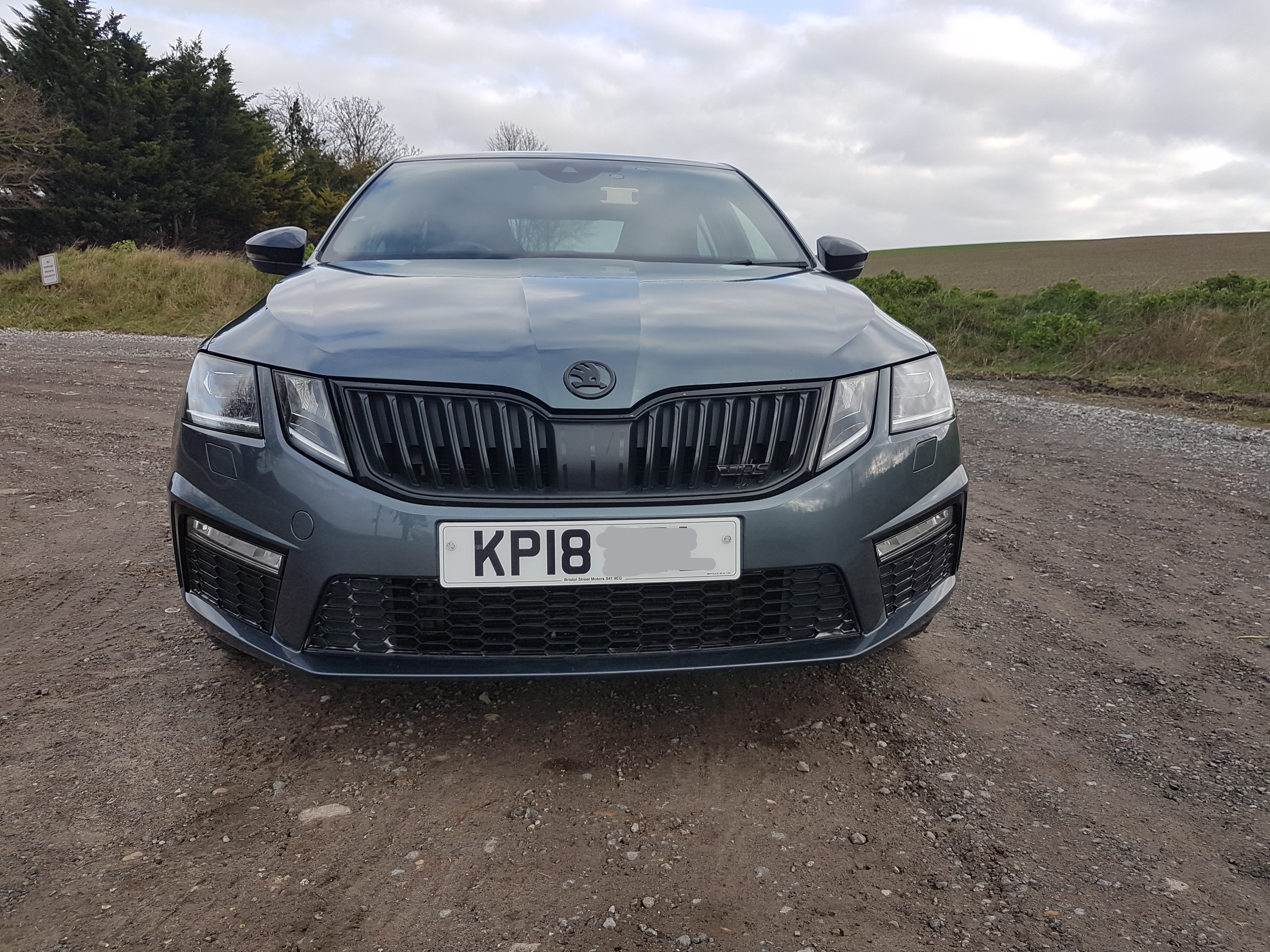

I'm picking up a 2018 grey facelift vRS combi this week and the first thing I'm going to do is swap for the Kopacek black badges. Question is, how do I remove the front one on the grill? I've search and can't seem to find a definitive answer.

You pull hard, no really. I warmed my grill badge up a bit first to soften the glue with a hair dryer, my other halves hairdryer as I have no hair. Lol. Then just got hold of it and pulled. It came off with a crack. Rubbed down the grill with sandpaper where the new badge goes to give the new glued on badge something to grip onto. I also bought all my new badges from Kopacek. 2 new ones at the front and 2 at the back. All chrome badges are now long gone.

You can buy from Kopacek bolt on VRS grill badges, but seeing the bolts holding it on would just not look right. Kopacek actually sent me the bolt on one by mistake, so I had to send it back before they posted out the glued on one I ordered. You use your own glue mind, I used Araldite. Just make sure you get it straight before the glue goes off. Welcome to this site by the way, as I see it's your first post.

I heated it up, used some fishing line like you would on the other badges and just went around it (you can’t go through as the pins are there) & then just pulled till it moved off without much resistance.
