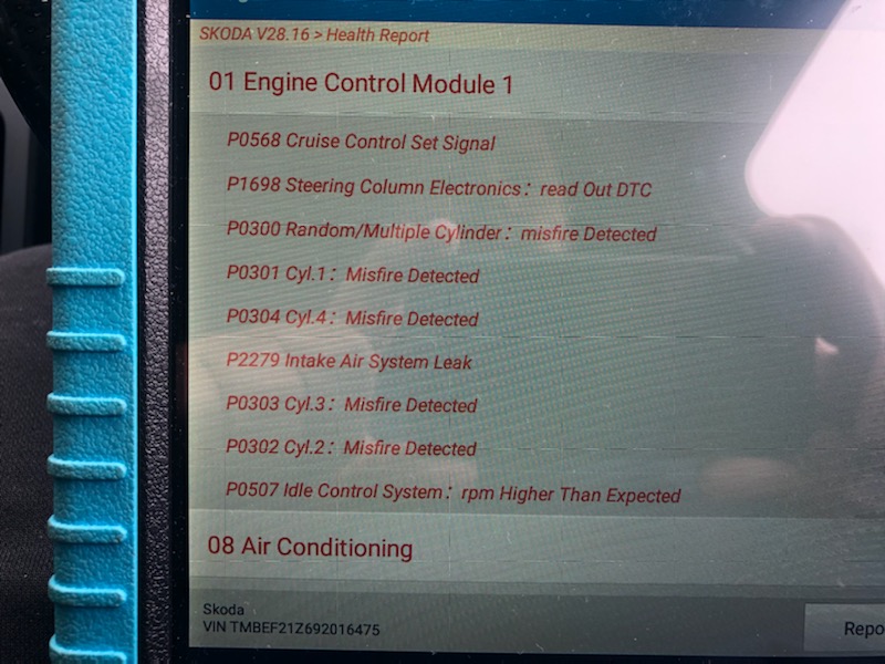

Hi all I’ve changed my pcv valve yesterday and then started the car and now I have a misfire on 3 of the cylinders and changed the working coil around and it shows up the other 3 still my question is I never had a misfire before I changed the valve so why now ? Or is that just bad luck ?

So just as an update I’ve now replaced the coils and also done the plugs and I’ve still got the same issues however I’ve now also ordered a new pvc valve with both the pipes and will see if it was just a dodgy pvc valve I had
Any DTC codes>?
A genuine fine oil separator / PCV from VAG?
I got a million codes all saying misfire on all cylinders and also saying I have an air leak system it was an eBay pvc but Ive now ordered from main dealer to see if it was a doggy pvc valve to be fair
So just an update replaced the PVC valve for another genuine 1 and the car is now running perfect again ! So guessing it was just that but least the plugs and coils been changed tho I guess
Maybe not I’ve got a code of po171 !!!
Could it be the maf sensor ?
Don't think so. It is likely vacuum related isn't it?  Check the tabs and pipework to the PCV you've replaced. Some clips tend to break and could leave a vac leak. Otherwise check other vacuum lines.  pattern PCVs on these engines are almost  always worthless  (I don't think I've ever seen a post of someone successfully using one_ and create no end of problems!
