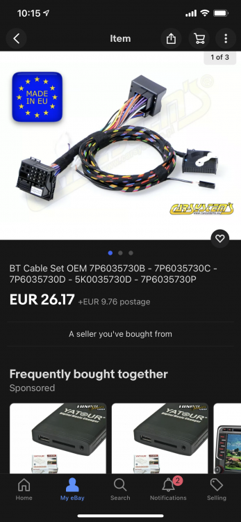

I’ve done it.

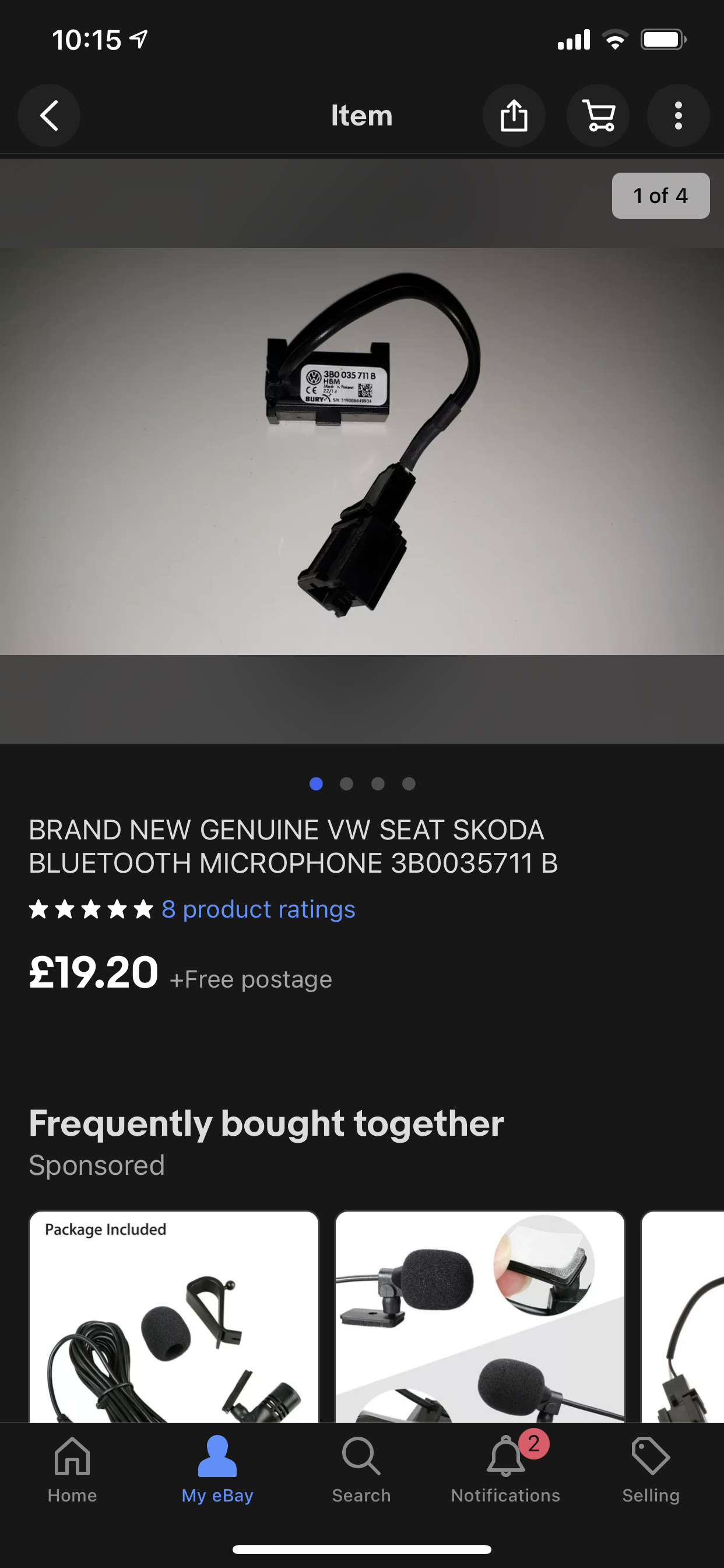

you need this loom, this microphone and a module.
the one I used was 5k0 035 730 B.
that gives you Audio and calls!
also it needs to be coded in.

have you got a link/ pic to the microphone you used?

I coded it myself with car scanner. Used a carista obd2 adapter. The hardest part was finding space for everything.
the medial is behind the climatronic panel.
the microphone is in the headlining.
the hardest part was finding space behind the stereo for the quad lock connector. This is the microphone I used.
