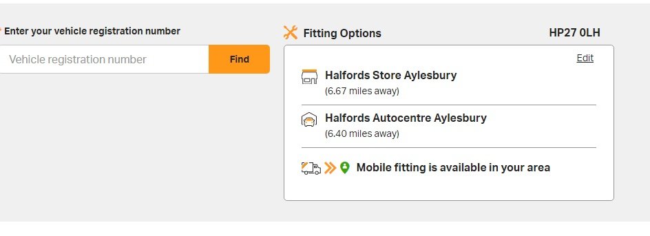

Further to Graham's comment earlier, I have always used Halford's batteries (though fitted myself) and have been happy with them, they have all lasted many years.
I don't know exactly where you are located, but I notice that Halfords do offer a Mobile fitting service in the Chilterns area. Might be worth a call to them?
