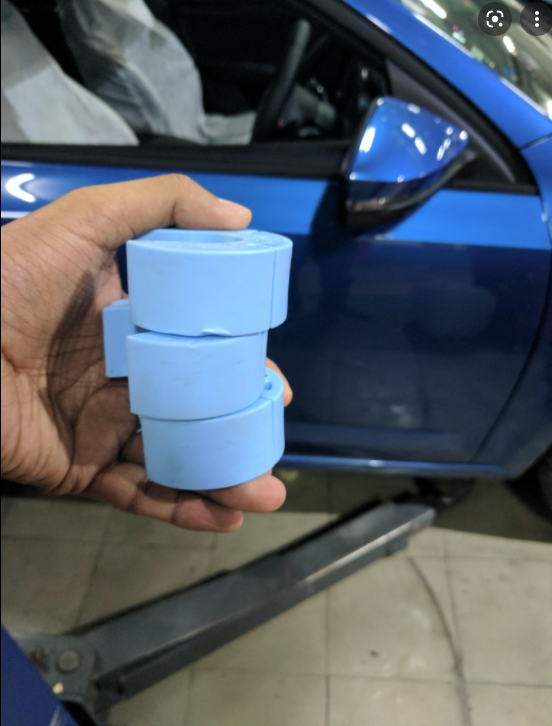

Could be your car still has transportation blocks installed. A few owners reported this problem in the past. This can happen when car isn't properly prepared before handover.
You can check your suspension by yourself. If this is  true, you will see some sort of plastic blocks inside the springs.
I had a similar thing and the blue blocks had not been removed during PDI. When I hit a rather large pothole one was broken and the noise got worse! You'll find them under the rubber gaiter.
After they were removed I thought the car was smoother and felt more hooked-up. Maybe just in my head but worth checking anyway

Thanks guys for your replies. I took a look under the arches and found the above blue blocks forcing their way through the rubber gaiters. They have torn the outer gaiter to shreds. Took my car back to Skoda, with a handful of blue blocks I had managed to ease out of the coil spring. The service manager looked shocked and informed me that they wouldnt have left them in, lol. I told him that I certainly didn't put them there. They took the car in immediately and removed the remaining blocks and also booked the car in to replace the rubber gaiters. I can't believe the difference in how it drives now.
Glad you got it resolved, but was your dealer really implying that you might have put them there yourself?!
