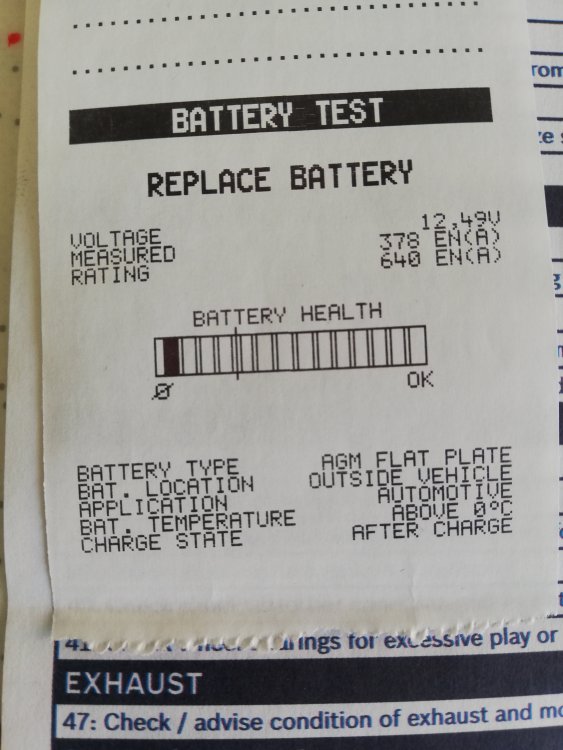

They tested it and provided the attached. I've no idea what it means tbh so happy to be advised, the car has auto stop/start.

Provided the garage hasn't pulled a fast one with the readings, that's a matter of trust, that paper slip battery health bar says it all (subject to the battery having been charged correctly and test applied correctly and tester accuracy - all a matter of trust here too).
Depends how deep you want the explanation to (not that I'm an expert) but if you look at the rating figure of 640 EN (A), this is the battery was stated as 640 CCA (cold cranking amps) new, that's its muscle power to turn the engine over from 'cold'.  Through wear, tear and age, just like most of use, the battery loses some of that muscle power.
The ticket shows the battery now at 378 (59% of its original stated power) which is too low for what the battery may reasonably be expected to cope with in use and be reliable.  It would still possibly be good on a smaller demand but also the ticket shows that after recharging (hopefully fully recharged) the battery now has 12.49v where as a fully recharged battery (keeping it simple) is 12.7v or 12.8v so this battery is always under before it even starts to get used.
Your start/stop car and its very invasive computer programs would not have been happy with your old battery as the longer nights and colder weather and heavier demands on the battery increase during winter.
You have avoided becoming part of the statistic of the number one cause of breakdown call outs (with AA at least), they call battery faults but are really mostly driver/owner faults. -https://www.theaa.com/breakdown-cover/advice/top-ten-breakdown-causes
