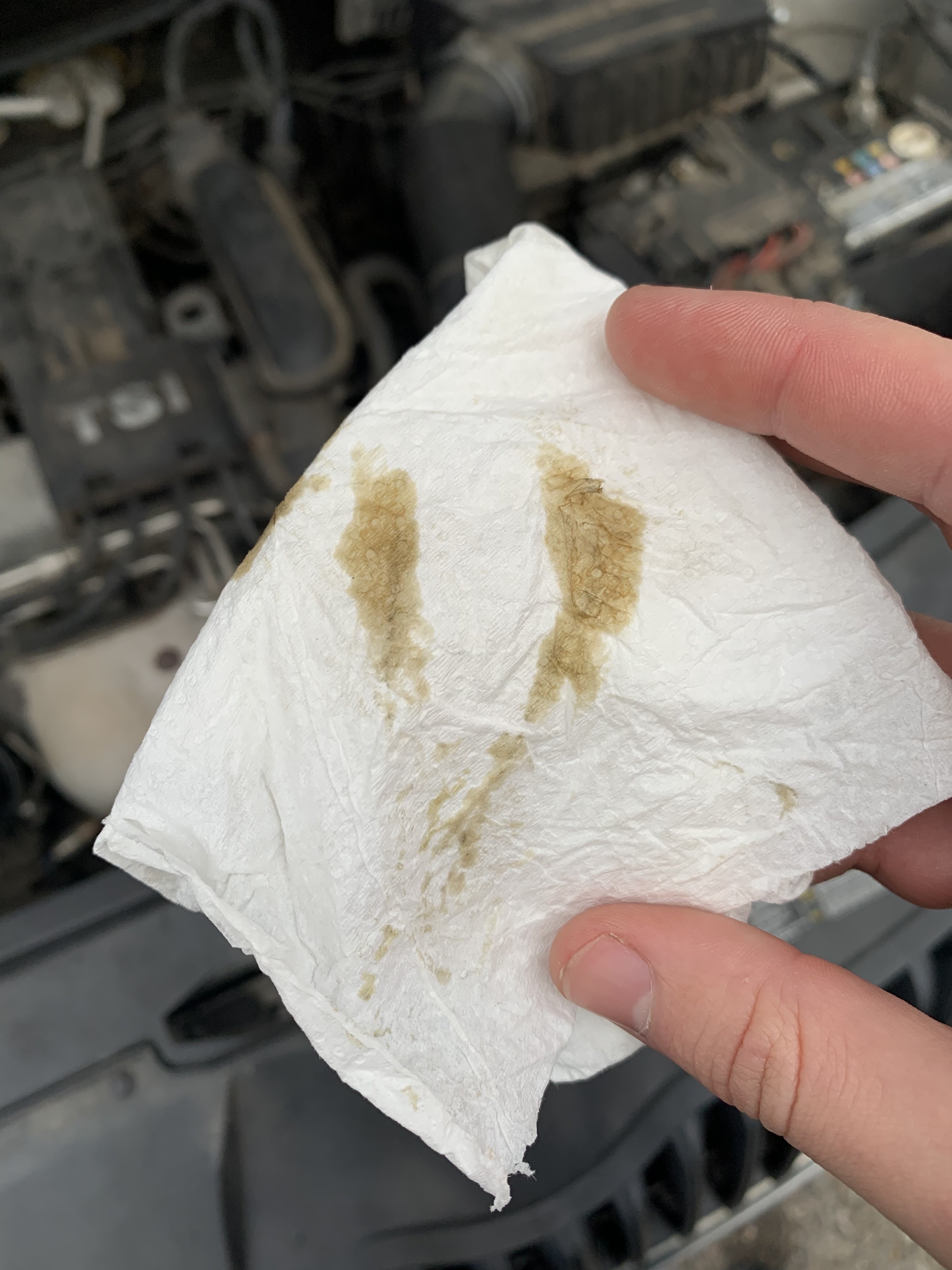

Not sure if I posted this but this is what the oil looks like at the moment
Fascinating, confirming the appearance of clean car engine oil on white tissue paper.
If you've just blown your nose then see a doctor, if you've just wiped the dipstick then please close the bonnet and drive the car some more before checking the level again.

To me in that photo the oil does look  to have dirt unless it's my eyes or the photo there appears to be smeared lines of black.  The colour of the oil itself can only be compared with the same oil fresh out of the can on that tissue.  How clean or not was the dipstick  before you wiped it on the tissue?
If previously the servicing (and that not just engine oil changes) wasn't done in a timely manner then after 9 years muck will build up, hence my consideration of perhaps using cleaning flushes on an engine you don't the know the history of (unless the engine has such high mileage you worry that it's only the muck preventing it leaking more).
In the background your engine doesn't look bad but it's certainly not, for a while at least, been kept by a concours fanatic.

On blowing the photo up it does look more like a dirty dipstick (you dirty devil).
Keep the photo and compare it to a photo of the same in a month's time.
If you'd put clean oil on that tissue and it was much, much lighter then that might have shown there was muck for the oil to catch so was doing it's job.  Unless the oil looks really dirty on subsequent oil level checks I'd not worry but I'd change the oil and filter 6 months from when you last did it - plus it puts the servicing at a time of better weather.

I'm used to a diesel engine oil making a white tissue pure black 🤣 this is pristine to me lol. Is it that bad??
(forgot the blow up)
You're right. And I had been using that tissue to wipe my hands before too 🤣 will check again

Yeah well you're too used to the absolute filth of a dirty diesel and there's possibly not only cross contamination from the dipstick or engine but also your hands, I think the Met would be looking to employ you for some of their cases.
