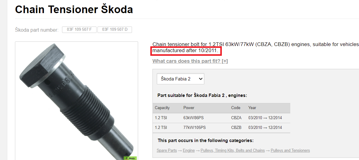

@xman how big a job is tensioner swap on these, please?
I haven't done one myself, Skoda dealer did mine. But from what I gather its simply unscrew and fit new, it round the back of the block so access may be a little difficult.
Not sure what procedure or precautions needed if fitting a new tensioner to a worn chain setup (initial start up)
Also need to check if the new tensioner design is compatible with the chain kit currently in place as normally all parts are changed, there are two types and probably not interchangeable (different guides)
Revised style https://www.skoda-parts.com/spare-part/03f109507f-chain-tensioner-16935.html
Original style https://www.skoda-parts.com/spare-part/03f109507b-chain-tensioner-20404.html
Some more info here
http://replace-timing-belt.com/how-to-replace-timing-chain-on-audi-a3-1-2-tfsi-2009-2012/

Thanks for the info xman, looks very easy to fit compared to the whole timing case removal that the HTP requires!
Suffix D or F by the looks of it, from previous discussion of engine build date on page 3
It's literally a bolt sticking out the engine block. I don't think you'd need to do anything apart from unscrew it and put the new one in. Literally 90 second job. I could be wrong
Some more info here
If it's that simple fair enough but still £30 and you want a good quality replacement part otherwise you could be taking out a functioning part to replace it with one that might not be so well made and cause more problems now or later and/or early replacement of itself.  I've no idea about these parts but I can assure you so modern made parts can go from poor to ****-poor, crap and abysmal.
