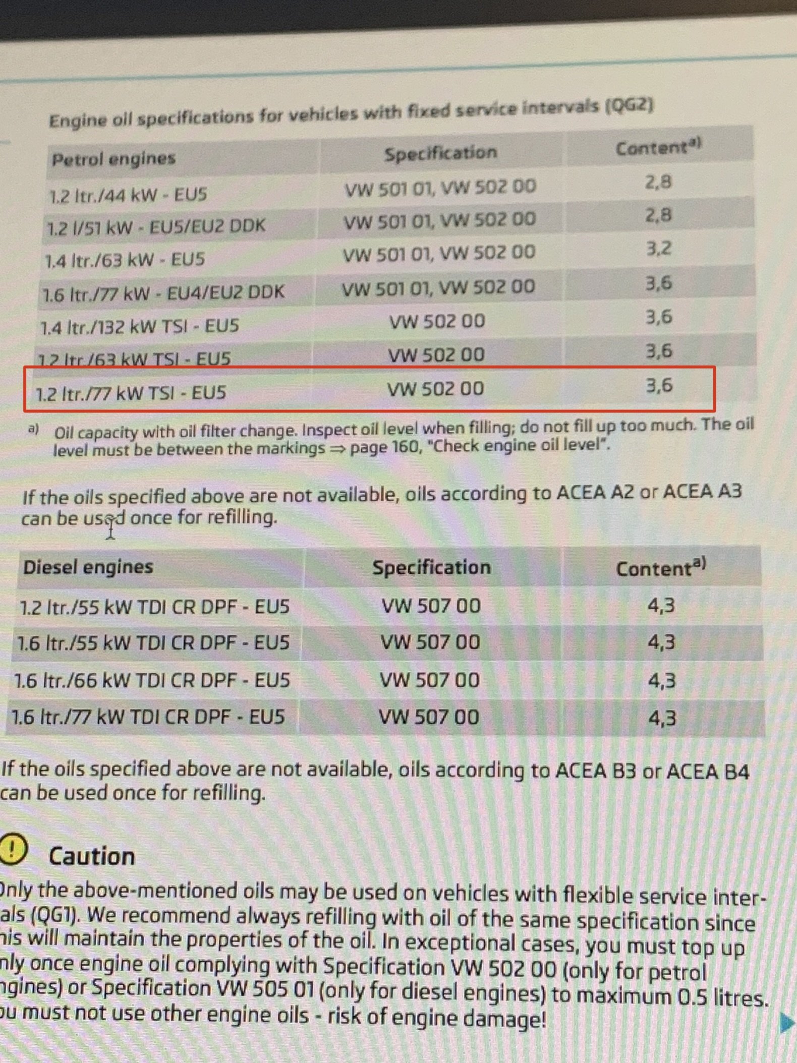

This It where it gets interesting... The book says this engine takes 3.5L.
I put in 3L të begin with (obviously there's still a bit of oil in the engine etc).
Took it to e petrol station forecourt so I knew it was on a flat surface. Let it sit for 5 minutes. Checked dipstick....oil is only at the minimum level? How does that work?
There might be about a teaspoonful of oil left in the engine after draining, but you should put in the full 3.5 litres recommended.
Ah! Thank you so much, I best do that 😬😬
This doesn't sound right.
 A quick cold oil drain will leave more old oil and muck in than a warm/hot oil drain left for a long time but there's always some left in so starting at 3 out of  3.5 should have it well up the stick (perhaps even overfull on a sloppy change).  Are you sure the fill capacity including the filter is 3.5l?
ETA: Only ever fill to the Max don't put in 3.5l if it requires less, better to underfill (above Min) and top up as required than overfill.
I made sure the engine was up to temp before letting it sit for 5mins and then draining it.
The book certainly seems to say so down here....

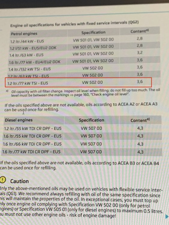

Just seen this in the 2012/5 Owner's Manual.
ETA: cross posting - is yours a 77Kw (at 3.6l)?
Edited by nta16
Ah learned something new there! Thank you for that! and yes 77KW
Edited by Meridion
