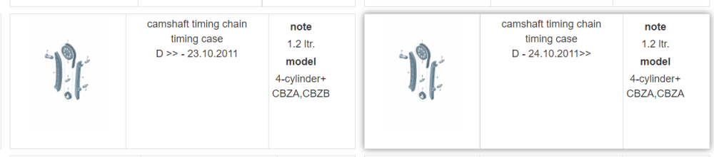

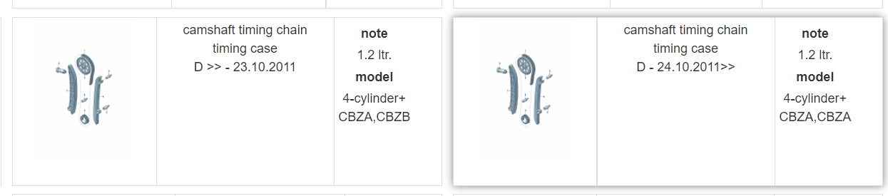

Ah, fair enough, I missed that.
It looks to me like the chain mechanicals changed on/between 23/24th October 2011 so yours should comfortably be in the later category with updated chain/sprockets etc.
Screenshot source: engine Fabia (FAB) [EUROPA 2012 year] (7zap.com)

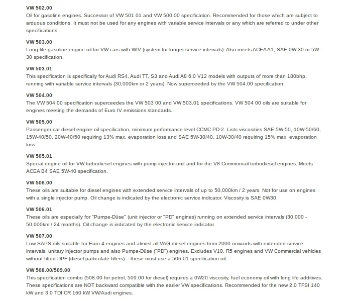

Wino, do you know if there was a change to recommended oil weight as well as the change to capacity?
  • Sponsor
No idea, but I doubt it.
VW group don't really go by oil 'weights' as such, they just have their own categories - 502 00, 504 00 etc. within each of which a (small) range of different conventional viscosity ratings can feature.

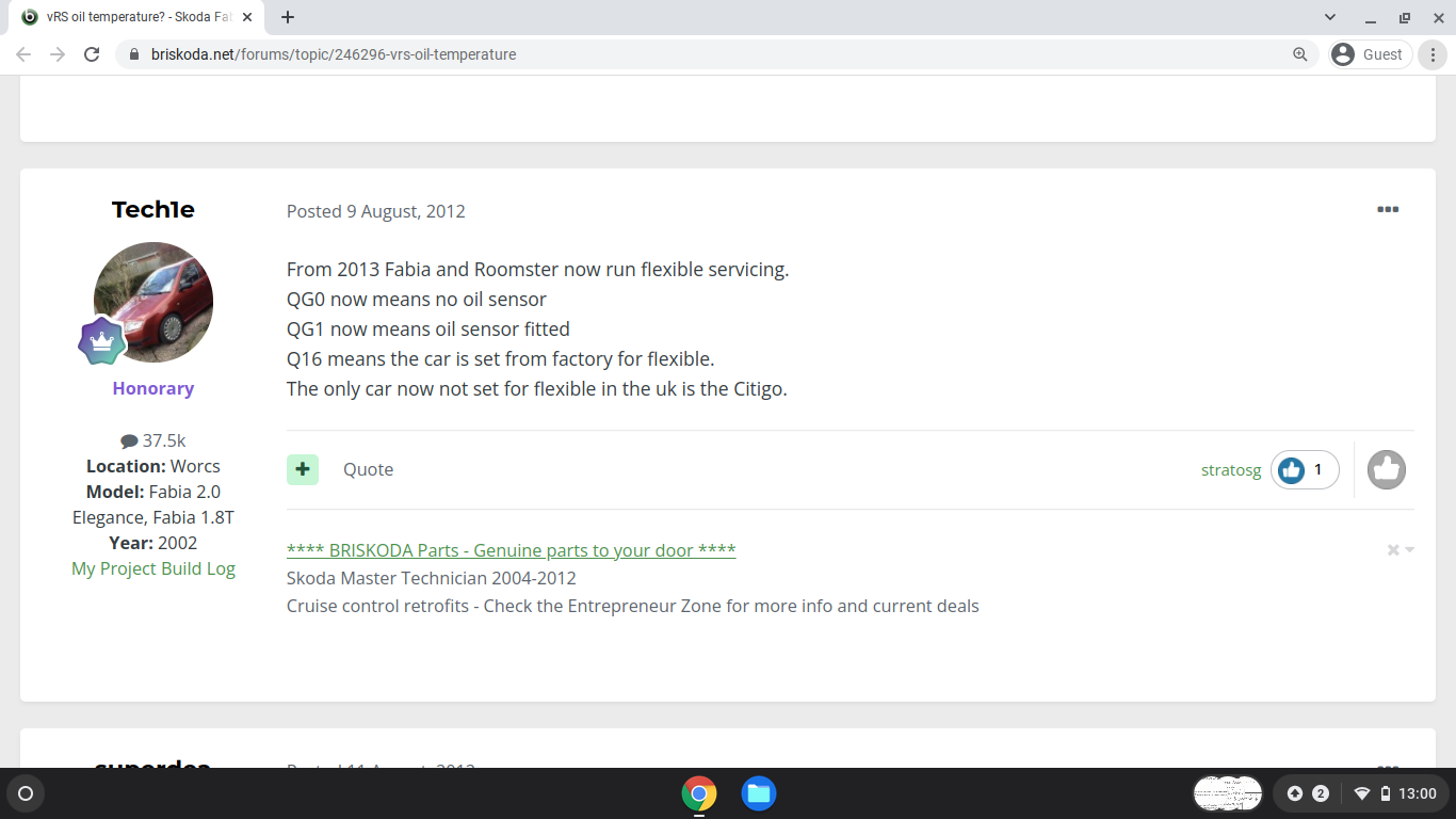

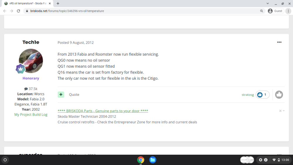

There was a change with some  Mk2 Fabia engines that had a Service code for Fixed Services only and then were changed to suitable for Variable / flexible.  The same engines in Polo, Ibiza and A1 were already showing the Code for Variable servicing 2 years before the MK2,s but the models were out before the MK2.  They showed VW 502 00 for fixed and VW504 00 for fixed or variable with petrols    There was a change of Oil filters with 1.2 TSI,s  and some here got the wrong filters even when the cars were serviced at Main Dealerships.  There was the change of oil capacity from 3.6 liters to 3.9 and again that was overlooked at dealerships and some had 3.6 litres on their invoice / bills.
Edited by roottoot
Here.    http://briskoda.net/forums/topic/257110-correct-service-interval-and-oil-grade-for-fabia-ii-to-be-pinned
Engine codes.
Posted Feb 2012.
http://briskoda.net/forums/topic/228245-engine-code
(http://briskoda.net/forums/topic/246296-vrs-oil-temperature)
PITA for some when they changed Variable / flexible to Fixed.
PITA when car in at the Dealerships that changed Fixed to Variable on cars that were set for Fixed and drivers wanted that.

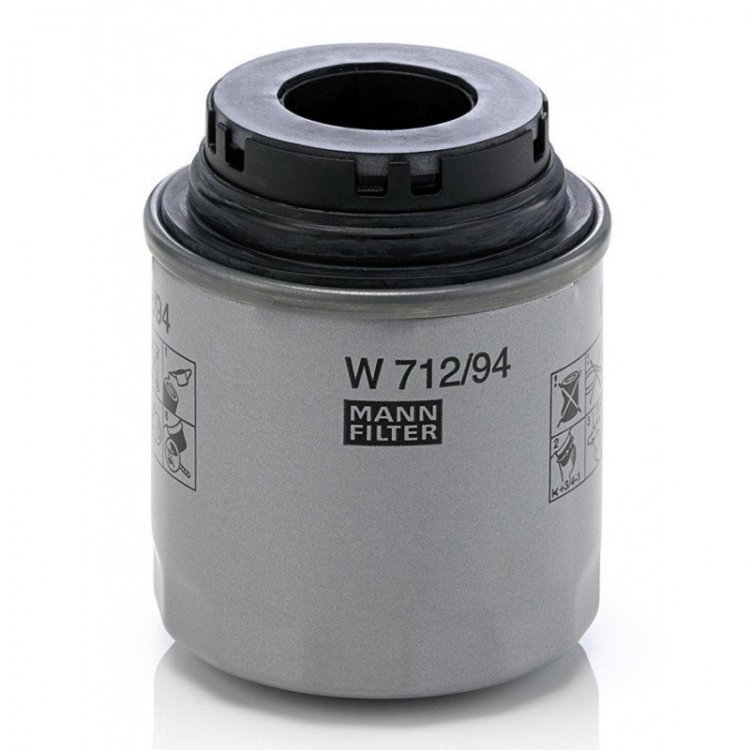

It's also possible to overtighten the oil filter on an EA111 engine damaging the non return and drain back valves which can cause oil pressure issues. As Wino & Xman mentioned it's also easy to leave behind a previous sealing ring as well - which also causes havoc. Either problem could affect the pressurization of the cam chain tensioner and cause potential engine damage.
Edited by bigjohn
Thanks John! I did check for the left behind seal, and I got a cup wrench for the oil filter so I could tighten it with a torque wrench to spec. If I have still messed it up then I deserve the damage haha 😅

Some misleading information about the oil filter, there is no non-return valve (thats in the oil pump), and the servicing drain down arrangement is a combination of the sprung wide O washer closing off the drain orifice in the oil housing, the smiley mouth in the pic below ..IMG_20180527_174421.jpg
There is a bypass valve built in the filter as most canister filters have, that opens to prevent loss of pressure when the filter is blocked but not relevant in this discussion.
I strongly advise against the use of the cup socket for tightening the filter as its really easy to overtighten which you will regret when it comes to removal when the O washer has swollen making it difficult to remove. Hand tight is fine.
I presume you have the correct filter, if you give us the exact part no you use I will check it is the later style.
