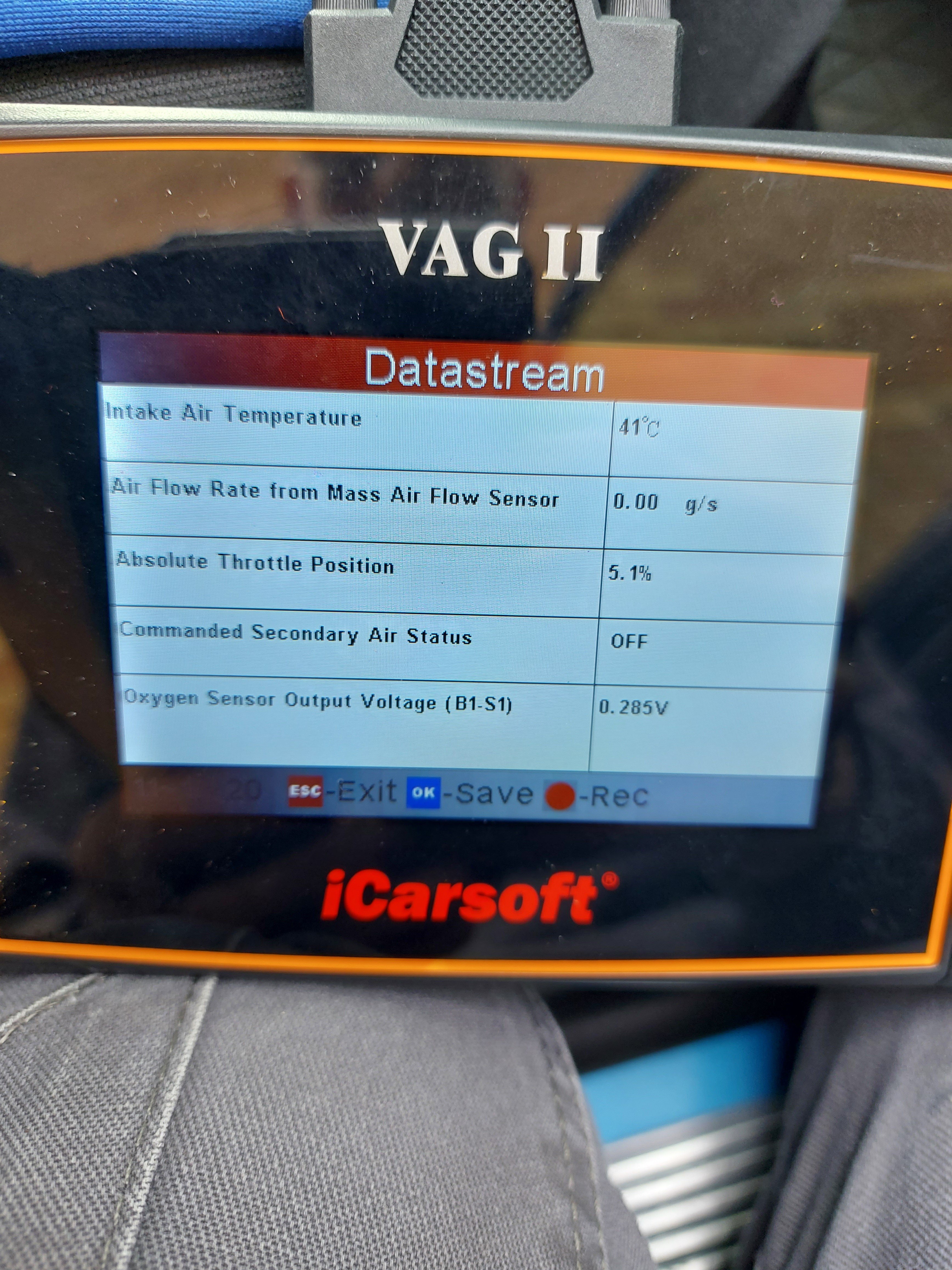

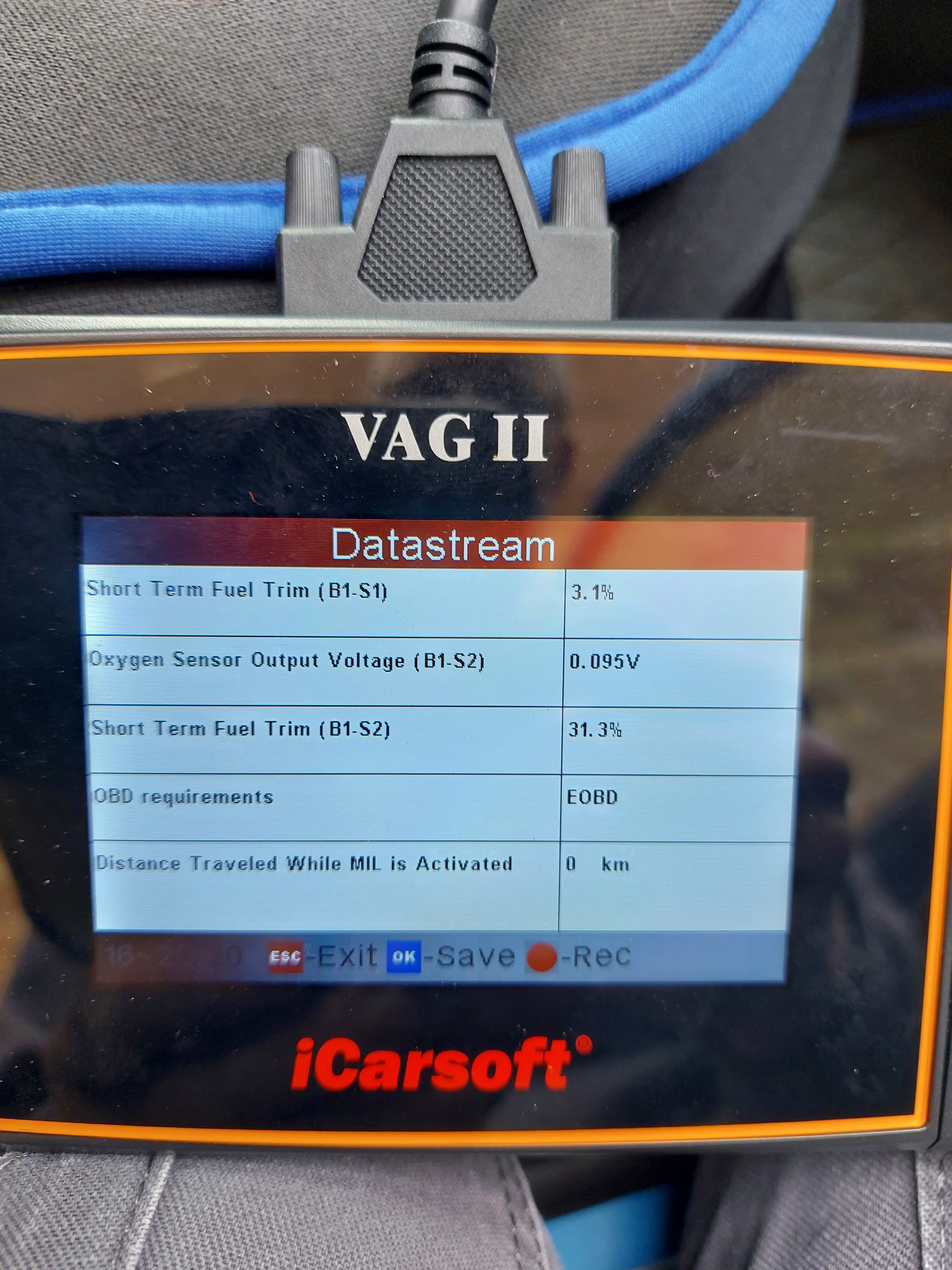

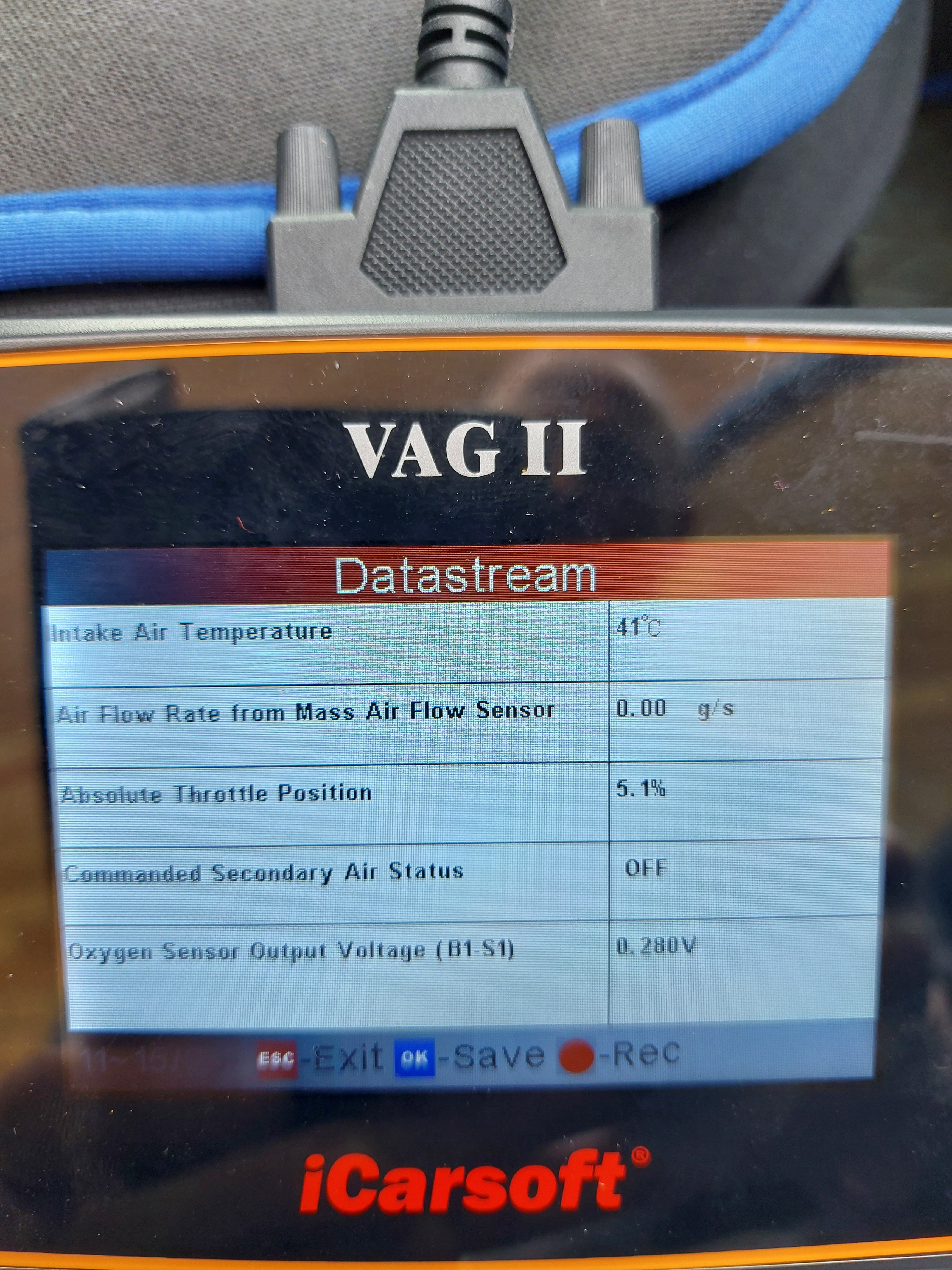

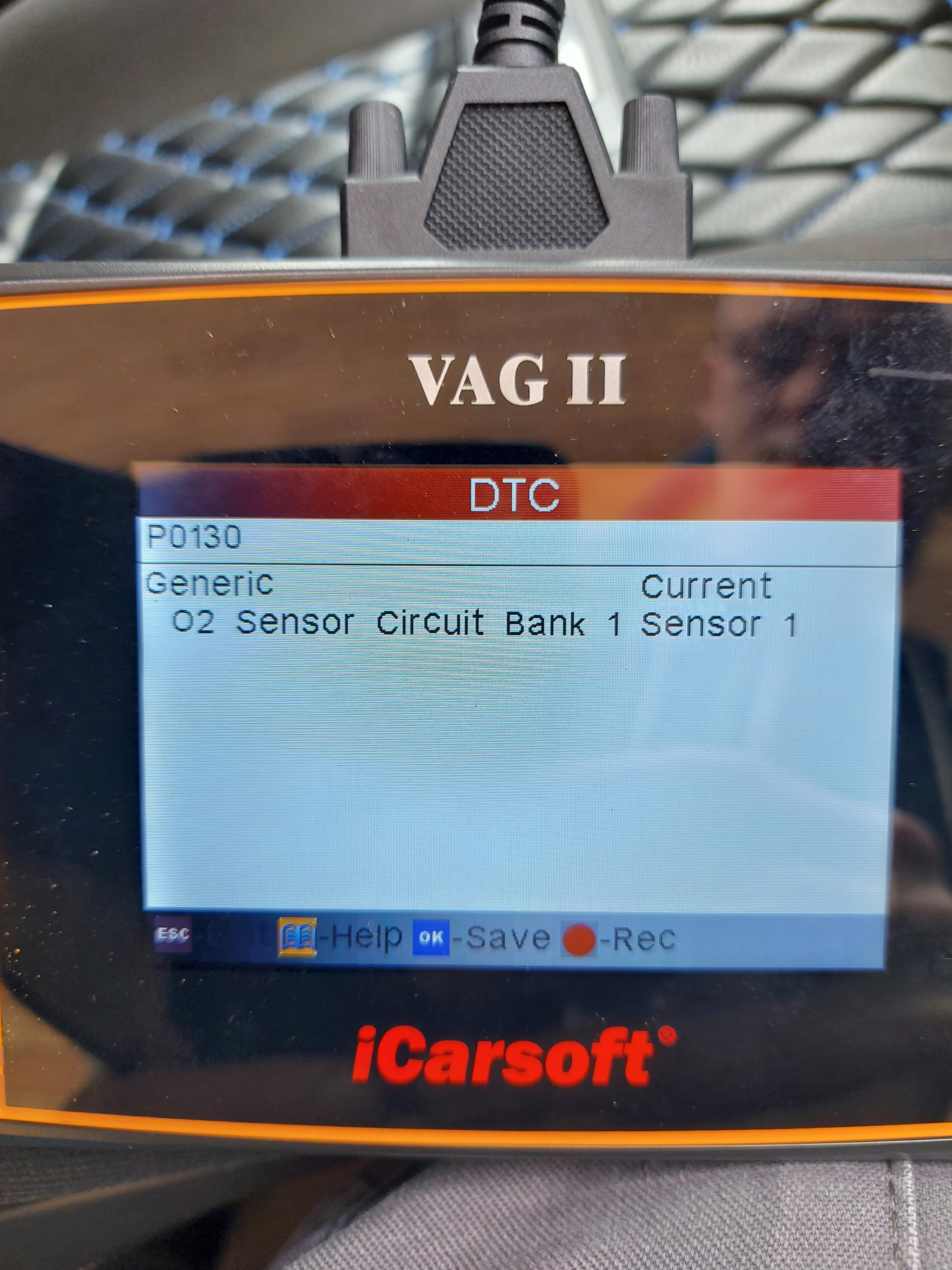

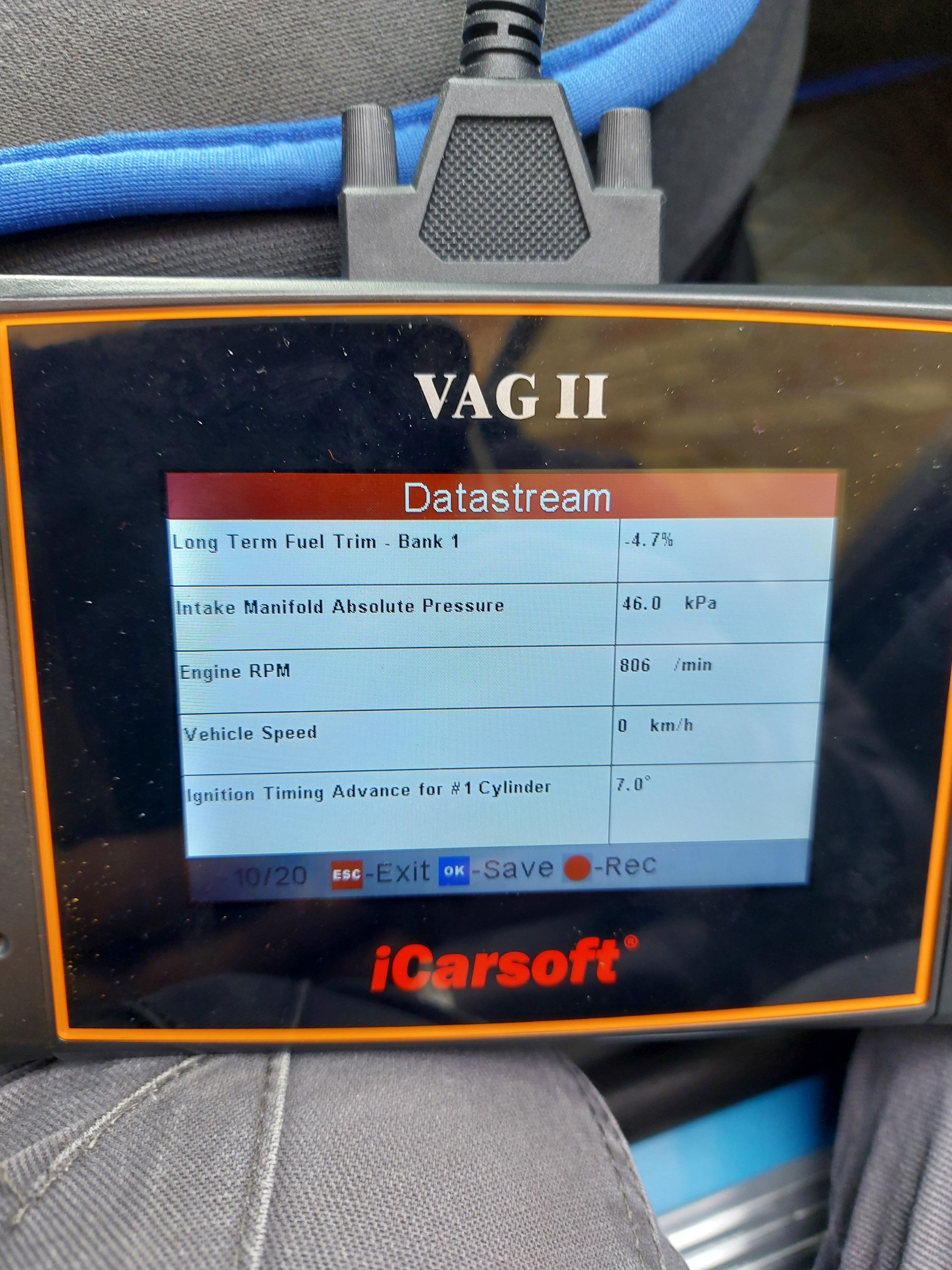

Well the fault code is back and even though it seems to be running okay fuel economy is well down ive done a scan and will now post screen shots see if any of you technical guys can see anything :)
I suggest it's the lambda probe, probably the heating element gone open circuit.
Unless it's been replaced recently or there's a wiring fault you should swap it out.
Its been a couple of years maybe a bit longer now I think of it so will take your advice ans swap it out.
I just did a quick 10 mile run down the motorway and its deffo low on fuel economy usually I get 48 to 50 on motorway it was like 40 tops all the way and only near the end did it start creeping back up.
if you bought poor quality (regardless of price) then not only short life but also very expensive, cheap parts (regardless of their retail price) can work out very expensive as the short term fuel trim figures might suggest.
The two sensors have different figures but I've no idea if that position or range, the deeper scan tools I think give acceptable range figures(?).
I'm not sure if VW use the best sensor or not, if not Japanese products are often better than 'quality German engineering'.
Edited by nta16
What sort of figures should I be looking at obtaining on the short term fuel trims ???
Never take a raw code as the solution.
"The O2 sensor produces a voltage based on oxygen content in the exhaust.  The voltage varies between .1 and .9 Volts, .1 indicating lean and .9 indicating rich."
"Usually the cause of P0130 is a bad oxygen sensor, however this isn't always the case.  If your o2 sensors haven't been replaced and they are old, it's a good bet that the sensor is the problem.  But, It could be caused by any of the following:
  • Water or corrosion in the connector
  • Loose terminals in the connector
  • Wiring burnt on exhaust components
  • Open or short in the wiring due to rubbing on engine components
  • Holes in exhaust allowing unmetered oxygen into exhaust system
  • Unmetered vacuum leak at the engine Bad o2 sensor Bad PCM."
Read more at: https://www.obd-codes.com/p0130
Copyright OBD-Codes.com
"Assuming that the engine is in excellent mechanical condition, and that all sensors implicated in metering both intake air and fuel, short-term fuel trim values should generally be between positive 10%, and negative 10% when the engine is running at a steady speed. Note though that since sudden changes in the engine speed can cause short-term fuel trim values to fluctuate wildly, all fuel trim values should be taken at a minimum of at least three steady engine speeds, these being at idle, at about 2500 RPM, and at about 3500 RPM. Note also that fuel trim values should only be taken when the engine had been running at the above speeds for at least 30 seconds." - https://www.mechanic.com.au/news/understanding-short-term-and-long-term-fuel-trims1

The ECU is adding fuel because it thinks the mixture is lean, this means the probe is sooted up, this could be because the heating element is kaput, either way the probe is delicate and difficult to clean.
I generally use NGK or Denso probes because they're better value.
Bit I meant to copy and paste - do check the sensor is fitted fully and correctly, check that it's clean.  Also check you have no air leaks, hoses cracked or not fully fitted off, that other sensors are clean.
What are the other readings for the engine (relating to plugs/injectors/coils/etc..
It could think it's lean for other reasons - but checking and cleaning the sensor and other sensors is a very low cost first step rather than replacing then reset what can be with scan tool and test again, but just taking one reading at one point each time might not give the full picture.
I'd check and clean (as required perhaps) all sensors before and after, cleaner in then better running and cleaner out hence timely servicing and replacement of things like filters.  Much service, maintenance and repairs can often boil down to clean (and lubricate, changing oils helps both).
