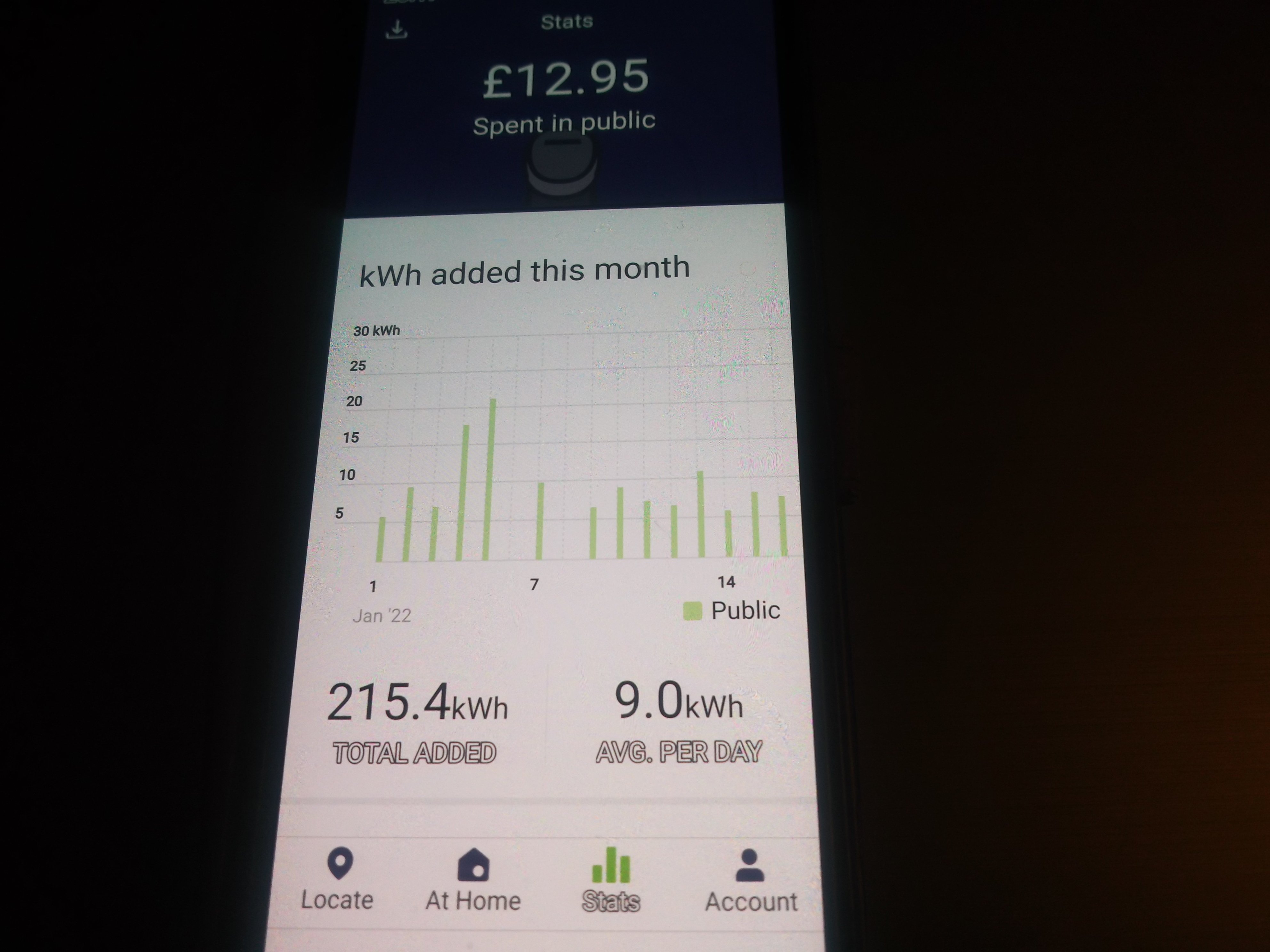

This month i have had 600 plus miles using PodPoint for under £13 on the 50 kW charging and the rest from free 7 kW charging.
Then another 600 miles on free charging with CPS.
Also i paid BP Pulse £8.50 for 2 charge sessions.
