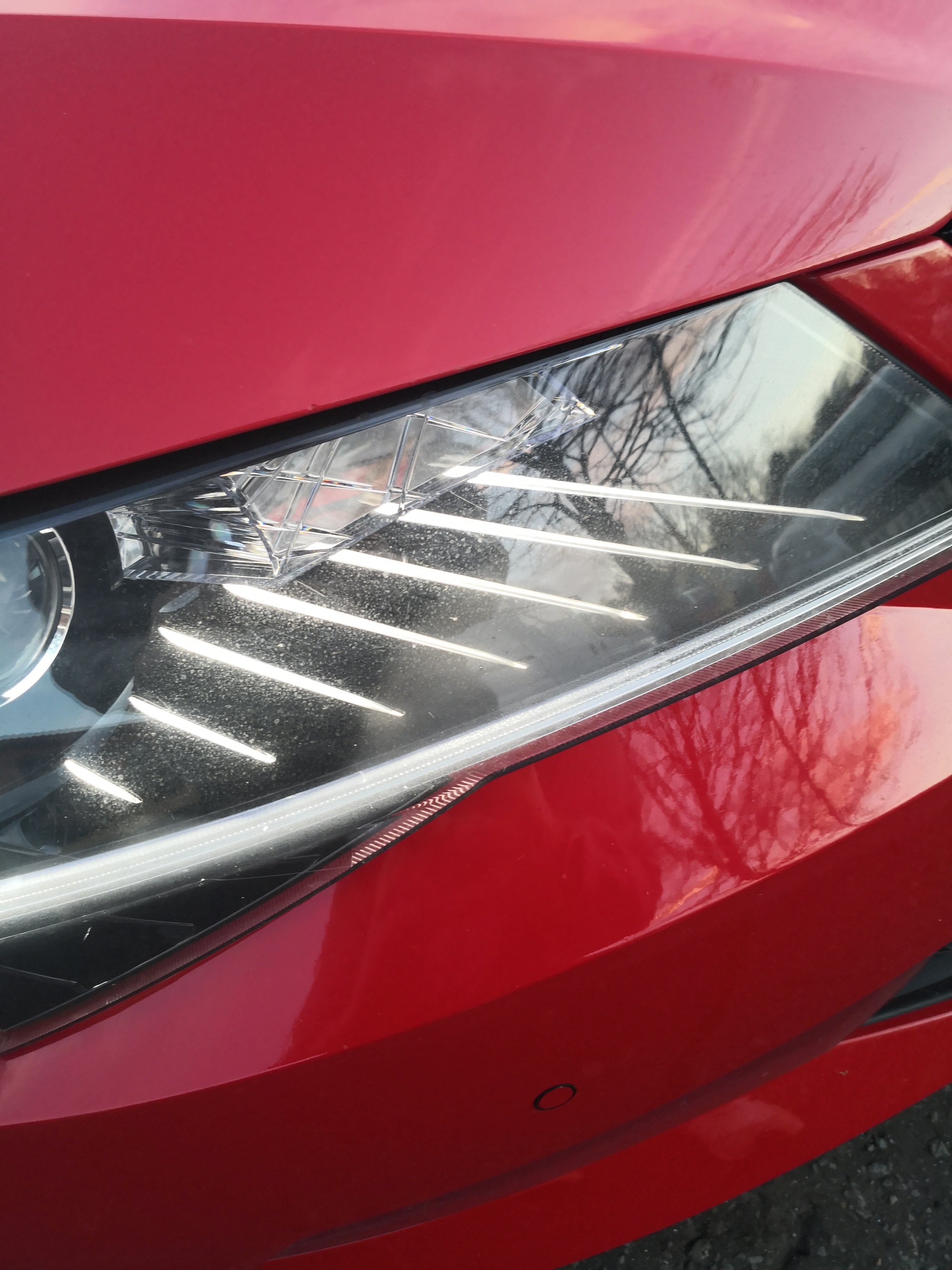

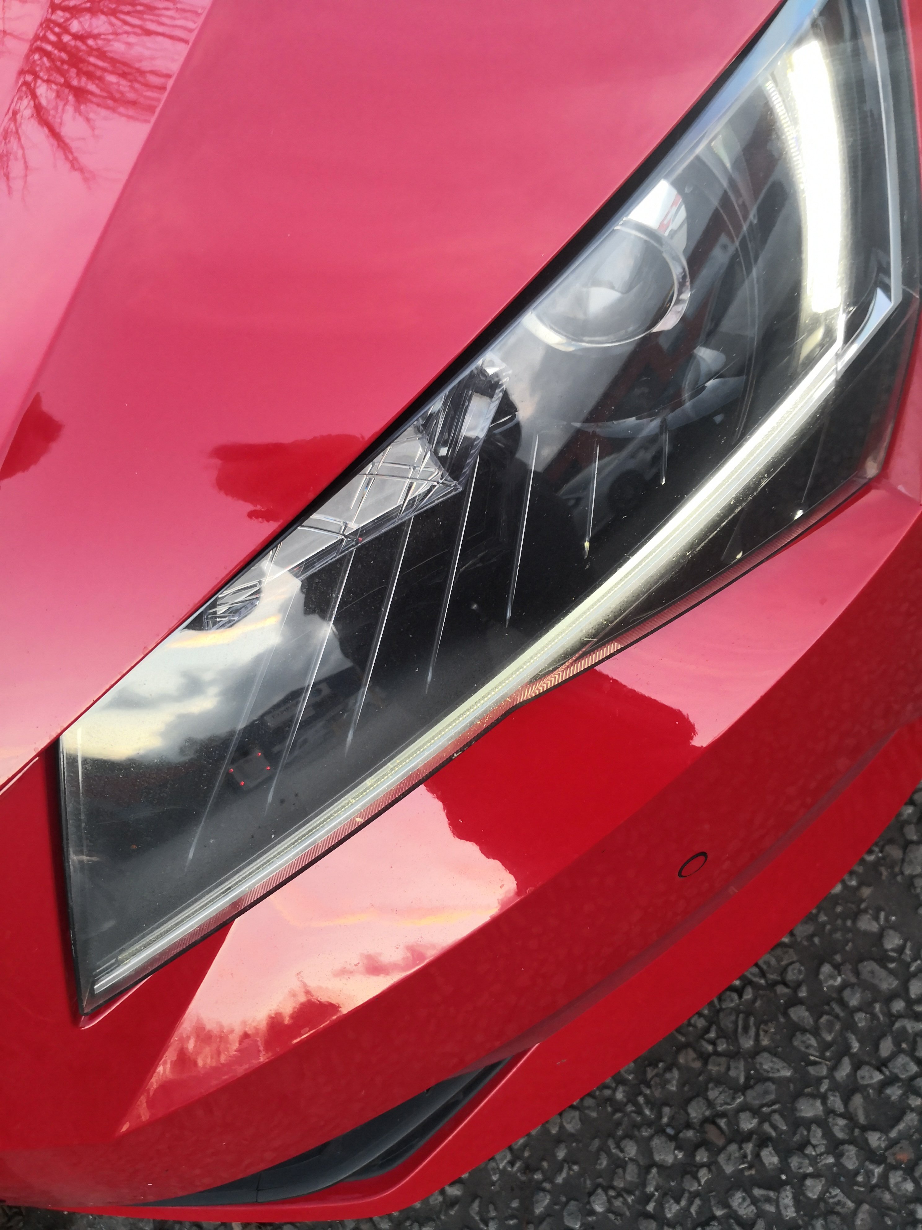

Pics for comparison on lights

You should be able to look at the light cluster which isn’t working and see if everything is connected, as I believe the eyelash lights have their own connector (might be lying though)

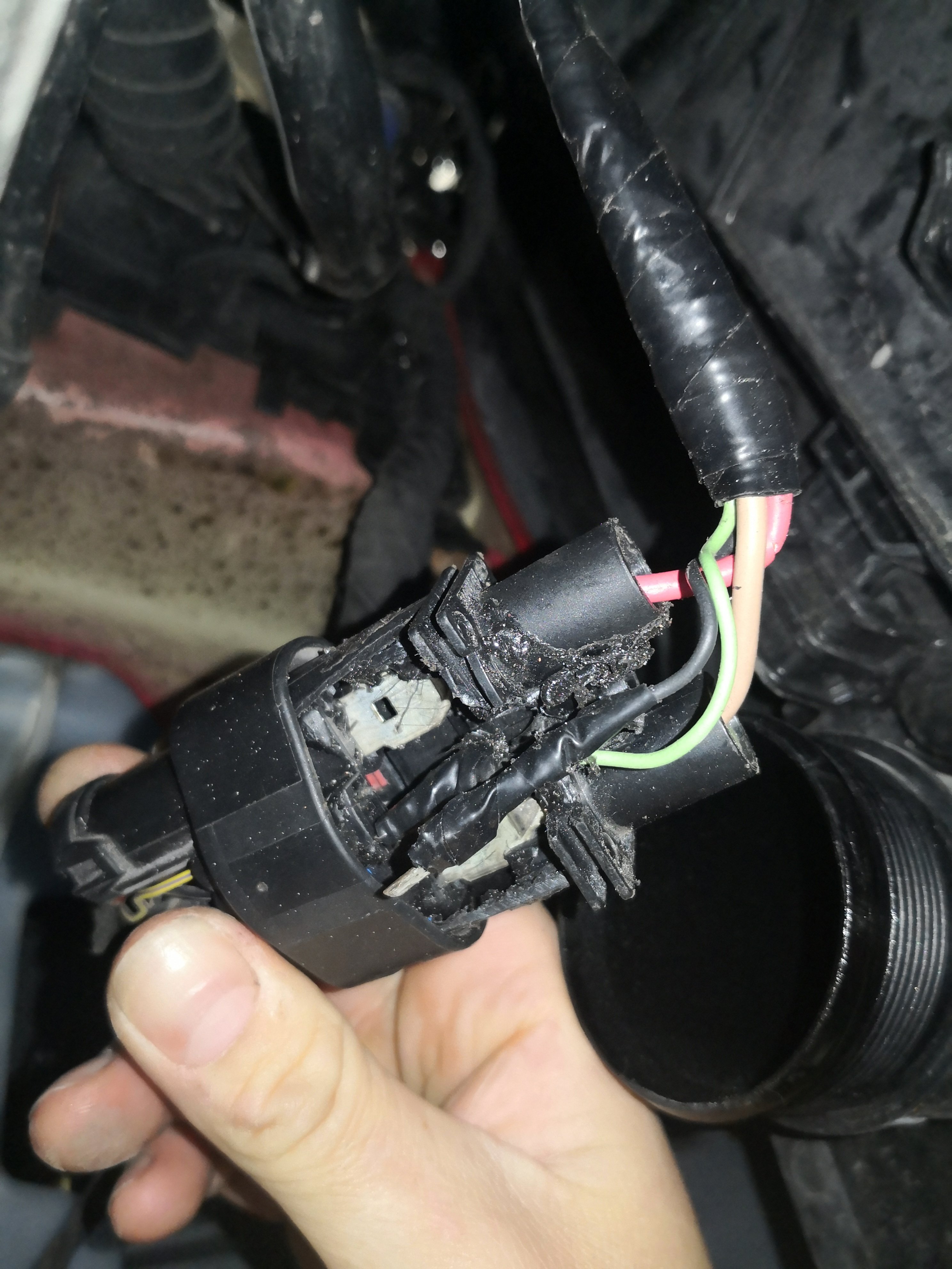

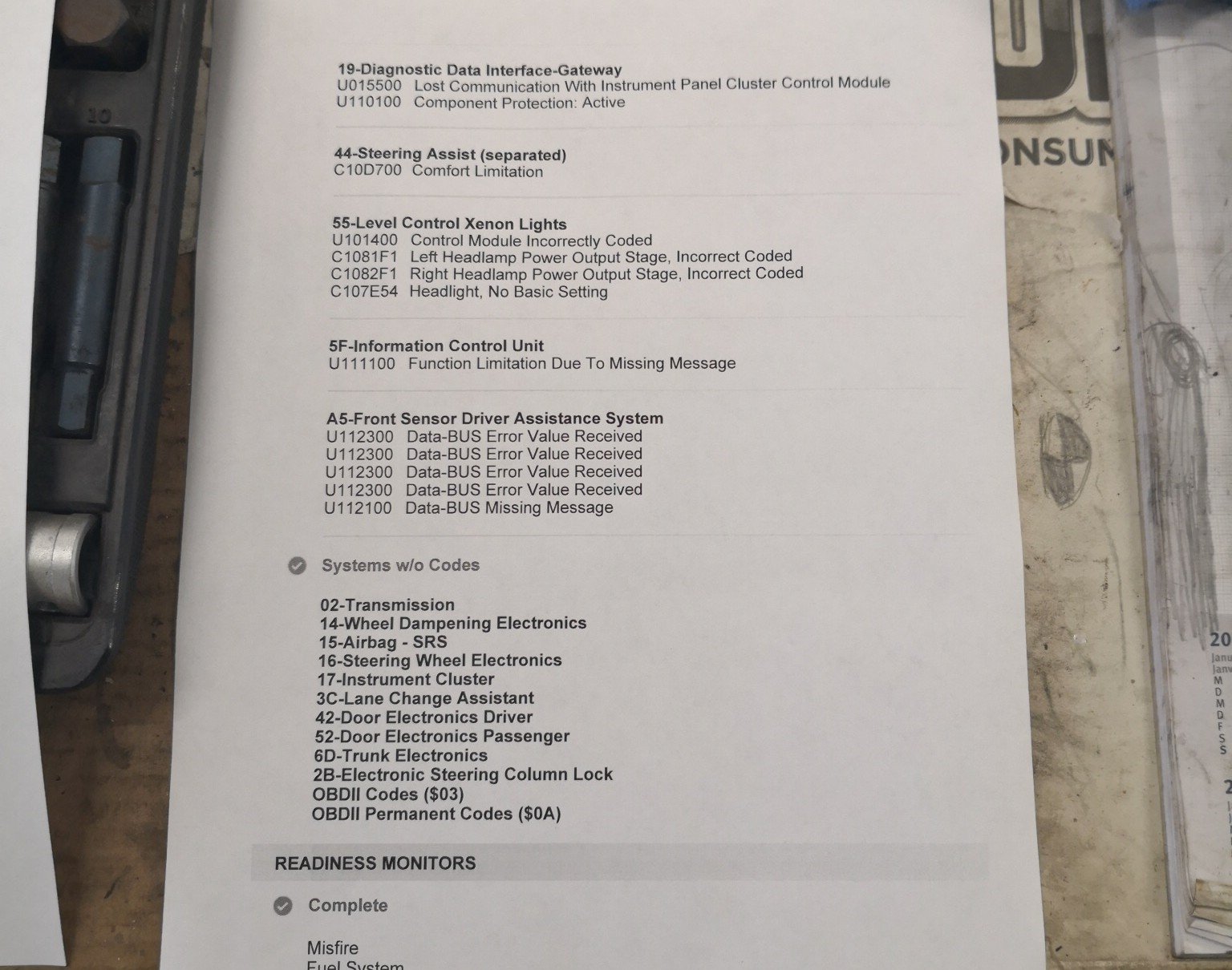

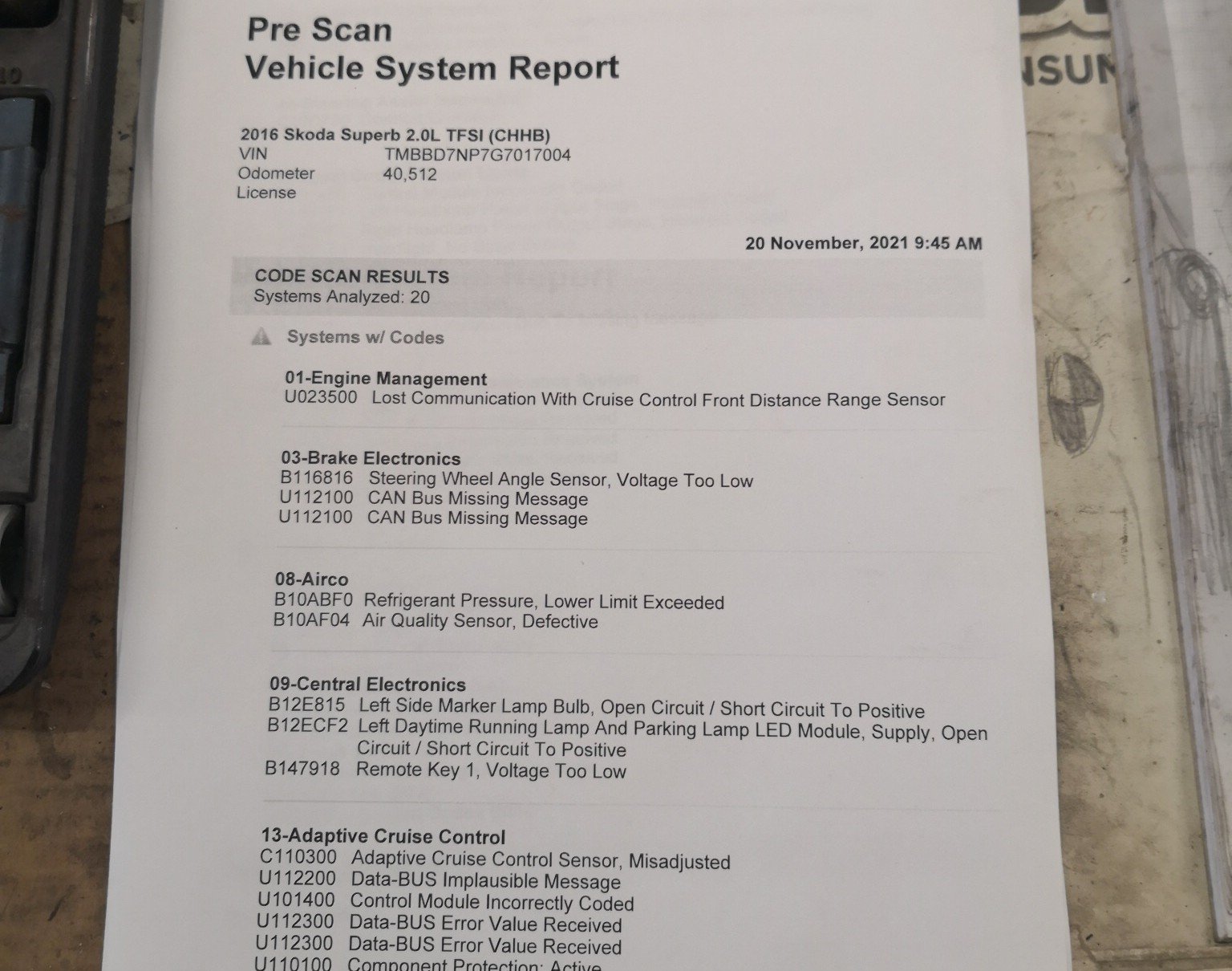

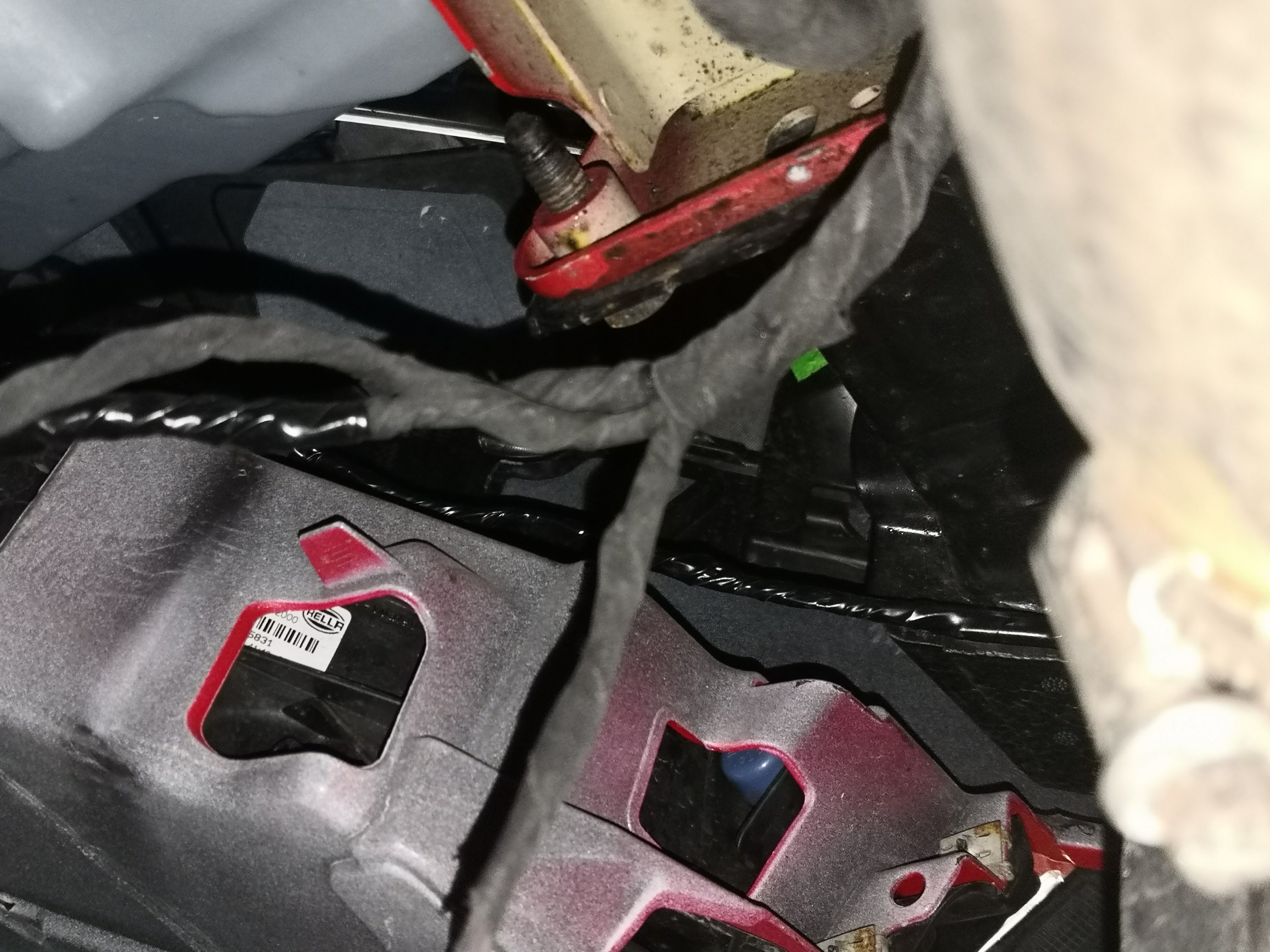

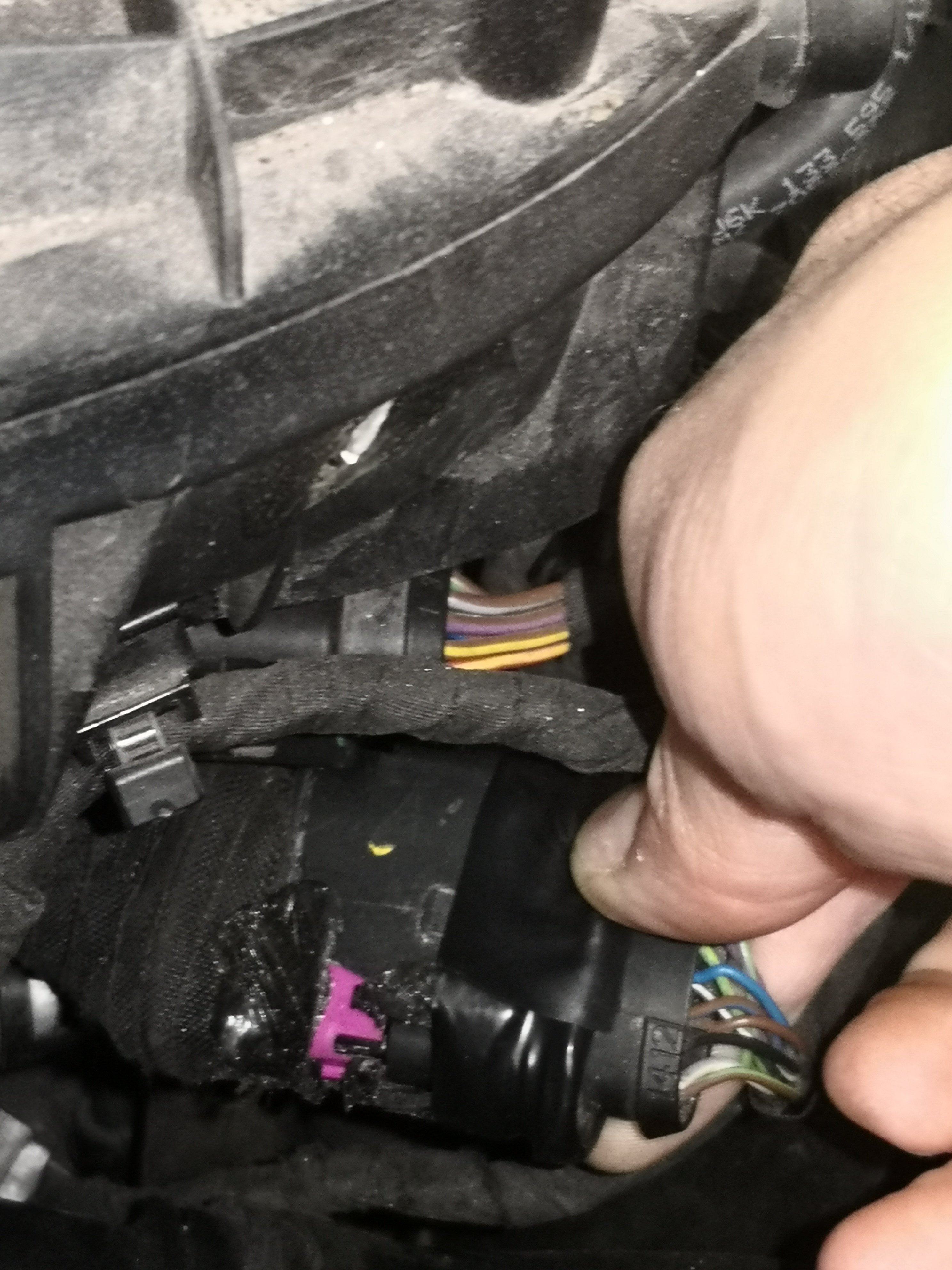

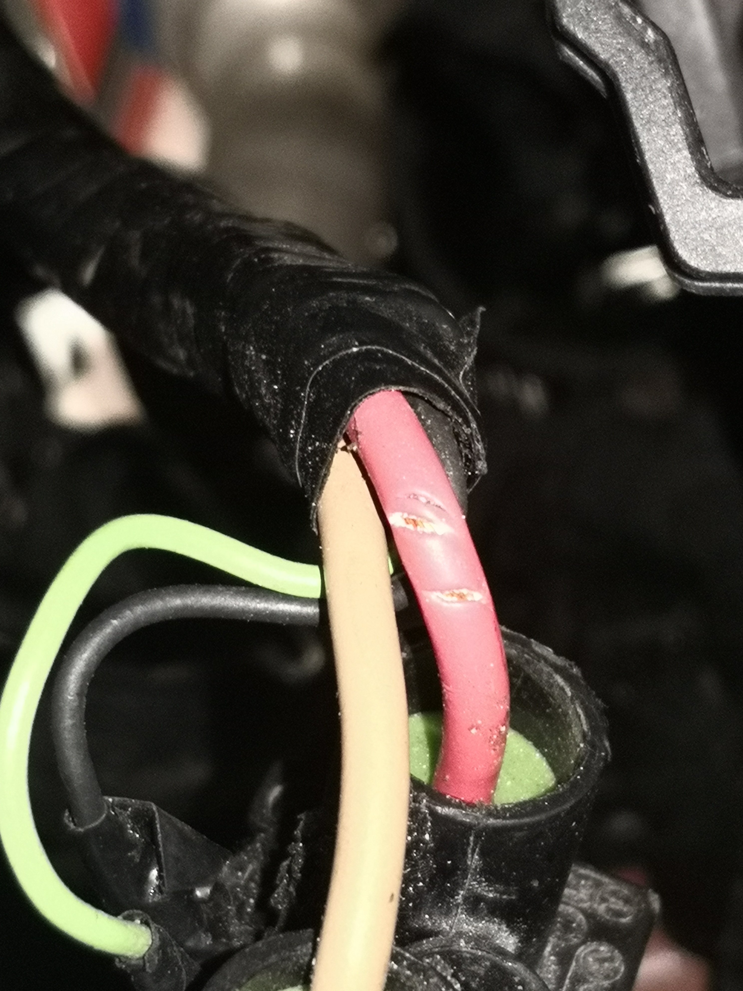

Makes me feel. Sad looking at this but here we go... Took to a trusted garage and had the codes read and cleared... All came back...

Looks like it's had an attack of the rodents!  Take it back and get a refund
more like some 3rd party repairs after a front end colission!
Possibly but some of those connectors look chewed.  Either way it's time to take it back and demand a refund
I suspect that is from a from a crash and I’m guessing non declared, is the car cat n at all?
I suppose rodents are a possibility with an awful repair job.
Personally I’d still take it back but after finding those dodgy repairs as long as you’re prepared to get everything repaired correctly and expect to find more things to fix then it’s still fixable.
Only you know which way you want to go, I just hope you didn’t pay too much for this car as “you’ve been had”
No its definitely a repair done on the cheap, those connectors have been plastic welded back together like Humpty Dumpty with a soldering iron.
I'm not proud to admit that I have decades of experience in piecing together pieces of shattered plastic rather than pay a fortune for new parts on my write off rebuilds because they have all been very new vehicles & pattern parts or breakers parts just were not available, however all the vehicles have been driven to destruction by myself and not sold on.
The Yeti Humpty Dumpty headlights were just to get an MOT to be legal to bring it to France where I bought new LHD units, the plastic grille slam panel looks like Frankensteins monster when you open the bonnet and the plastic (not) welding has recently cracked.
The loom wiring visible in the photos has been wrapped with adhesive insulation tape and not the non adhesive wiring loom tape or the correct fabric tape used on the OE loom, you can see one length looks much cleaner and shinier than those around it.
Cut it away and you will find all the bodged joints underneath, probably just twisted together, you can see one where it enters the connector.
Try and return the vehicle as those electrics will give you no end of continuing problems, if those are bodged what else is bodged, how significant was the damage, were any suspension components replaced?
Check the crash beam and radiators (aircon, water and intercooler) for having been replaced with either pattern or second hand parts.
Edited by J.R.
J.R. has described in detail what i saw in the pics, thats why i said its not rodents.. If you can, take that car back, as it could be a never ending story if you try to fix it all up!
oh its definitly a crap repair whatever the inital cause...   i can see that!!
