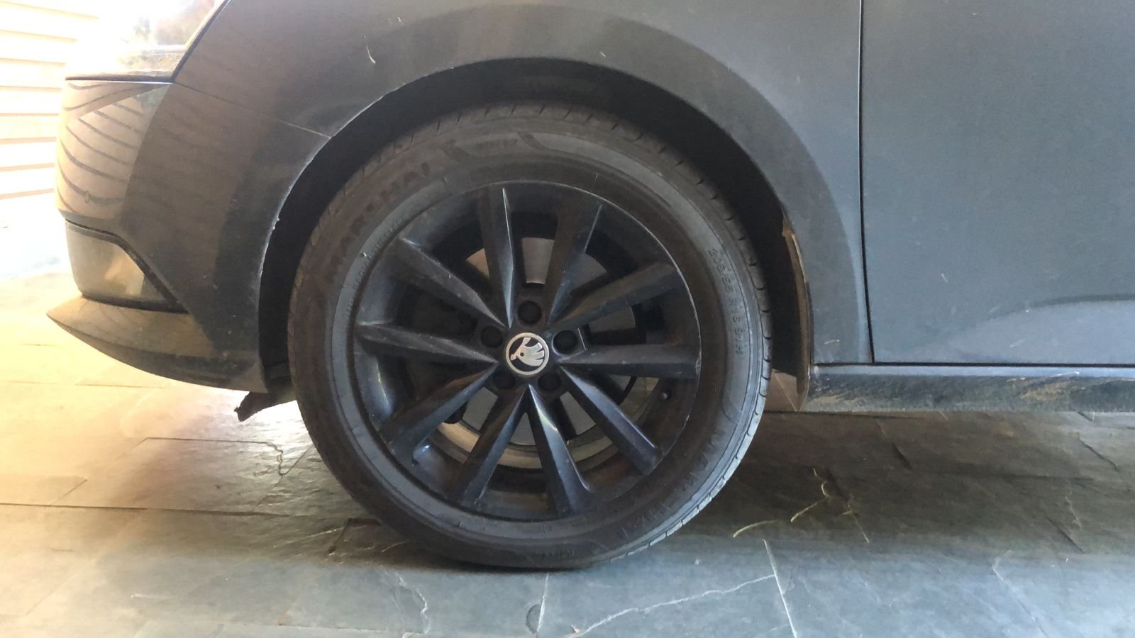

I was also looking at placing a 205/55 r16 measure because I know someone who occupied that measure and it went well, I leave a photo of how it looked
but I am waiting for the dealer's responses.

Looks are a matter of personal taste but fit is important the tyre needs clearance to allow for suspension travel and to miss anything that shares the wheel arch area (and to allow for weather conditions in places like the UK).
215/55R16 is a taller tyre so this will also raise the points of suspension above and below. - https://www.wheel-size.com/calc/
The tyre itself, the make, model, type and make up is important to the ride comfort and noise too.
Edited by nta16
I wouldn't be surprised if 215/55R16 rubs in the wheel arches. They are a large tyre.

And when you mean that it is too big for Fabia, what implication can this attract?
The person I saw and who told me about his experience had about 205/55 r16 told me that he had no problems and that when he turned the steering wheel to the maximum he had no friction with the fender or another element inside the wheel, he told me that the change comfort was very noticeable
215/45r16 =  599 mm nominal diameter (off the car)
205/55r16 = 632 mm nominal diameter (off the car)
185/60r15 = 602 mm nominal diameter (off the car)
195/65R15 and 205/55R16 are both Golf/Octavia sized tyres.
People sometimes buy secondhand Golf MK4 6Jx15 ET38 alloy rims fitted with 195/65R15 tyres for their Fabias. I haven't heard of anyone that hasn't had problems with rubbing. 205/55R16 would be even worse as although it has the same outside diameter it's 10mm wider and uses less offset.
You will only know for sure if you don't have a rubbing problem if you have tested the car in all conditions, with the suspension being fully compressed.
Fitting tyres with little to no clearance is a bad idea. Sometimes you might not get rubbing in a straight line, but rubbing could occur under cornering forces such as driving around a roundabout or when there's a heavy load.
If smaller wheels and tyres were fitted by the manufacturers there could be more wheel arch clearance which would allow more comfort ride setting to the damper, springs and rest of suspension.  The smaller tyres with higher sidewall provide cushion too.
As it is now the wheels are big "filling the wheel arch" as is the fashion leaving less room for movement for the suspension so it's generally tighter and harder so as to be more controlled as it needs to be for the lack of space.
Imagine, as has been put in previous post, the car fully loaded with passengers and luggage taking a tight so the car squats one side with the transfer of weight and motion (more so if also braking putting weight also forward), without "stiffness" and/or wheel arch clearance the tyre would be rubbering so the tyre and car not fully controlled and potential damage if continued long term.
