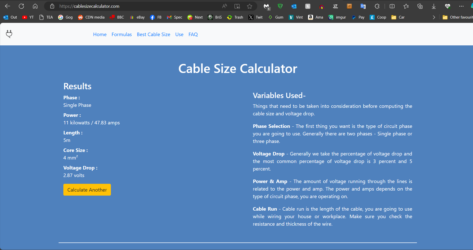

Well, if you have a look at the following website, Cable Size Calculator | Find the size of your Wire/Cable you can enter the various parameters and do your own cable calcs, but I based in on the plug in cable from socket to car being 5 metres in length. It is clearly a single phase supply seeing as it is 13A plug fitted and based on 11kw then the cable and more worryingly, the cable feeding that 13A socket is actually (if the charger is being used at maximum power) is over running the cable at 3.7 times its rating, at full power it is going to get very warm to the touch.
The table below is based on the highest allowable voltage drop of 5% and you can see that it comes out at 47.73A for the cable. Then you also have to add in the total length of the cable the length of cable from the socket to the fuse or MCB which makes it worse.
OK, assume your house has a ring main circuit for the power sockets, it means that the total power available is going to be around 32A, but that weatherproof socket will on a spur and fed with 2.5mm cable and you can see from the attached it needs 4mm.
I think i have read that the maximum amperage for single phase household electricity supply is 100 amps but that would be for the whole house An electric shower can now be 40amp, so if you had a 7kw wall point for the car 32 amp. There is talk of banning gas for heating A heat pump can need up to 14kw (65amp?) and if they do that for cooking? we are up to a potential 140amp just for three events. What effect i wonder is this going to have for the national grid in planning future supply to an estate of 100 houses

Yes I did read what he wrote and found it confusing as his photos depicted a granny cable and his chart seemed to indicate a maximum of 3kwh capability per hour which is well within the rating of a 13a socket, but 11kw is not. I just revisited Rooted posting and I see that he has now added another 3 photos. When I compiled my response he was only showing the charging lead and his car plugged in, just 2 photos and hence my concern, so yes I am what I claim to be but can only re-act to the information available at the time.
