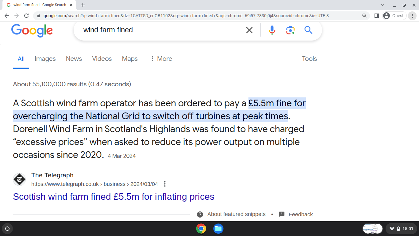

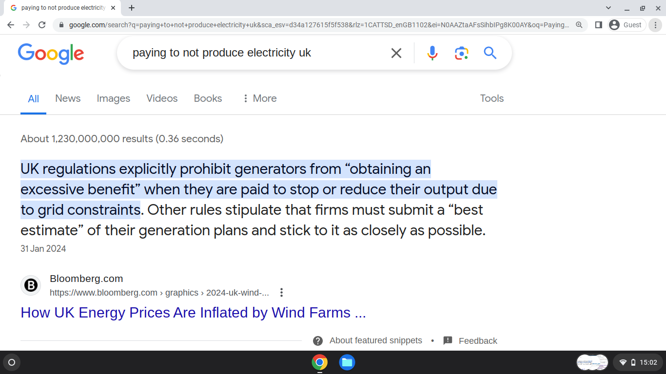

@Stonekeeper  It would really matter if WE are not all paying for the Electricity to not be generated now because England does not want the Renewables available.
Edited by Rooted
If only there was a way to store the excess until it was needed.
The energy companies and government will encourage the public to invest in Batteries because it's too expensive for the energy companies to do it without hitting profits and shareholder payments

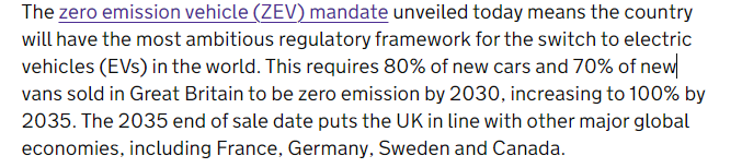

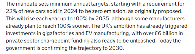

I thought that France is also locked into the 2035 deadline for all new car sales to be BEV, so doesn't that mean that like, us, you'll have no option either. I find rather hard to accept that makers of chargers are going to have to produce variants specifically for the UK?
There will be EU regulations that we are following
@Graham Butcher Are you really surprised.
The UK or non EU country is a special place for special people with many manufacturers producing / manufacturing goods for the UK or other global regions.
It's only locked in until such time as the goalposts are moved again.
Originally it was "locked in" for 2030 ;o)
Meanwhile I wonder whether or not we are even on course for the 2024  target?
https://www.gov.uk/government/news/government-sets-out-path-to-zero-emission-vehicles-by-2035
