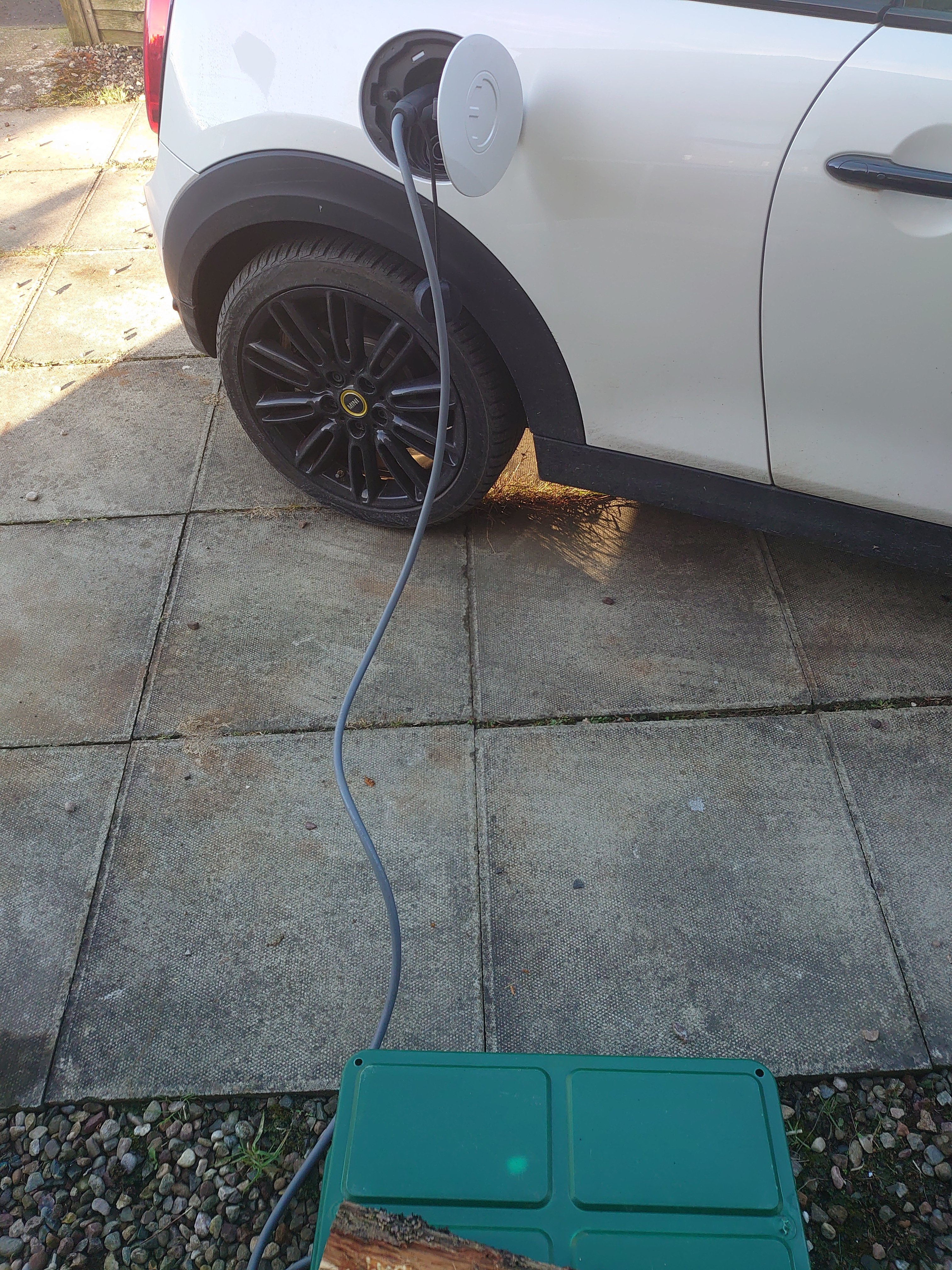

@J.R.  Against all advice from those in the know i am just charging up to as much as 30 kWh from a cable plugged into my 3 pin wall socket & outdoor extension cable.
Max 10 amp.
9 kWh  taking 3 hours 41 mins.
25kWh   "         10 hours 59 min.
28kWh   "         11 hours 58 min.

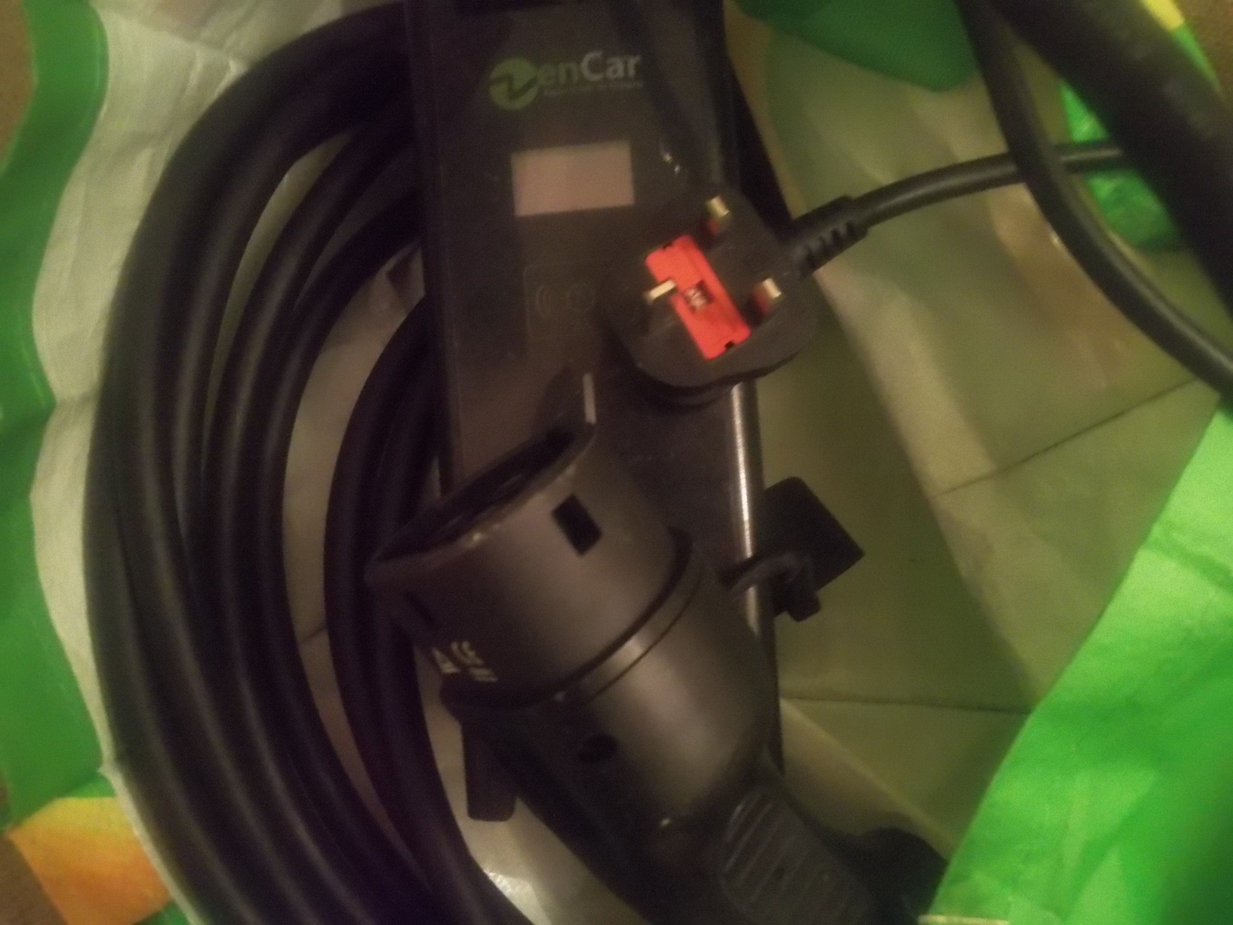

It all depends on the capability of the charger, it will have a maximum power rating per hour and that is the governing factor. With a 10amp cable you are over running the cable slightly, that said of course it will also make a difference depending on the length of that cable, very short runs may get away with it.
It is not a charger.
The 11 kW on board charger is in the car.  It is a 3 pin charger cable, often referred to as a GRANNY Charger.
Not this one, that was bought before i had an EV.
The MINI came with it,s own one.
As to the charging, you can set in the car the max power you are charging at, regarding DC charging or AC from chargers, or from the Onboard charger.
