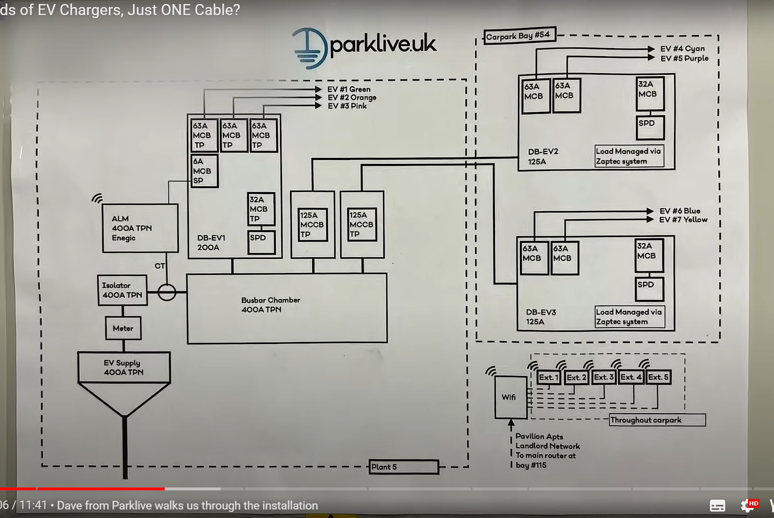

Do those figures make sense? 20 X 22kw charge points on a 63amp MCB  using 16mm cable  (50amp) at the end point.
22kw is 95amp?
63amp = around 14.5kw between 20 cars
equivalent of 2 home chargers shared between 20 cars
Hope they all don't want to go far next day after an overnight charge.
At least the heating bill for the flats will go down
120 cars on a 400 amp supply. 3.3amp each when all plugged in  = 2 miles an hour.
Hopefully someone can explain what i have wrong?
I agree, but the system does shift chargers onto other phases to try and balance them, and it clearly relies on not everyone wanting to charge every day, so clearly gambling on most of the cars being used as city cars and doing a very limited mileage each day. That in reality is not always going to be the case and there will be some cases where the management system will fail to throttle people's chargers and severe overloading or disconnection of the supply could occur with all the potential hazards and problems that can bring.
22kw is 95amp?
3 phase connection i presume as he talks about three distribution boards.
Not sure if that is 400 A each for each phase meaning 1200A at 240v ?
I think it must be three phase to get the 125 at the start of each leg. 125 to 2 x 63. But my point was the end point cannot be over 50amp = 11.5kw = 46mph . So if 20 cars are plugged in to charge the most available to each is still governed by the 63amp mcb even if the clever system can switch phases to maintain the 125amp
He only has a 400A incoming supply coming to the main disconnect that he showed you, and then that in turn splits off to feed the three, three-phase distribution boards which he again showed you on the schematic.
The key is not every EV will be charging all the time, and having ability to plug in is more important than quickly charging. This is the flexibility of EV's, when it's parked, it can charge whenever it is able, doesn't need to be straight away at maximum.
63 amp across 3 phases, assuming 240v, is 45 kW.
45 kW over 24 hours gives 1,080 kWh.
1,080 kWh is good for ~4000 miles.
So unless cumulatively, all the residents' total mileage is consistently more than let's say 3000 miles a day to give lots of leeway. The shared incoming supply is not going to be a problem.
This is the same with rapid charging hubs. 350 kW charger will not deliver anywhere close to 350 kW for vast majority of the time.
I really like Kempower and Tesla method of sharing charger capacity across multiple ultra-rapid stalls.
