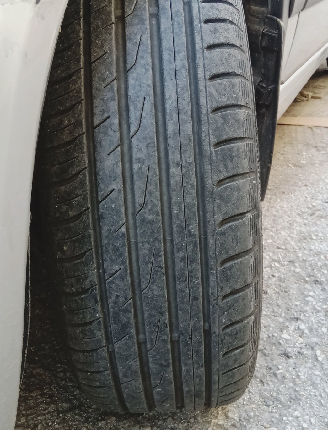

The Toyo may not have 4 grooves around the circumference, as sellers use generic photos.
Here are my Toyo today, i have them since 2016.
175/60R14 has about the same outside diameter as 165/70R13. They both have the same load index. They both are standard Felicia tyre sizes.

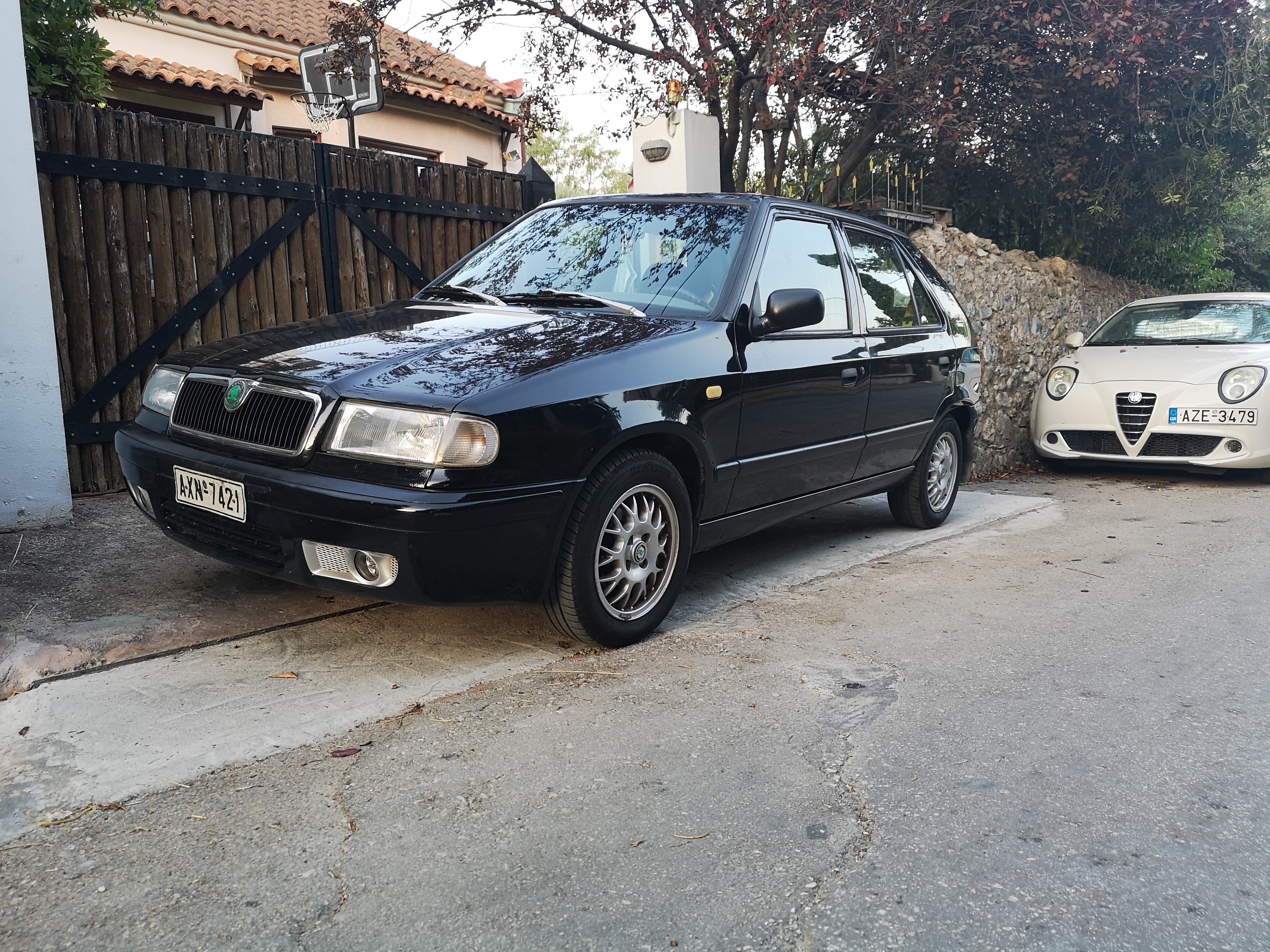

My Felicia has ECU-chip, BMC filter,custom exhaust manifold-pipes-muffler and tail pipe.
320mm new steering wheel, 3mm lowered springs, Koni shock absorbers, strut bar, anti-roll bar, new top-mount and 14 inch Tecnomagnesio rims.
I use my car for few Km daily route at city (work-house) ,for sport driving at mountain roads and when i am on the highway a speed of 100-120 Km is fine for me.

My Toyo are the CF22.

Toyo PROXES CF2  note the variances in actual dimensions against nominal sizes. - https://toyotires.eu/tire/pattern/proxes-cf2
What about looking at tyres in 165/65 R14 (only 3mm taller and differences in real rather than nominal sizes and tread depth in tread could may them the same height) ? - https://tiresize.com/calculator/
