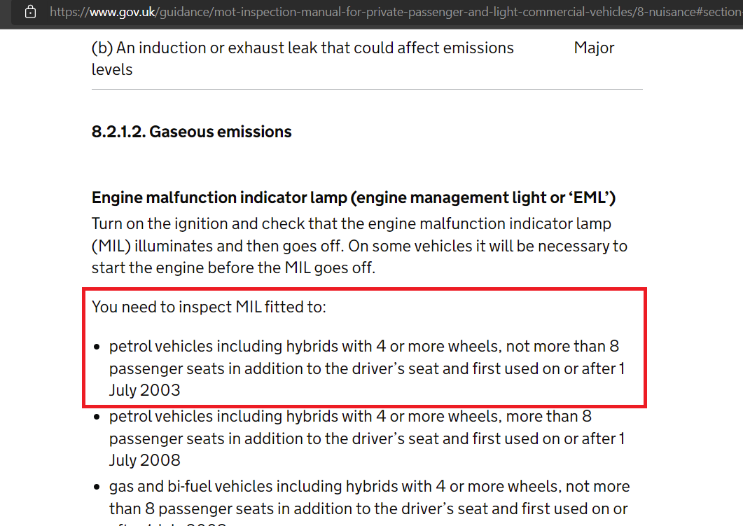

    Actually, surprisingly perhaps, it doesn't matter if it's on, so don't worry too much. Just screenshot this and point it out to the tester if they try to fail your car for EML on. Your car is too

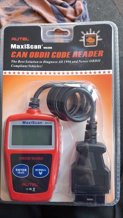

    Just as a wee recommendation then, I've got the Aldi branded one of these and I imagine that's just the same thing: https://www.ebay.co.uk/itm/363357118683?hash=item5499c5a0db:g:5oMAAOSwP6FgdHuc

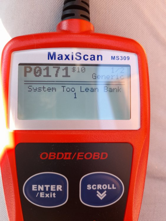

Might do, might not, might be other stuff too, in addition, or might be single cause - that's the thing with cheap error code readers they don't always tell you much.  What is on page 2 of 2?
Have you tried clearing the code to see if it returns?
As it shows P0171 is a generic code. - https://vwtuning.co/vw-audi-p0171-engine-code/
The same was on page 2.
2 minutes ago, nta16 said:
So do you have a error code now?
No I have cleared today and took it for a run and it hasn't come back on so far.
