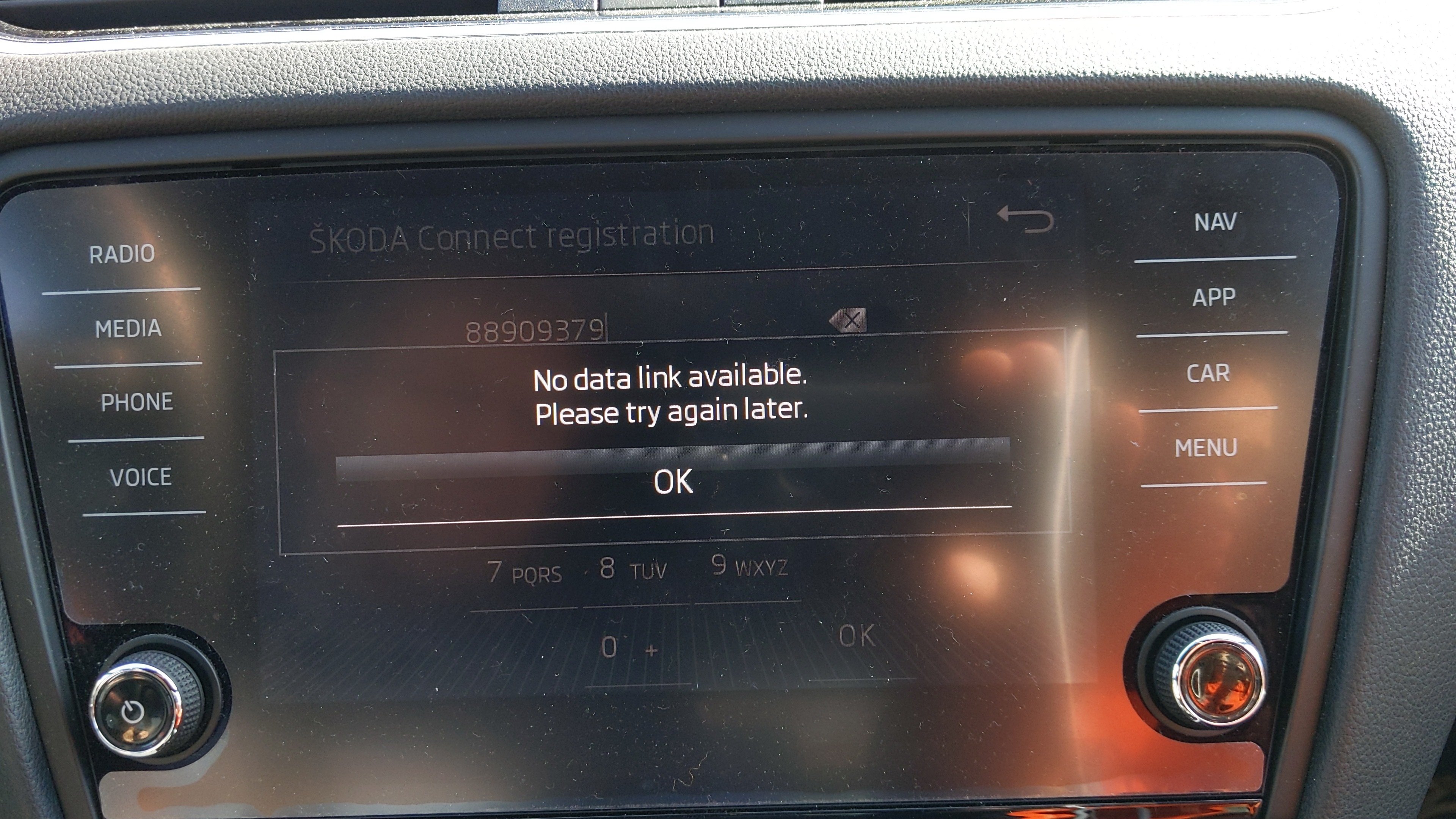

Would be interested to know how long it took from putting in the activation code to the "No data Link" message
mine is about 30 seconds
I was using a Samsung A52 (5g) over sky - and I could not even get to the code screen
so I got an old Sony Z5 out using a smarty card and that let me get to and input the code which then started the process and then failed after about 30 seconds
however, i also got a error message on the Sony phone saying "Tethering Error" which disappeared - everything else looked fine
Maybe the issue is related to the phone and/or the mobile network or even just a tethering issue

I have had various times for the “no data link” to show up, I have found that I have to have a full strength 5g or 4g signal on my iPhone before I can get the enter registration screen up, once entered the no date link comes up instantly.

Yes at first with the Sony  (only LTE capable) I also had it connected via Bluetooth and it also came up with no data link instantly. I read you should not try and tether and Bluetooth at the same time so I switched off the Bluetooth and just used the hot spot WLAN. this then allowed me to enter the registration code and it starts to register but fail after a while.

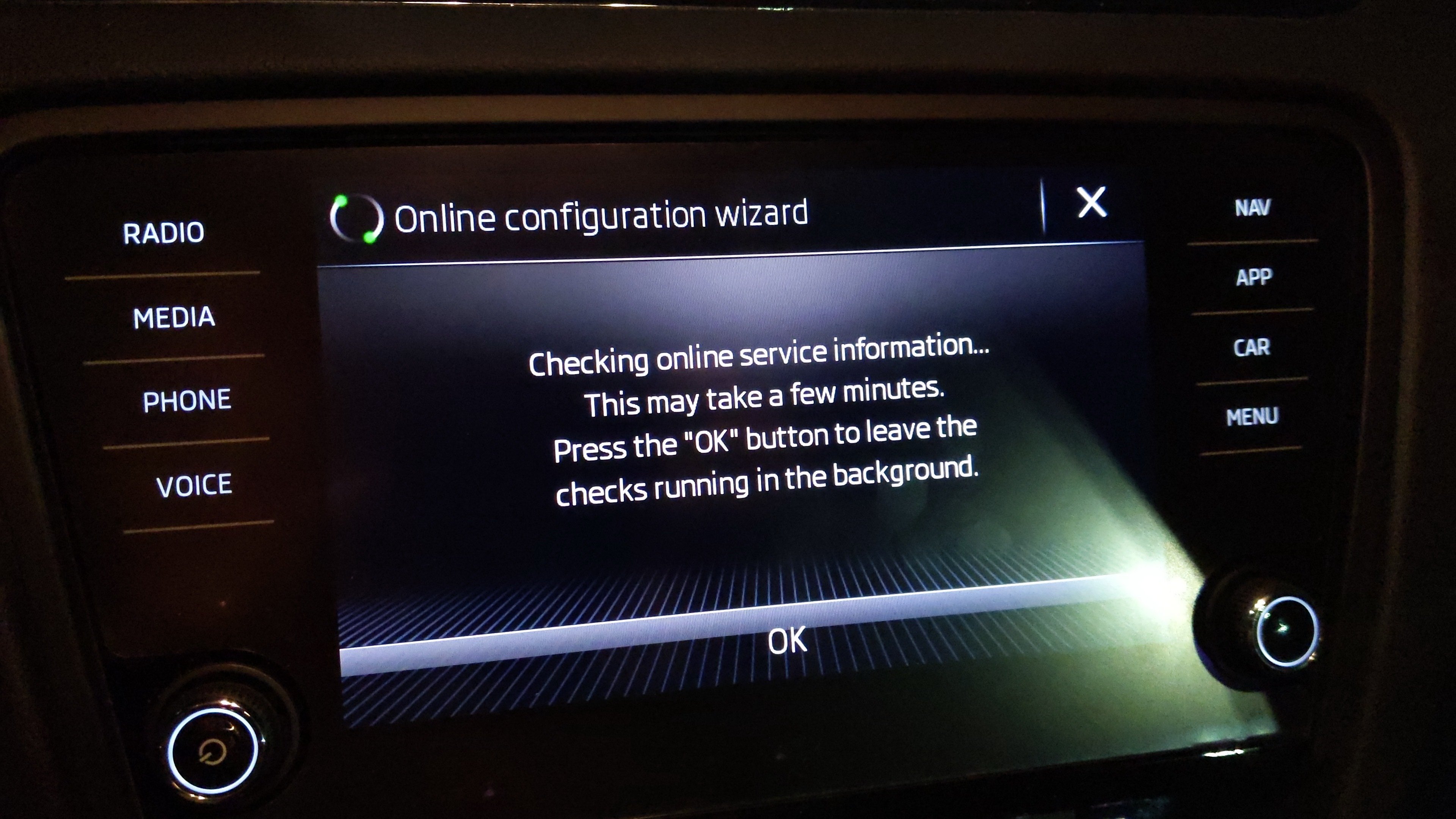

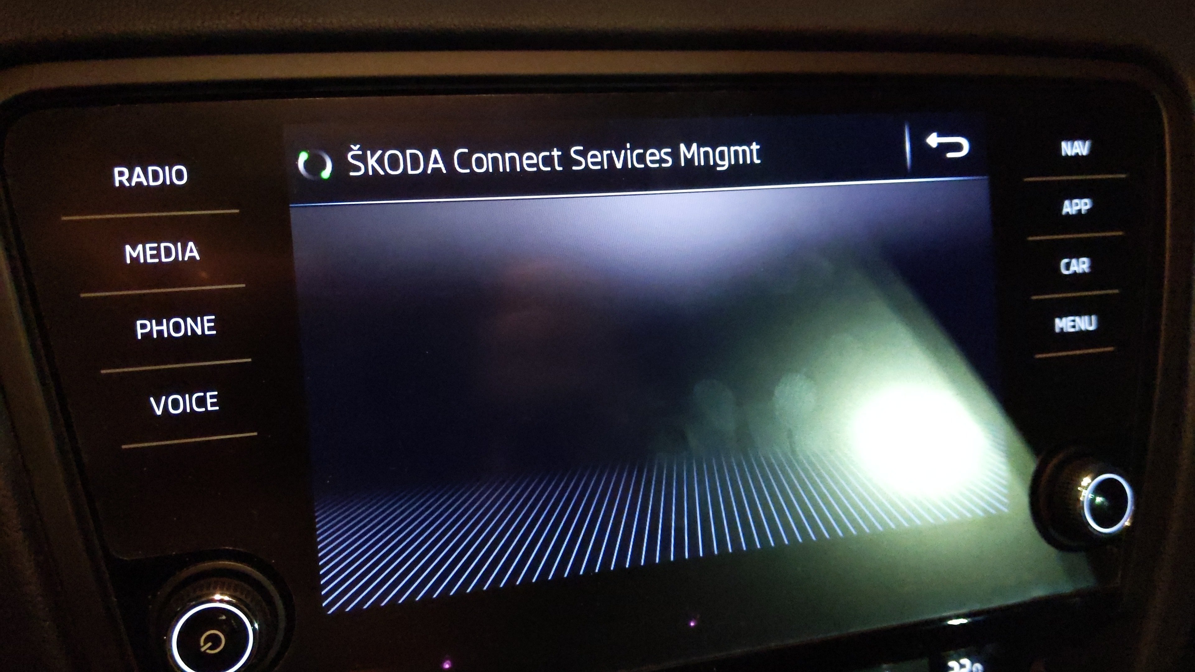

In my case the infotainment system mostly didn't get to the point for me to be able to enter the code and i wasn't able to get infos on the services from the settings (as shown in the pictures). This Sunday i tried again, and to my surprise it wanted me to enter the code... after that it was thinking for about 20-30sec (didn't time it exactly) and then came the error message "No data link available"....
