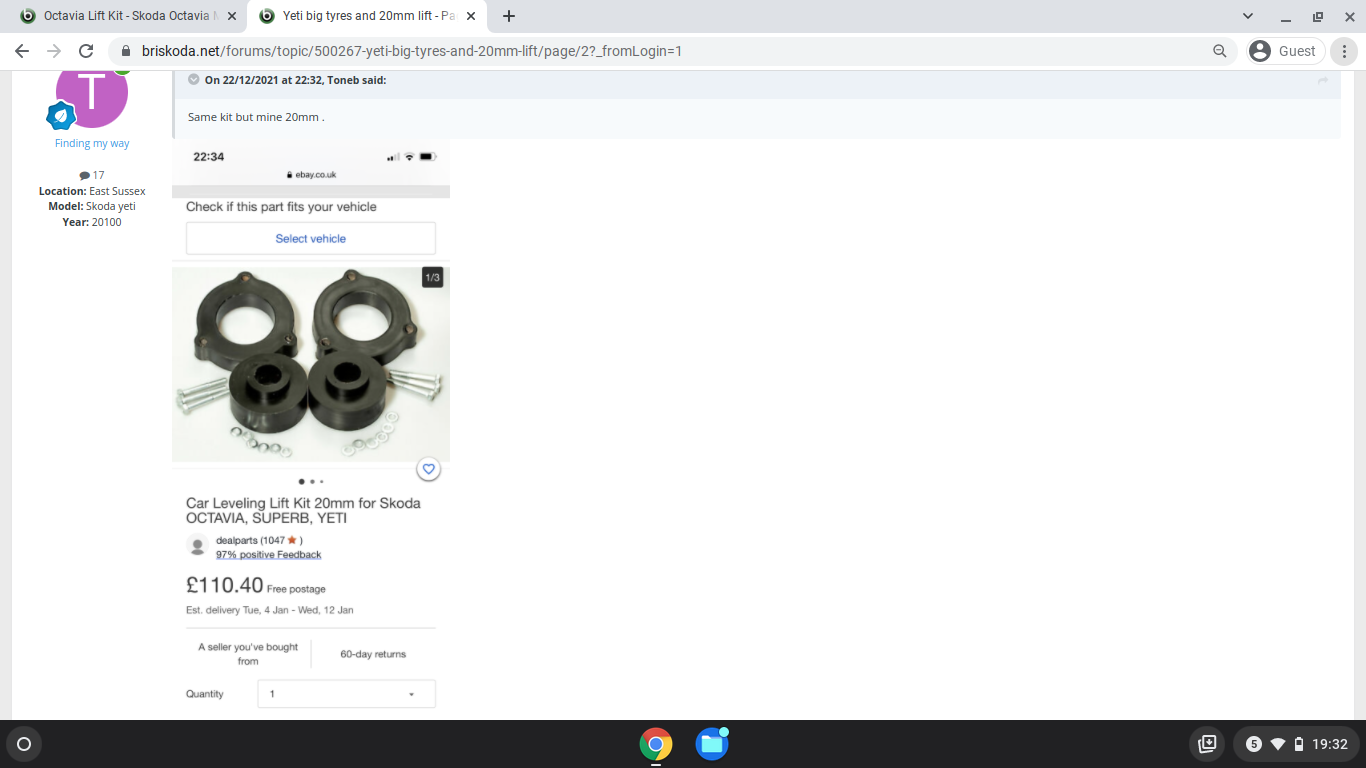

'Spring Spacers'.
http://briskoda.net/forums/topic/500267-yeti-big-tyres-and-20mm-lift/page/2

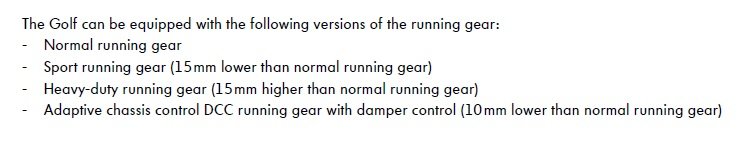

Here is a screenshot from the ERWIN self-study guide on the MQB platform Golf, which is what the MKIII Octavia is.
