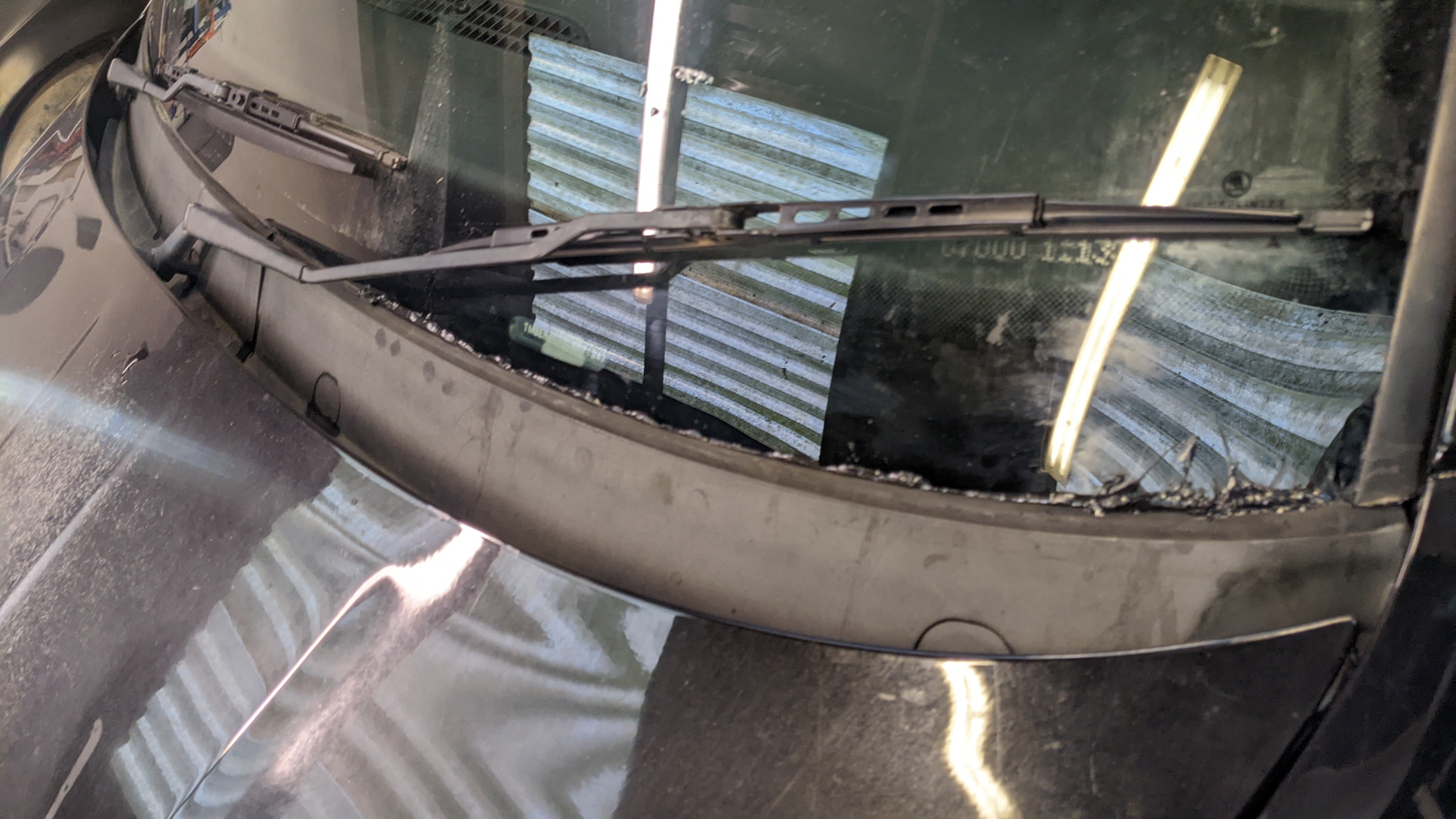

The RHS drain is under the scuttle panel. It's a smallish oblong hole.
You can just about see it if you pull the scuttle up, even better if it's off.
The LHS is essentially the same.

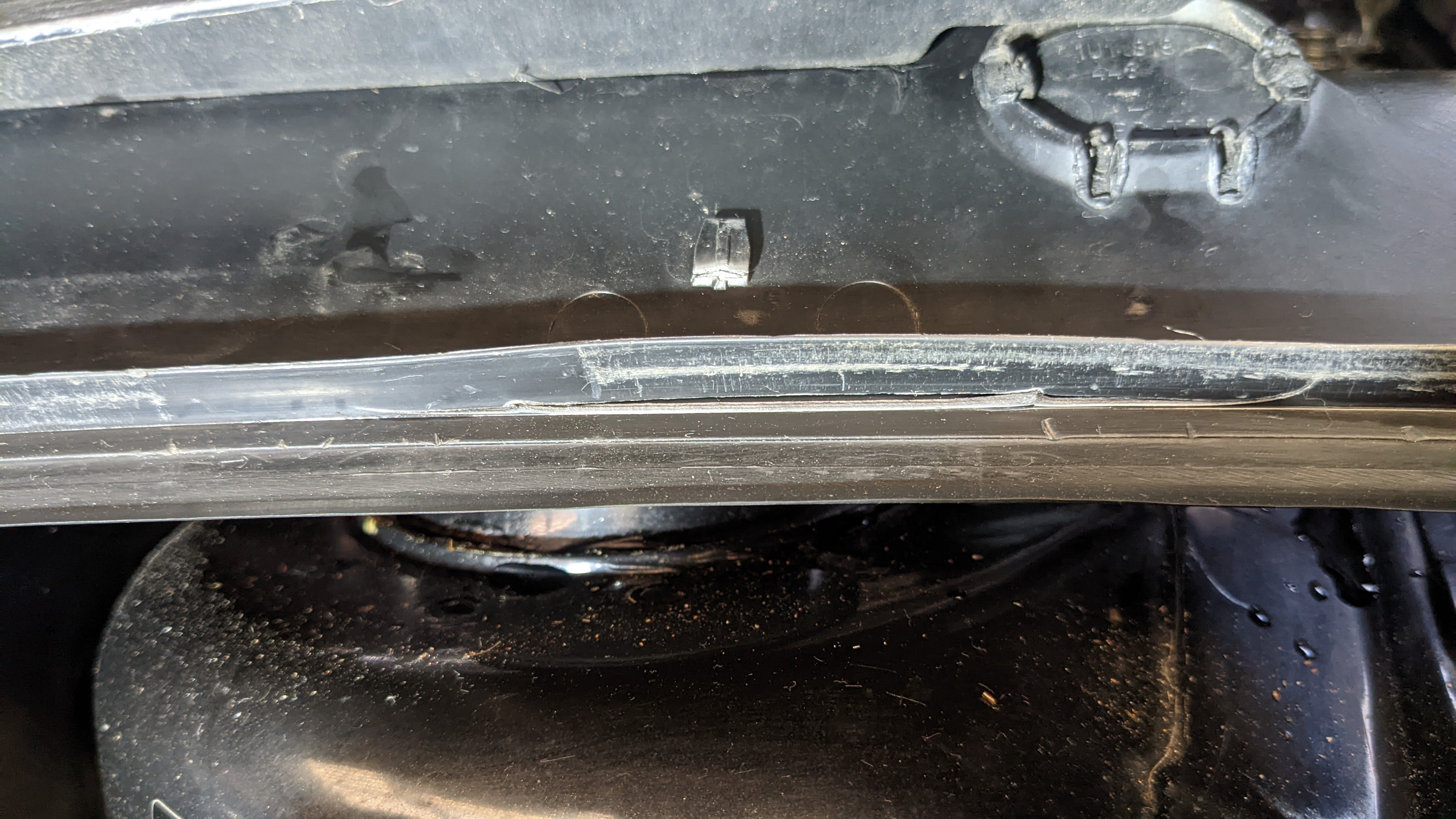

Just to clarify, they are BELOW the oblong holes in the picture and go to the wing.
The best thing to do is to removed the scuttle panels and clean out any rubbish that's in there.
Also remove the inner wheel arch liners, as they will be full of debris too.
The pour some water to make sure that it drains.
