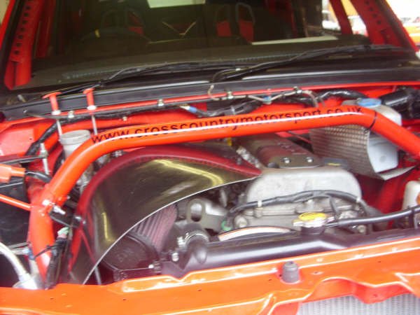

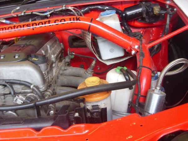

@thomasaspinWhen a Twincharger is running in moist air they run at about there best as many of us know.
When they are running an original clean filter they run great.   Or even a performance intake and clean filter.
When they get a damp filter or actually wet and it is then left sitting in freezing weather they can run totally sh!tw or not even run.
The Airfilter can freeze in the low temperature,
Some of us that have used Water Trap Inline fuel filters on our road vehicles / offroaders know how much water can come from the fuel tank.
Some will use K&N filters in conditions where there will be H20 kicking about as there is the perfect use for them, exposed, just as we might use a snorkel.
Some people actually learn as the years go on, it is a location location location thing.
On the fuel subject.  I once got crap Tesco Momentum 99 and that was at a Tesco outside Blackpool on the way to Santa Pod and running Stage 2.
I was out for a blast later that night near Preston with another member and the car was running crap i thought it was just the very hot weather.
Then the next morning after filling on the motorway in the scorchio weather.
I had to switch the map and use 102 ron petrol i had in cans and add that a couple of times as the tank emptied.
