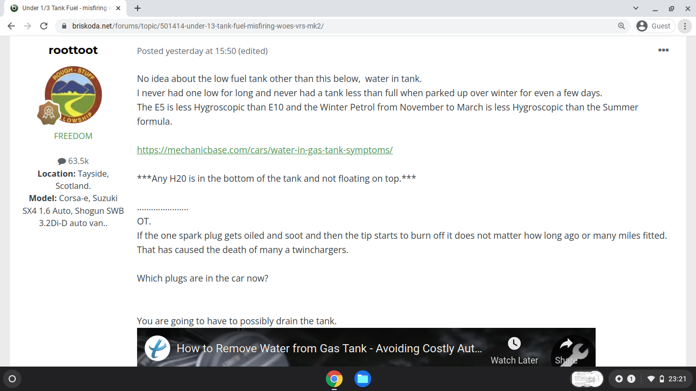

Suck some petrol from the bottom of the tank when the level is low and see if there is water in it.      Simple.  10 minute job.
If not then not the problem.
Your acting like water in the combustion chamber is a bad thing ? I literally squirt water into the combustion chamber mixed with methanol to allow me to push 2 bar of boost in the Rev limit ….
@thomasaspin  I know you do, you are my hero.
But you do not take the water from the fuel tank.
 The Refineries would not bother distributing less hygroscopic petrol from October to March if water in it was a good thing.

@sepulchrave  The OP posted about a 1/3 full tank.
So really what is a conspiracy of the Winter Grade Petrol from mid October in Scotland and then November to March being less hygroscopic
Plenty have had to check petrol in tanks. Leave sitting in a jar and see the water in the bottom.
Brighton might not have the same temp changes and condensation as elsewhere.
Pump out some petrol and check, dead easy.
Pipe with a string feed through and a piece of cloth and pull it through and siphon from the bottom of the tank as many off us have done since we were children running our kart or mopeds.
Edited by roottoot
And the fuel that is drawn from the bottom of a full tank is exactly the same as the last drops of fuel drawn from a tank when you run out of fuel the pick up pipe does not move and the water does not float above the fuel.
