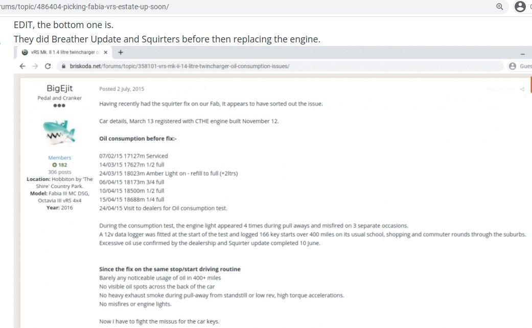

@Kobayashicar was an excessive oil user.
It got the Oil Spray Jet upgrade done.
http://briskoda.net/forums/topic/453521-any-pics-of-oil-squirter-location-vrs-14
http://briskoda.net/forums/topic/420740-mk2-fabia-vrs-aka-green-monster
