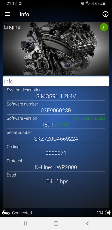

while i got the obdeleven connected to my phone, i had a look around on the obdeleven and it says that i have a newer software to download?

No, leave the ECU firmware alone, you'd have to go ask a dealer to change it so you don't need to worry about it.
thank you
what exactly will happen if i update to  newer version?
30 minutes ago, froggy8 said:
thank you
Probably nothing but it's important to remember that a PCM is NOT like a smartphone, the firmware it comes with was designed to last the life of the car.
ok thank you again :)

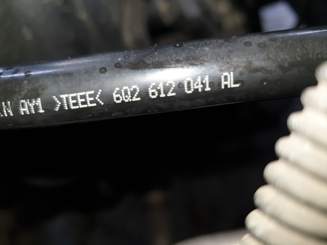

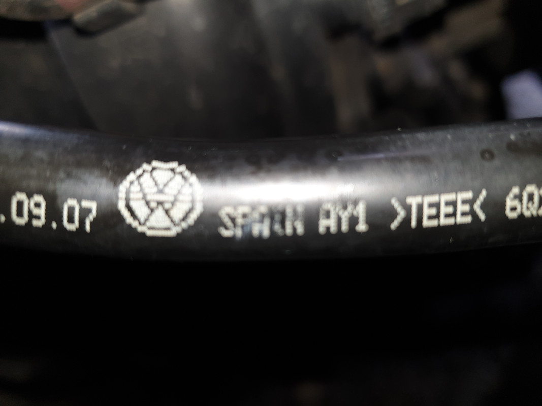

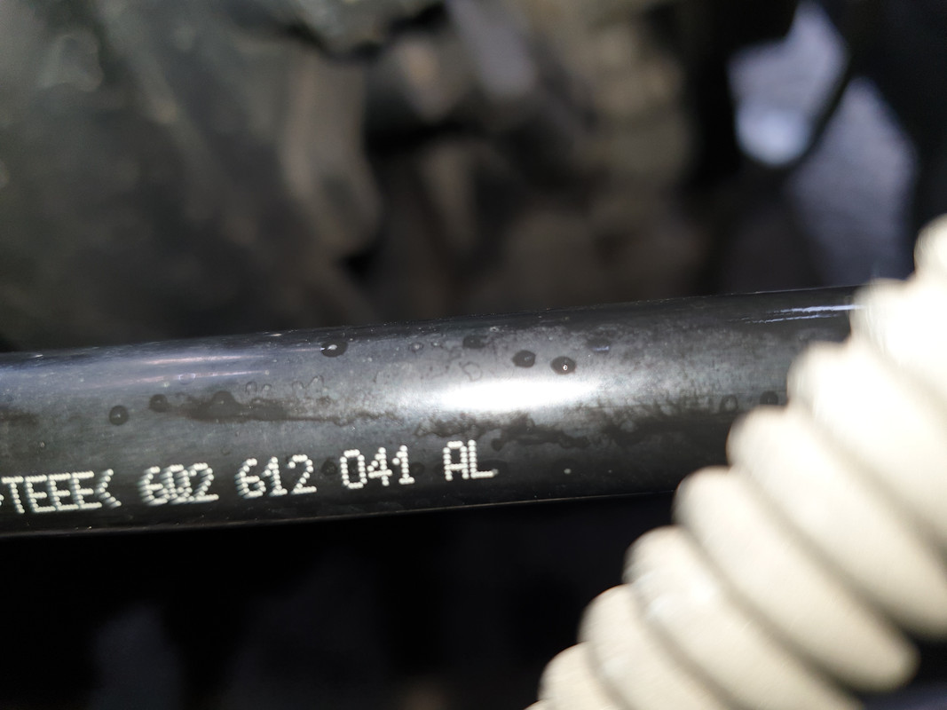

no not changed the pipe yet, the pipe has been like that since i got the car. i have just took pictures of the serial number for the pipe and will order it soon. i have just swapped the coil pack between 1 and 3, cleared all codes then just drove down to shop and back, only a few minutes drive. its very strange because the only code showing now is the gateway: radio.

i will be replacing the servo pipe as soon as i can find some, i am struggling at the moment. i have checked my serial number and it is same as yours:
https://i.postimg.cc/FzB60K0n/20220202-142644.jpg
I think its only available from dealers or TPS (trade only), ask your mechanic to check.
