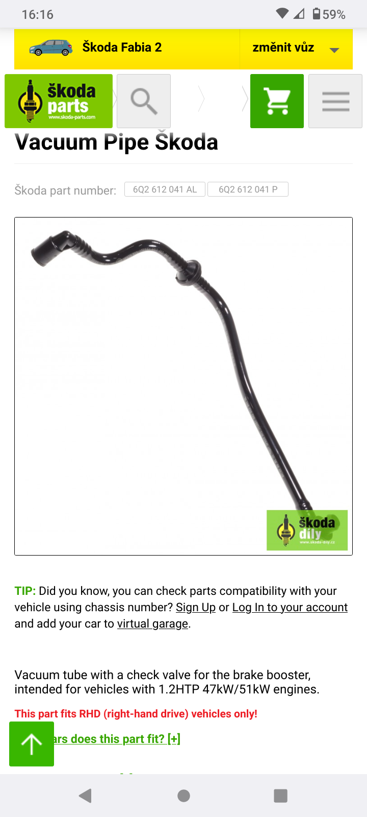

Still a bit concerned why they show a diagram that is not what the part actually looks like. The bends are completely different, It doesn't have a clip at the non return valve and the pipe at the manifold end is a differnt length and shape and doesn't show the integrated manifold connector. Looks like a softish rubber bit that will need a jubilee clip - I recall see a photo of this arrangement somewhere. Looks like I remember my mk1 fabia AZQ looked like or maybe the diagram is for a LHD part which is differnt.
What they show
What it should look like
Mine (BZG engine RHD drive) which agrees with Skoda-parts.com
Edited by xman

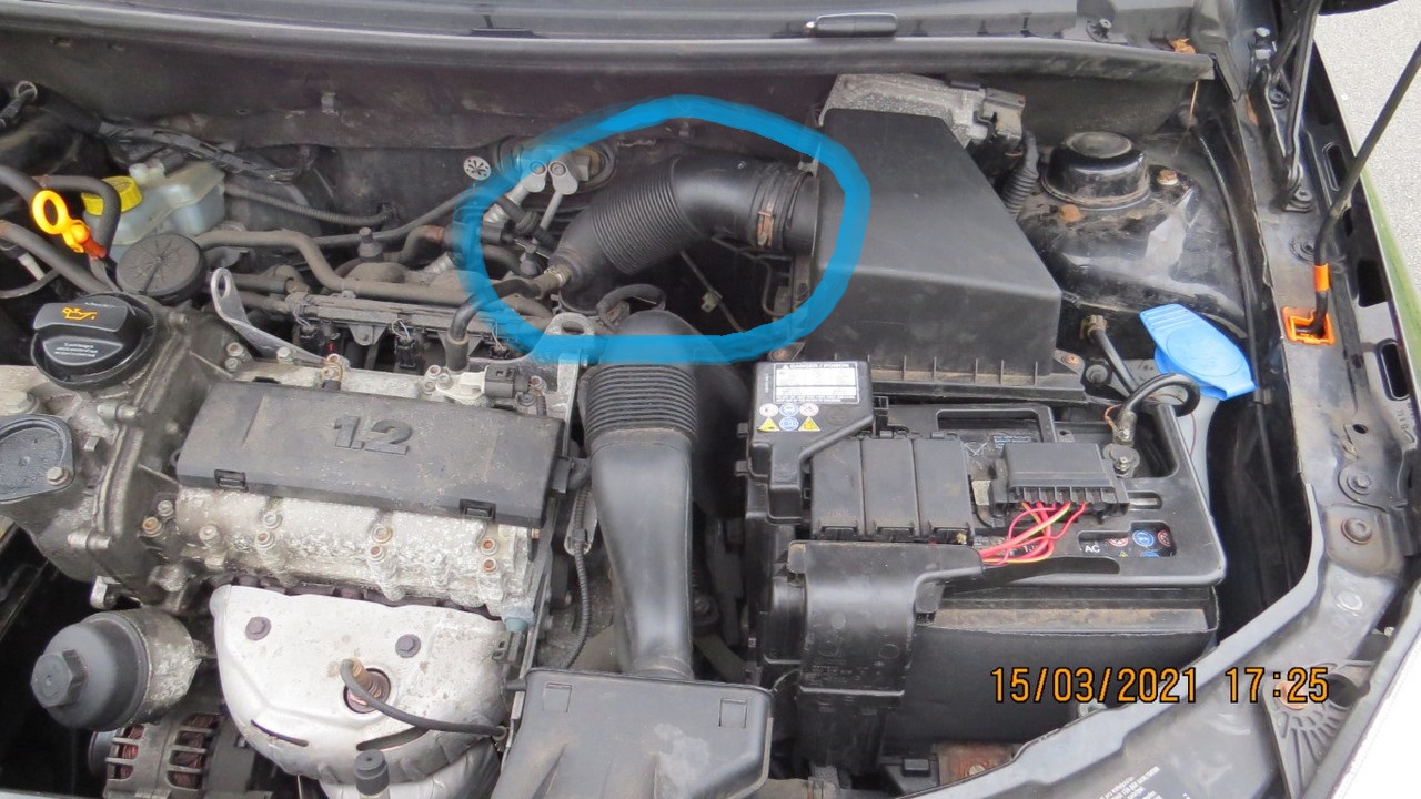

pipe still not turned up yet, so i went to look around the engine bay seeing whatelse i could find, the short pipe from the engine to the air filter snapped clean off. very strange! anyway taped that back up and sealed the best i can.
from what i have read, if the air filter is clogged that could change the fuel/air ratio. is this correct?
Perhaps you might want to put a photo up of that, taping it up might not be the permanent answer.
Think of it this way, the engine as a big air pump connected through other ancient technologies to wheels to perambulate you along, you'd want a clean air filter and inlets to the engine, you are also throwing in petrol so you want the right mixture of both for best results.  The cleaner and les clogged or gummed up all things are generally the better.
Crankcase breather hose IIRC. You'll want to get that replaced ASAP.
i thought that too till i tried googling it, i am almost sure its an intake pipe.
It's in a similar place to mine, with me having the BME engine (the older version of yours, in a way). Regardless, the pipe that goes from the air filter box to the engine itself should be replaced if broken, snapped, or damaged.
