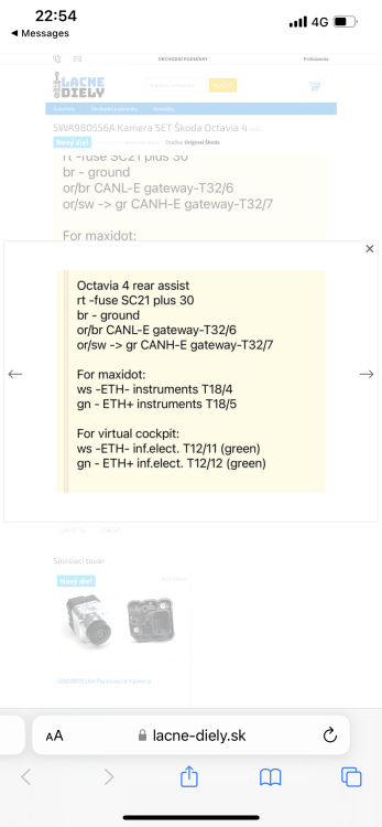

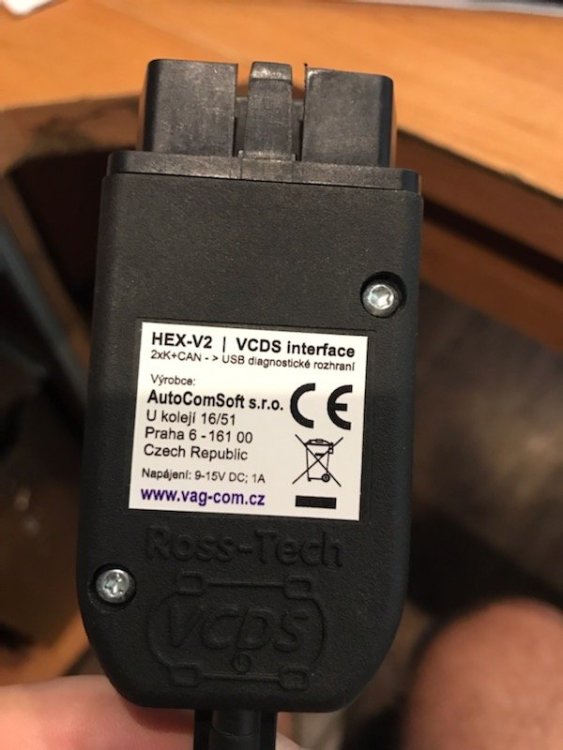

this is how camera was fitted. Also regarding diagnostic system I have this:
I need help with online access, because apparently Skoda cars made after 2020 need to have online access. So in order to make my rear camera working in need someone who has licence with VW concern to do so. Can someone help with this please, I heard this can be done on distance as well.
  • Sponsor
We can't help you with VCDS alone sorry. You need access to a VAS6154/6154A
The wiring you've put a screenshot of doesn't mention the camera at all. Where have you wired the camera to?
