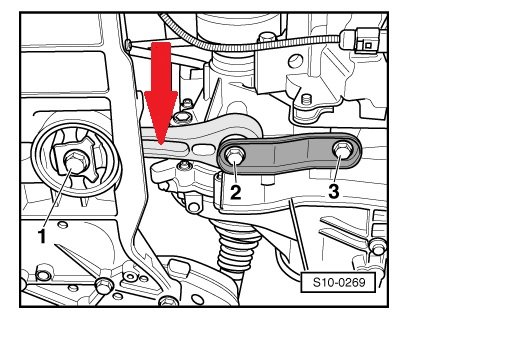

What I would suggest is the clonk is from the rear lower "dog bone" engine mounting, it clonks when you change direction as the weight of the engine shifts backwards or forwards, often happens when hitting the brakes as well.
Edited by UrbanPanzer

just incase you was not sure what I meant earlier, and ideally before you take it anywhere, check the item below, I am confident thats your guilty part.
You may be able to check that simply by pushing/pulling the top of the engine to the back front and listen for the clunk.

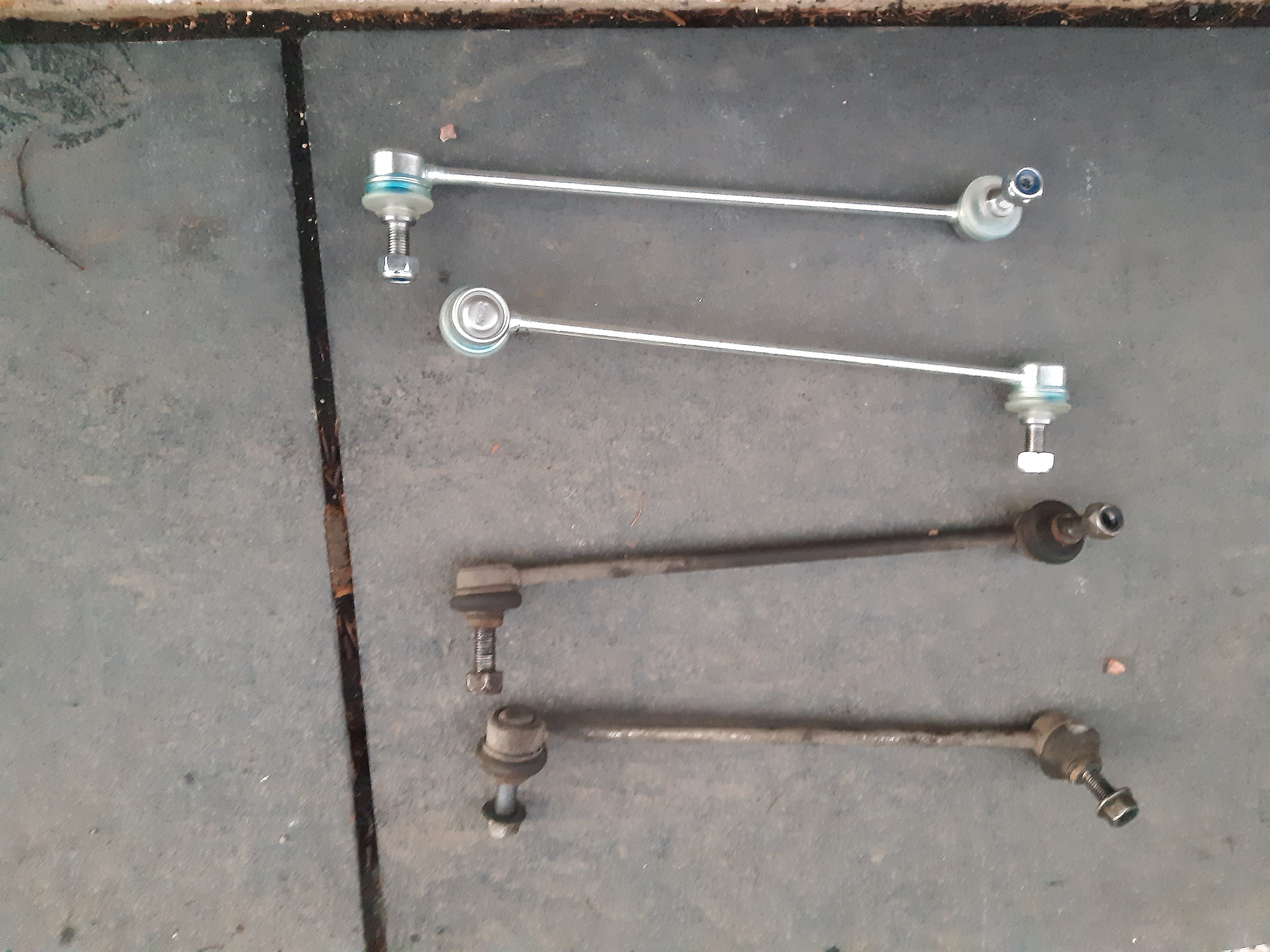

As already suggested check the anti roll bar linkages they wear out for a pass time right across the VW / Skoda range and can get quite noisy. Not 20220113_154558.thumb.jpg.4543fc481339344d99b5bdc3673af8d1.jpg20220113_162744.thumb.jpg.cd0880fffb92b4f597a43f4d0ee0d716.jpgy expensive either.
Just taken it out and had a look. Doesn't seem to bad. It hasn't gone hard and stiff has plenty of movement

I've just put the dog bone mount back in but took up some more slack in the front bolt and it seems to have worked the forward and backwards clunking has gone 🤞🏻 I guess only time will tell now 😂. Thanks guys for all your help and suggestions. Going forward I'm still going to change out the inner tie rods, they're just too loose for my liking anyway plus I have new ones at hand.
