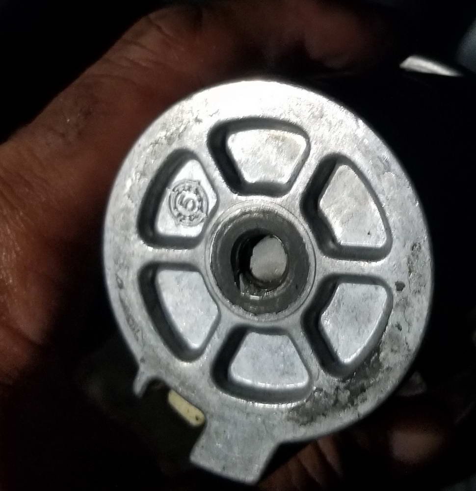

I was in a road trip with friends when suddenly  the battery light came up, it is a new alternator with less than 20k km on it so what could be? when i open the hod, i see the belt out of its place and a belt tensioner misplaced, i pick it up and saw this:

Once in home i did remove the broken screw and replace it with a better grade steel (the one broken was the factory one.
I did 3 road trips more, and yesterday i was 270km away from home and when returning, the battery light came up again....
i said, no!, again?
when i lift up the hood, the same situation, and yes, a broken screw...
i drive 240kms back to home with battery..., yes, incredible.
What is going on with that screw?

Sounds like something could be suddenly jamming up causing the belt to put a shock load onto the tensioner. Or there could be excessive vibration of the tensioner which is causing the bolt to weaken and snap. Maybe the new alternator is causing it as I think they have some kind of clutched pulley on them? Could even be A/C compressor related if it has A/C.

Replace the entire tensioner assembly.
But i got that one new from the house 9 months ago.

Replace the whole tensioner and not just the bolt and above all replace the alternator pulley sprag clutch, it is this that is causing the problem.
Well that is not actually true, the problem is the acceleration/decellerations at idling speed and the inertia of the heavy alternator, without the one way clutch the belt will be snapping backwards and on the tensioner.
It sounds like either the bearing was not checked/replaced with the alternator or my money is that an alternator has been fitted which does not have the sprag clutch.
I'm surprised you have not complained of a chirping noise.

i think i found the cause, i found in the manual that screw must be tighten to just 25 nm, that is about 18foot pound.
i know how mechanics in my country are, I AM 100% sure they tighten that to at least 40nm, and the second time i put the screw, i recognize i put lot of effort to tighten it, and 18foot pound is not that much.
