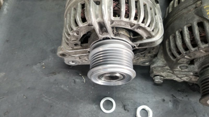

Alternator rotation is clockwise as viewed from the pulley end.
Alright, this is the one i got, it is a new one, Bosch, OAP, i wanted OAD 😩.
Is it interchangeable, does it fit your shaft?
You have no need for an OAD shaft unless you have an alternator like a power station turbine.
You have no need for an OAD shaft unless you have an alternator like a power station yes, it is interchangeable

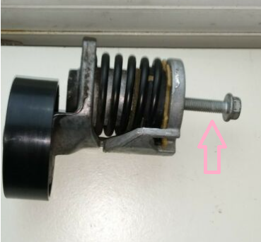

@Kharl your location shows as Caribbean but I cannot remember where you and the car actually are, or know where the car might have originally been from.  Could it be that different bolt/setscrews lengths or fixings are for different applications perhaps of accessories or for different market areas/regions of the world.  Looking at diagrams from Europe or UK ( and right hand drive) may not fully relate to another area/region of the world.
The bolts/setscrews originally referred to were not only different lengths but also thickness. -
It should be easy to check if it's a M8 or M10 thickness and that then gives the length required if the above information is correct.
As for how 18 foot pounds feels it depends on a lot of things, the fixings, conditions, positions, lever length, muscle power, with a correct length spanner with the setscrew in an awkward to get at location you might be surprised how near to the 18 foot pound you might have got - using additional leverage or mechanics' forearms are a different matter.
An update on this;
None of those are the right bolt.
The right one is about 53 to 50mm.

At least now you know.  Try to get one exactly the same if you can, have a look at a site that gives you the information on how the bolts are measured and if there are any other fixings with the bolt reuse them or replace with same.  Normally a bolt is just a bolt but 53mm isn't an everyday length and you may need the correct strength of bolt.
Perhaps a photo, and any markings on it, I sure there will be bolt experts about, I am not one of them.

Is it actually a bolt, or is it a set screw? There is a difference, and an important one if it's what the pulley rotates on.
You are on shaky ground there, I've seen debate on this before.
You probably mean is there an unthreaded section at the head end (blind shank).
Edited by nta16

I think this one:
Setscrew = threaded entire length
Bolt = partially unthreaded
Semantics.
What it needs its a bolt, but i only got a screw

Is it the one I showed above that we have been discussing this whole time?
21 hours ago, sepulchrave said:
Semantics
Totally agree, but you can get different interpretations including what type the head (can) will be on either and it depends on previous training or locality, Kharl has confirmed his is the popular understanding.
Now to confirm bolt (screw at the moment) perhaps and it's actual location.
yes, but i was unable to get it, only a fully threaded
