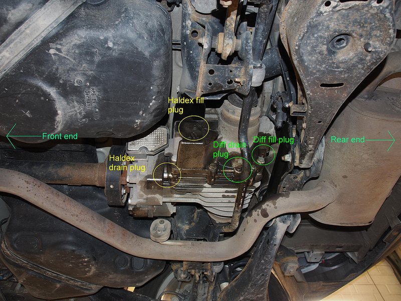

You fill the haldex till some oil starts to drip, put the fill plug and start the engine for 1-2 minutes to prime the pump. Then you remove the plug and add 100-150ml until again oil starts to drip(you can prime the pump with VCDS as well).
By gear oil you mean diff oil I guess? Diff requires 1-1.1 liters of oil. Again needs to be filled until oil starts to drip.
it’s strange that it happens after 15 mins of drive and not before that. Oil “expands” a little when it reaches operating temp, but it’s really unnoticeable with these amounts..
Maybe you confused the haldex and diff fill holes because they are next to each other. Not sure..

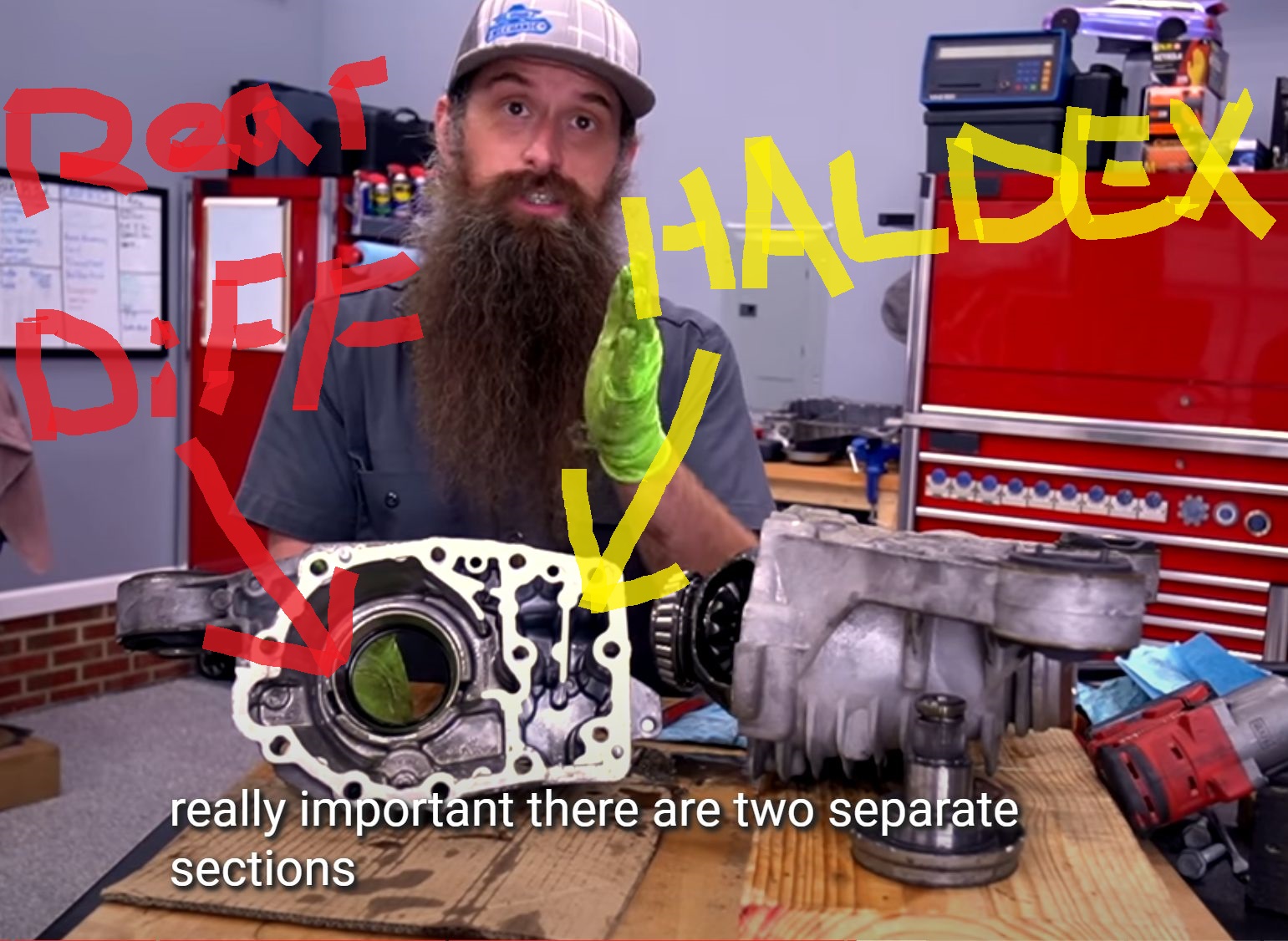

So when I watched videos how they dismantled this differential unit I can see that space in haldex is smaller and in diff is much bigger so I presume that it needs at least 2.5 litres of gear oil ?

I don't know if u watched videos but you clearly must be bind or have eye sight issue
Clearly rear diff chamber inside is enormous compare to haldex chamber.. SO I think your knowledge is on point of freeziness :)
I am blind in one eye and have sight issues in the other, had catarct surgery at the end of march followed by retinal inflammation, no sooner had that been treated then I was struck with Orbital Cellulitus and in intensive care for a week with 3 days of total blindness.
So in that regard I admire your deduction skills!
The volume containing the component bears no relation to the amount of lubricant it will require.
The Haldex system is a hydraulic pump operating an actuator to clamp up or release a multi-disc clutch, the fluid has to also act as a lubricant and coolant for the heat generated in partial slip conditions, 95% of the driving cycle.
The differential is very compared to any standard differential as its reduction ratio is one third of that of a normal FWD or RWD vehicle, it also does a lot less work as it only transmits a fraction of the vehicles tractive force for a small percentage of the time, it works by splash lubrication and only requires the oil level to be above the bottom of the crown wheel which is significantly smaller in diameter to a standard differential.
Using your logic the volume of the engine exposed to the oil system, the crankcase and cylinder head volume etc being  larger than the volume of the cooling system means an engine should have a larger quantity of oil in litres than it does of coolant.
Comparing Haldex fluid to hypoid gear oil is like comparing engine oil to coolant.

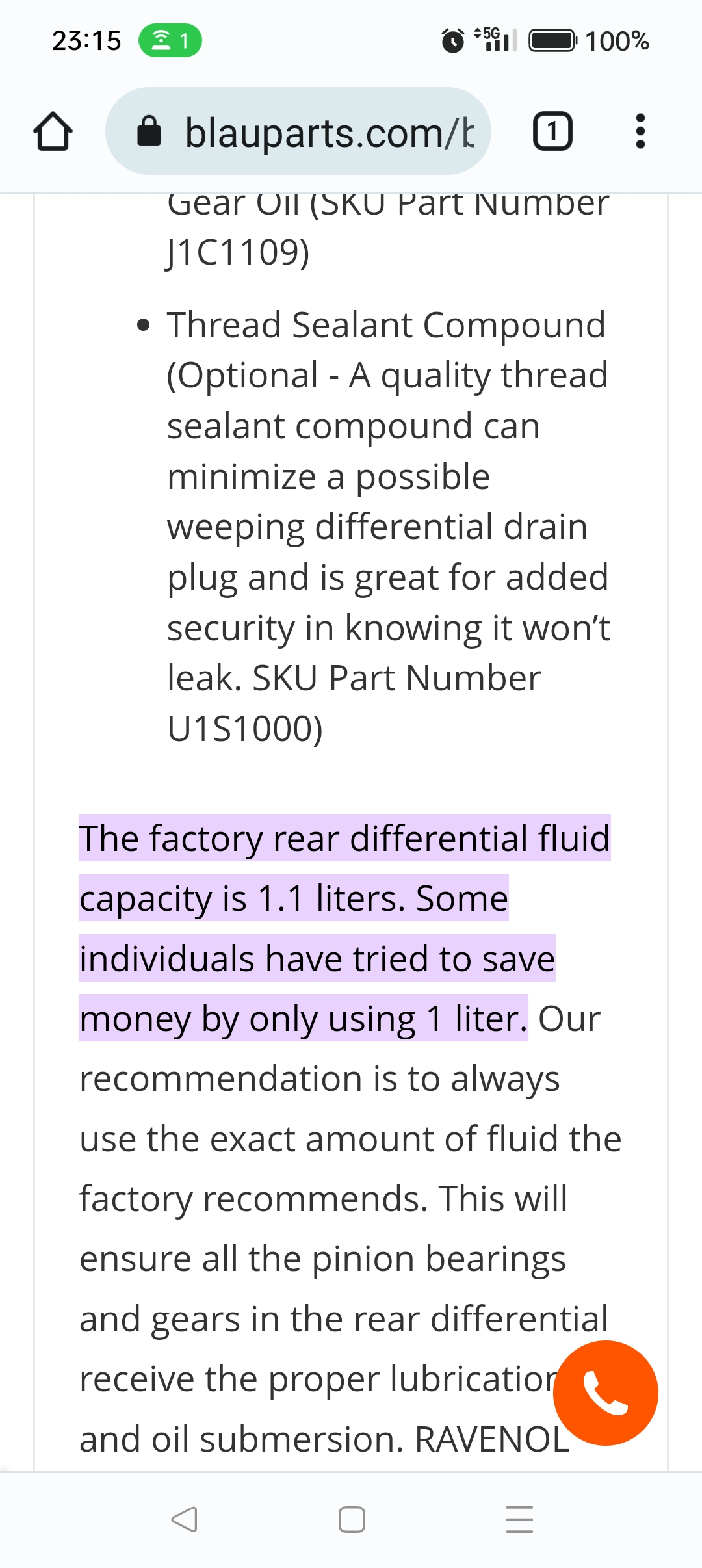

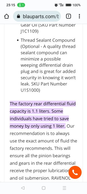

So looks like it is 1.1L  so I filled enough ...🤷‍♂️  That means mine bearing in differential is fcked as well and will need replacing
https://www.blauparts.com/blog/how-to-change-audi-rear-differential-fluid-b8.html#:~:text=The factory rear differential fluid,by only using 1 liter.
