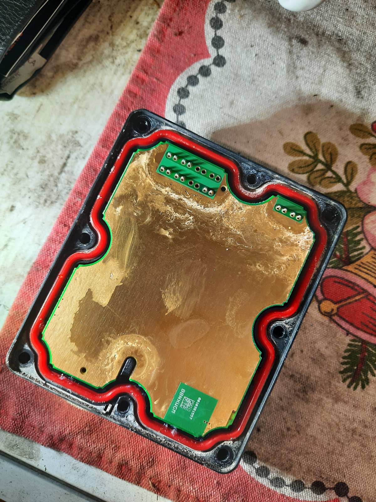

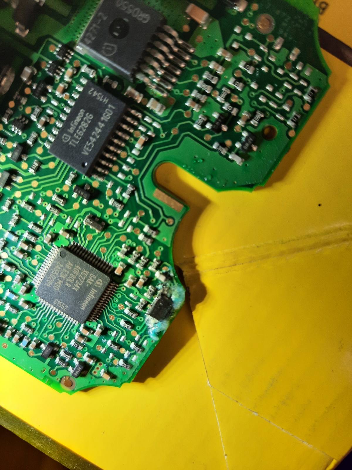

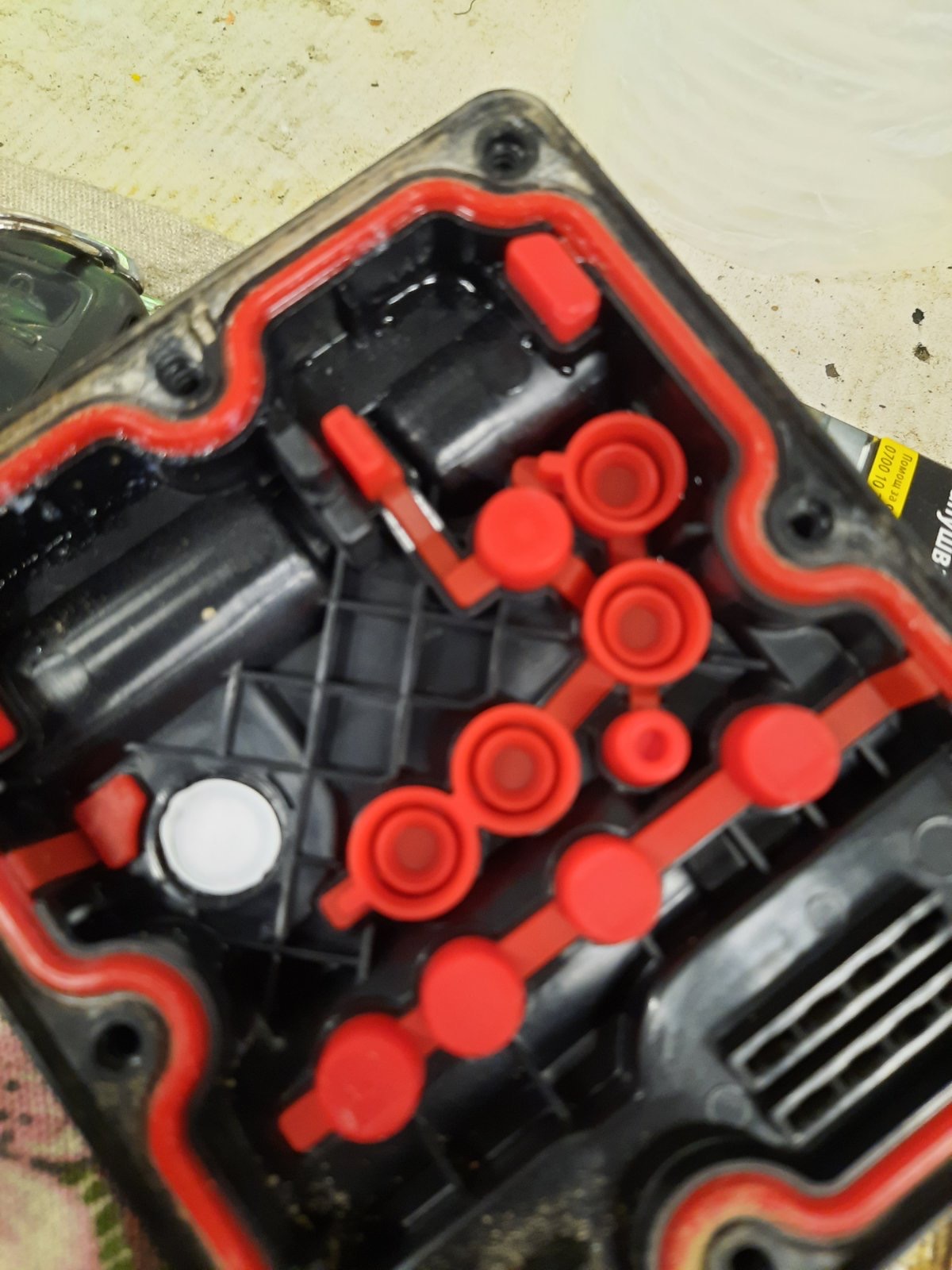

An update from my side:
- A friend of mine left the car to the local garage and they read the errors first( I forgot to mention that car also had shown ESP error on the dash last time I drove it)
- The error appeared to be triggered by communication issue with the ABS module which seem to be caused by water inside the module.. Neither diff repair shop or local garage had water cleaned the diff, but honestly speaking this car has seen a lot of snow, water and mud.. I bought Scout for this after all :) I’m going with it for skiing and mountains for camping.
- The noise from the suspension will be tracked in the next couple of days, but as you guys suspected initially, it seems that something is loose, or got loose during the alignment.
- I’m attaching pics from the wet ABS module chip.. I will call different places which repair such modules and provide some warranty.
Do you not mean the Haldex controller?
Yes, I was sleeping I guess.. The AWD module, not ABS.. the one with p/n 0CQ 907 554 H
I was wondering why no similar issues appeared in google when I searched for it :)

But the AWD control module itself is not serviceable - it’s a simple metal box with a chip inside, which if not sealed properly from the factory, does such issues.. 😕
There is a place in my city Sofia where some guys repair ABS modules. They said to send my AWD module to them to check can it be repaired or not.
0CQ 907 554 H is my module P/N. And I found that it’s superseded by newer version 0CQ 907 554 J. If someone has access to such data and can confirm this, would be really great 🙏
Ok, I called the skoda dealer today, 0CQ 907 554 H is superseded by 0CQ 907 554 J and is ~€550.
Mine is already sent for repair but if the guys who are about to do it said it’s not possible, I will buy one. That price isn’t that bad for a brand new module.
