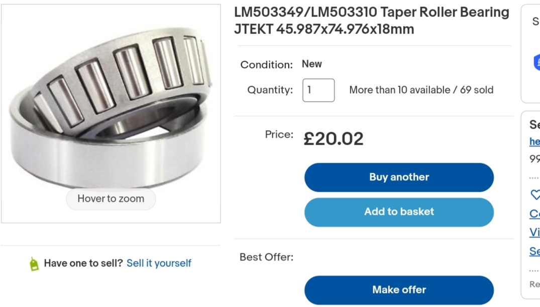

How did you find the dimensions of the bearing?
Its what I have been trying to find for a very long time, if I had the old bearing in my hand it would be easy for me to find the reference but with the dimensions I can order it in advance if you are confident of them, thats why I asked where you found the details/dimensions/reference number.
20 minutes ago, Username_Login said:
I will probably give it to local mechanic to replace or rebuild
Yes but the labour charge will be but a tiny fraction if he is able to do it in situ, with his ramp it will be even easier.
Also many less things to be disturbed and removed which might cause problems or break like the exhaust, propshaft centre bearing, drive coupling, engine mounts, subframe mounts, brake pipes etc etc.
Edited by J.R.
Googled and it was here
It took me couple of minutes

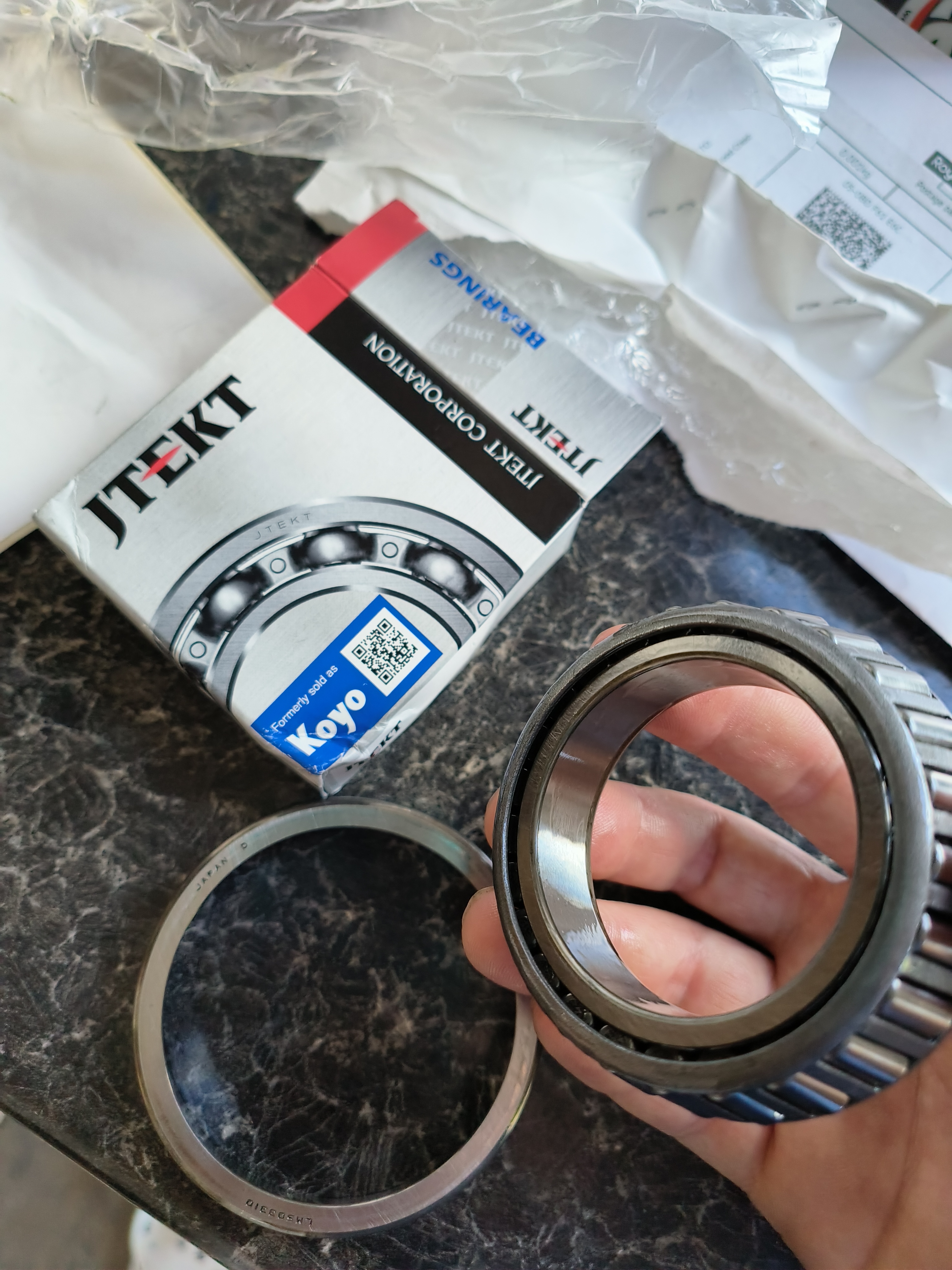

Hey guyyz received bearing
But I was surprised it is so small ?? Is it right size ? 🤷‍♂️

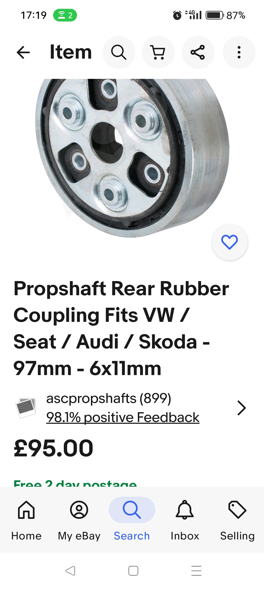

Hey guys an update from my side, I picked my car after the diff bearing was changed, new diff and haldex oils, new drive shaft coupling as well and the noise is gone! 🥳
That coupling made the bill a bit more than I expected but I know from the forum that it’s a common think to fail on these cars.

What u mean  drive shaft coupling ?
What did they rebuild on your diff ? bearing only one ?
Yes, I think it's called drive shaft coupling. And in the diff only that roller bearing I wrote about earlier.

It says “rear rubber shaft coupling” on the bill and it’s €265..

That means then this unit been replaced  it cost almost £100 so maybe they didn't rip you off they charged themselves £150 for work
