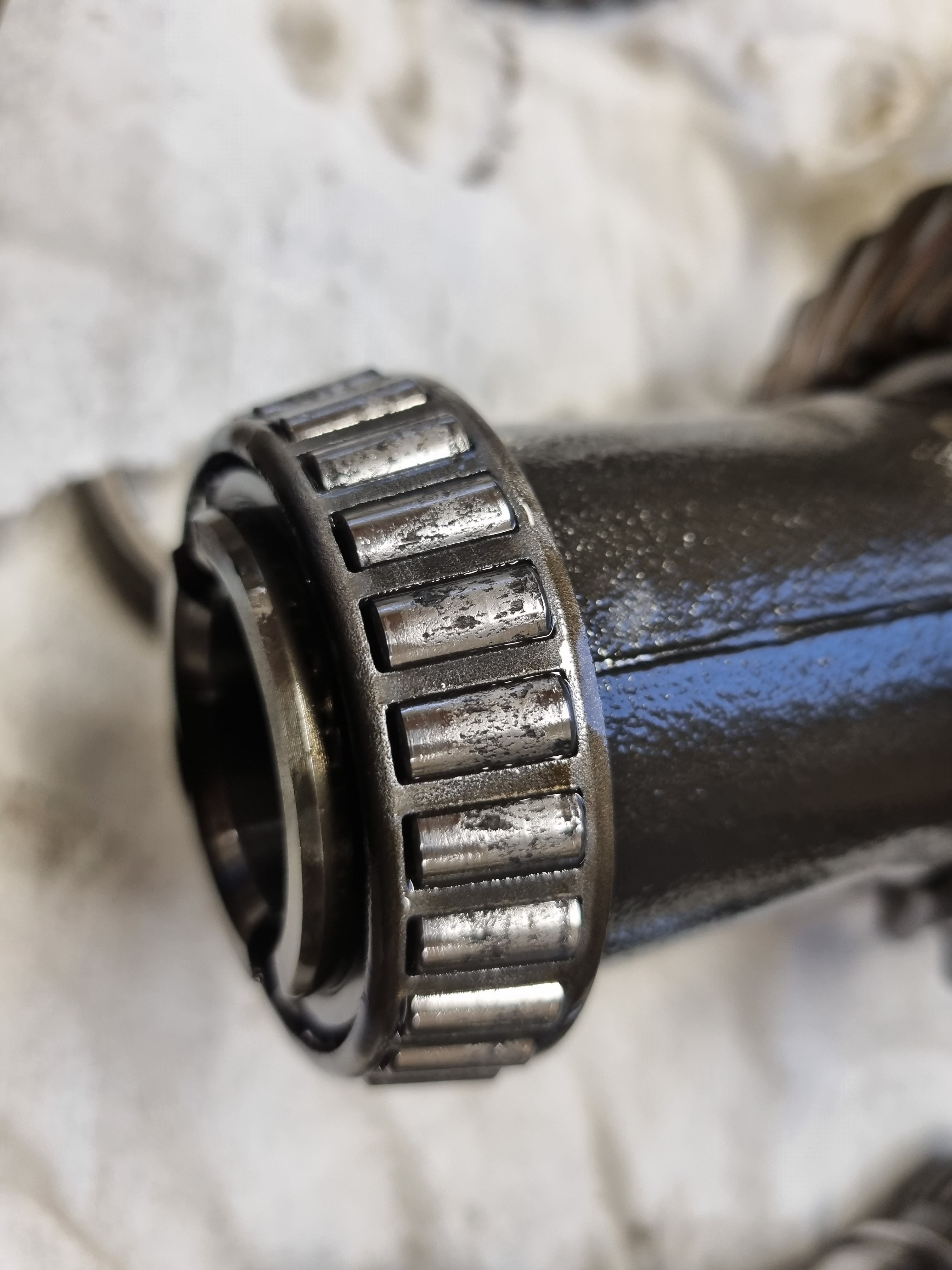

* The tapered roller bearing in the diff was worn out. The rest of the bearings had no signs of wear.
* I believe that each bearing in the diff has its part number, so if somebody else is in this situation, remove it first and check your P/N. Mine was LM503349.

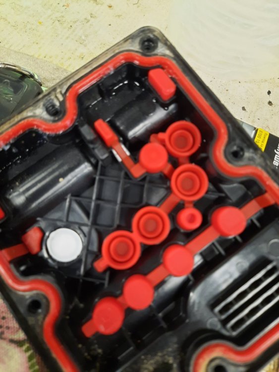

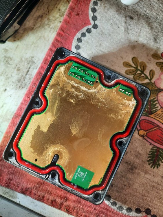

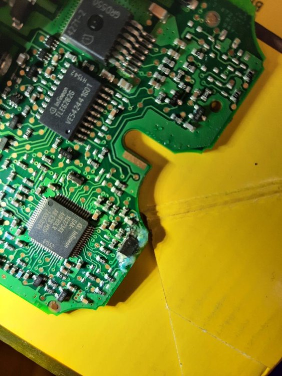

* The AWD module( 0CQ 907 554 H ) had issues with its sealing which caused water to enter inside partially damage it. Thankfully was repaired by electronics workshop and sealed back with new durable silicon.

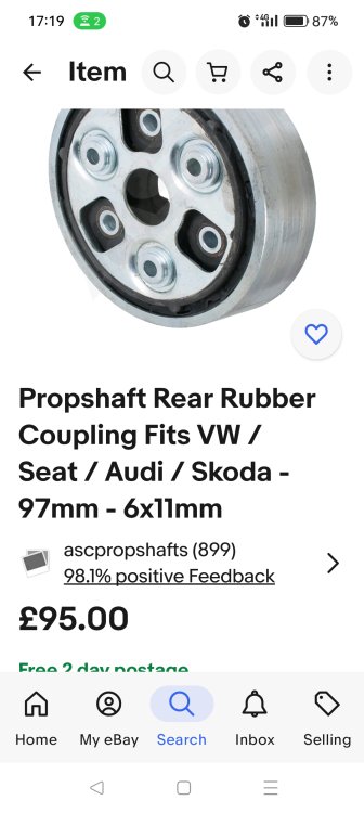

Update from me. I paid Pilbeam (Hailsham, Sussex) about £1100 and they took out my rear diff. Car sat for two weeks or so at their yard whilst Bexhill Gearboxes serviced the diff (they fitted one new bearing I believe, and the £380 they charged was in the Pilbeam invoice). Pilbeam put it all back together again. Bill included fitting a new coupling (which I bought from Autodoc for £140 I think). Car is now quiet and going well (although I still have my issue, see another thread, with my lurching/eccentric sensation at ~1700rpm in third, ~1600 in fourth, and odd at other times – car booked in to Diplocks Injectors, Hailsham on 15th to check fuel delivery system). Diff fixed £1250  :O)

I highly recommend you to change also the rear driveshaft coupling if it hasn’t been changed already. I don’t have P/N on the invoice but I think it’s 5Q0521307.
