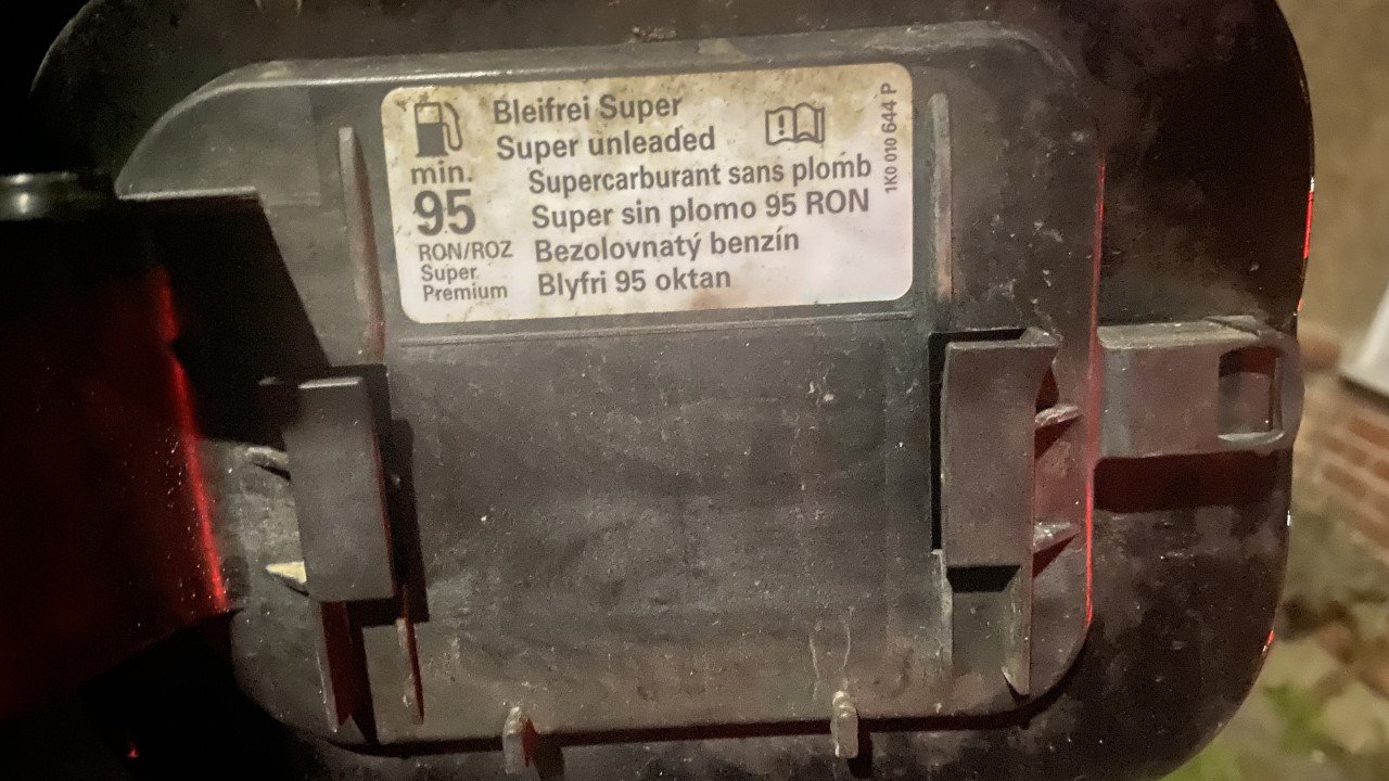

Driving back from the VolksWorld show today, I had the indication on the dashboard of a loss of pressure in one of the tyres.
I measured all 4 tyres, Three of them had 29.5 PSi, and one with 29 PSi. I topped up the 0.5 PSi and reset the TPMS.
However I have no idea what the correct tyre pressure should be.There is no sticker inside the fuel flap, and the manual doesn't have this information.
Can anyone advise please? The tyres size are: 225/35/19.

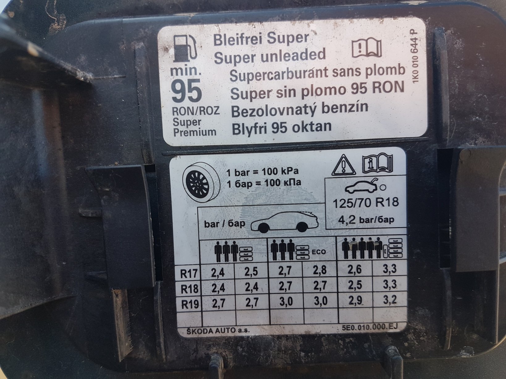

My 2016 VRS estate TDI shows this in the fuel flap...
Here is the information inside my fuel flap, very much the same information as the one steelyboy posted.
As above they should be 2.7 bar for normal use which is about 39 psi. So your tyres are 10psi too low! The pressures are generally higher with lower profile tyres to help support the tyre wall and to try and prevent pot hole damage etc

OMG Thank you for pointing that out. This means that I have been driving around for the past 12 months (around 6,000 miles) with low tyre pressure!
The dealer should have really checked this before selling the car. First thing I'm doing tomorrow is pumping all the tyres up to 39 PSi. Thank you!

It's odd, I have the fuel sticker, but not the tyre pressures. I can make out the outline of where the sticker used to be, so maybe it's just come off. Possibly when the ice scraper has been used previously?
I'll try and get hold of a replacement sticker. Thanks.
