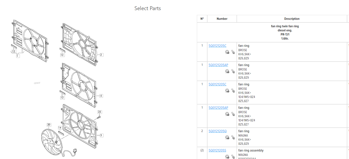

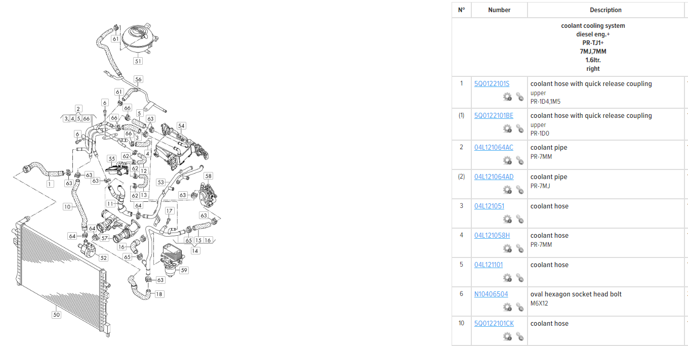

Just from a cursory glance of some online parts catalogues, there certainly are differences between standard (1D0) and towbar fitted/prep'ed (1D4/1D7/1M5) cars.
For example, there are some different hoses and fan configurations for the 1.6TDi Octavia seemingly based on the above PR codes:
I'd expect something similar for the Superb with the same engine. Obviously that's not to say all models need upgraded cooling, only that some might depending on the conditions their being used in :)
