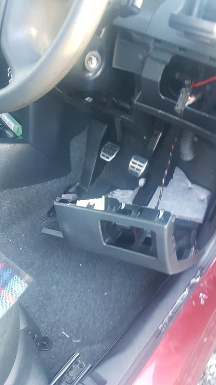

To take it out:
  • Drop lower dash panel for easier access (guides available online)
  • Find connector to pedal and unplug.
  • Remove bolts holding it in.
  • Comes out as one unit, pedal and all.
^ like this, but maybe a bit neater.

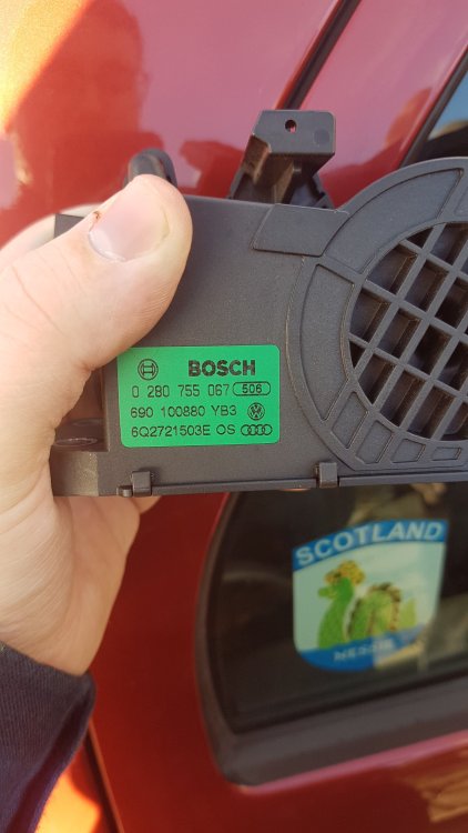

This was the part number for my pedal. I don't know if yours will be the same though. The part number is up at the top of the unit.

Hi Pentium, Thanks for the pictorial, will be handy. The vag 'Q' numbers are all the same, but, the letter at the end are different?? So it's got to come out!
Happy to have been of help. You're definitely best playing it safe and taking it out to be sure of the number. I just put that number into eBay then sorted the page by price in ascending order and bought the cheapest one. It's still working (touch wood). :)

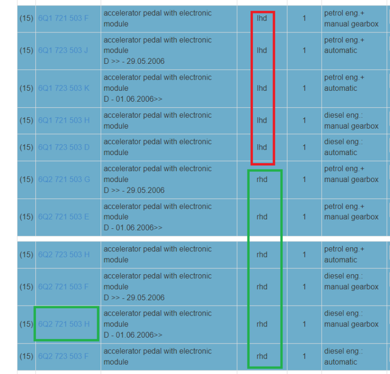

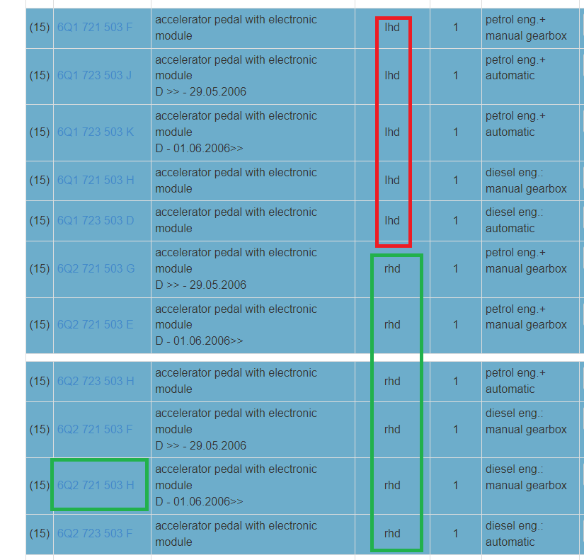

It's possible the letter at the end denotes LHD or RHD.
  • Sponsor
2006 ETKA page relevantly cropped and highlighted. 3rd digit is what differentiates LHD/RHD, various other different characters for petrol/diesel/automatic/manual.
I suspect a 56-plate vRS is going to have the 6Q2721503H variant, penultimate in list of '15' s.
Many thanks for that info Pete, and the time you put in finding it. I've actually got EKTA site bookmarked BUT most of the time I can't get my head around it lol.
