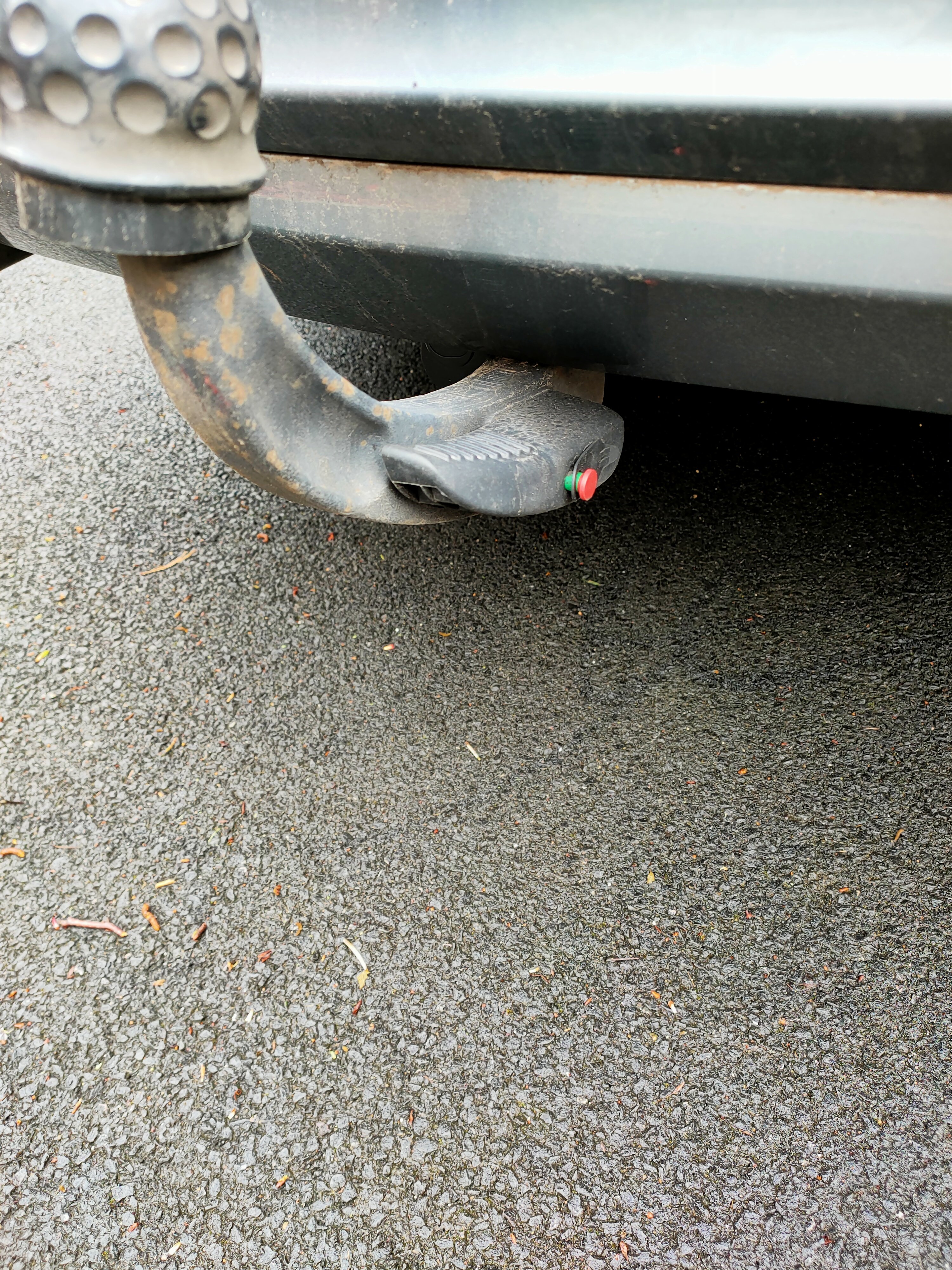

The car didn't come with the key to remove this, I've scoured the site and can see that westfalia made these and the only way to find the right key is to take it to westfalia and get them to try every key on their master set - at a handsome sum of £. I thought I would double check that is still the case before I unbolt the whole thing?IMG20220413114809.thumb.jpg.6b3493238f4bea1b8f4e67e84d2e167a.jpg I may use it in the future but not needed right now.

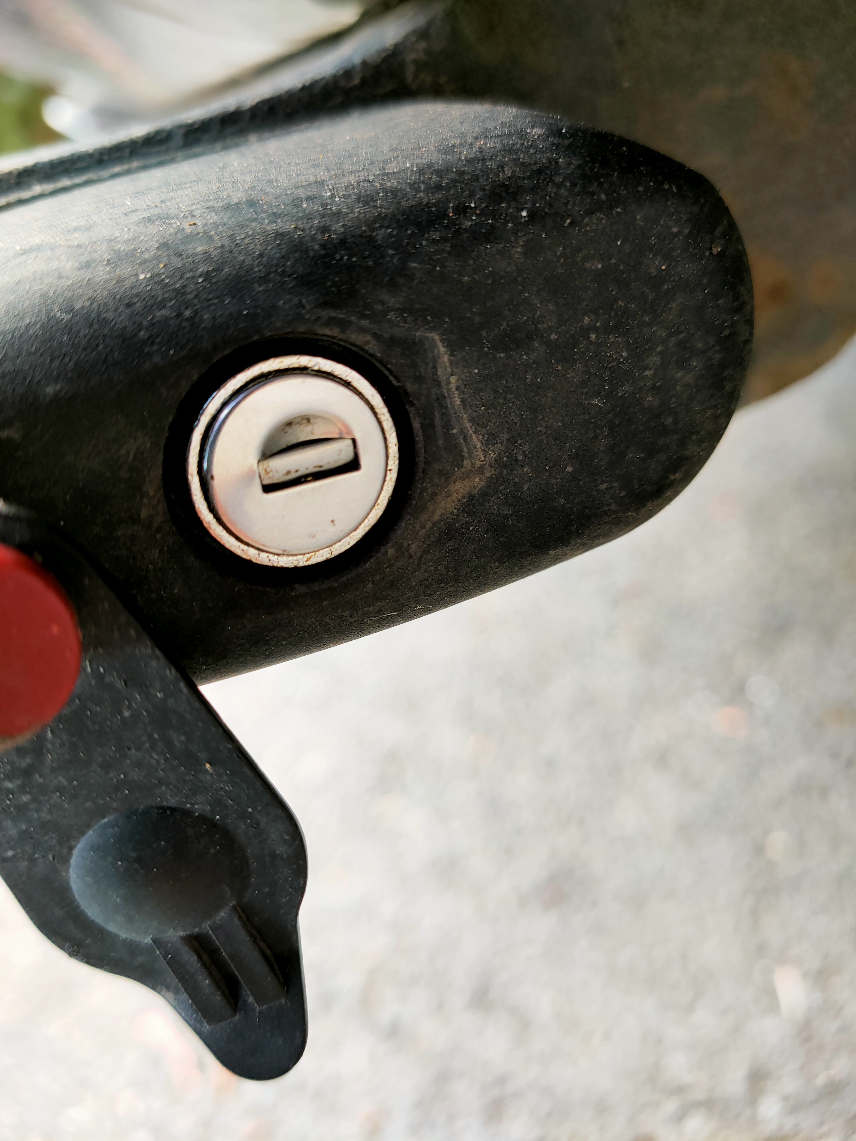

There is definitely no number on the barrel of the lock...it's clear.
From what research I had done (it's hard to find ones that look like mine) I thought it was a westfalia...but I could be wrong if you guys are saying otherwise...

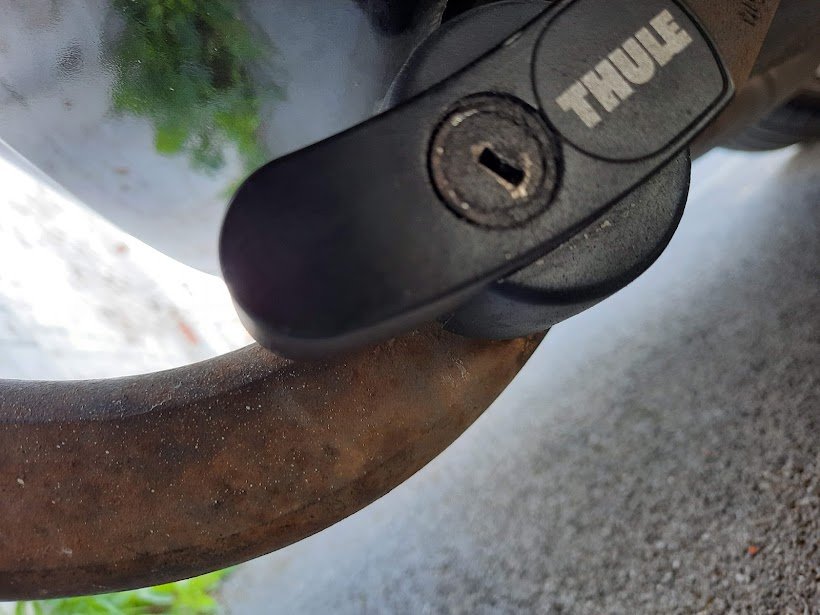

If it's a Thule or Brink then again the number should be stamped on the barrell.
It took a lot of cleaning and scraping to see the number on mine.

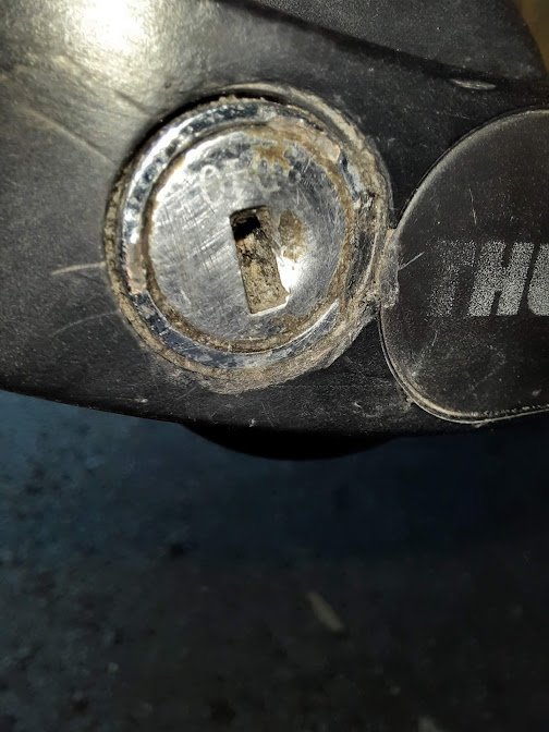

This is what it started out like.
After a lot of scraping, it was only just visible.
IMG20220413163349.thumb.jpg.24c408ad357c63e1e6586d8b09463a66.jpgit is clear and shiny, no signs of anything ever being on there unfortunately.

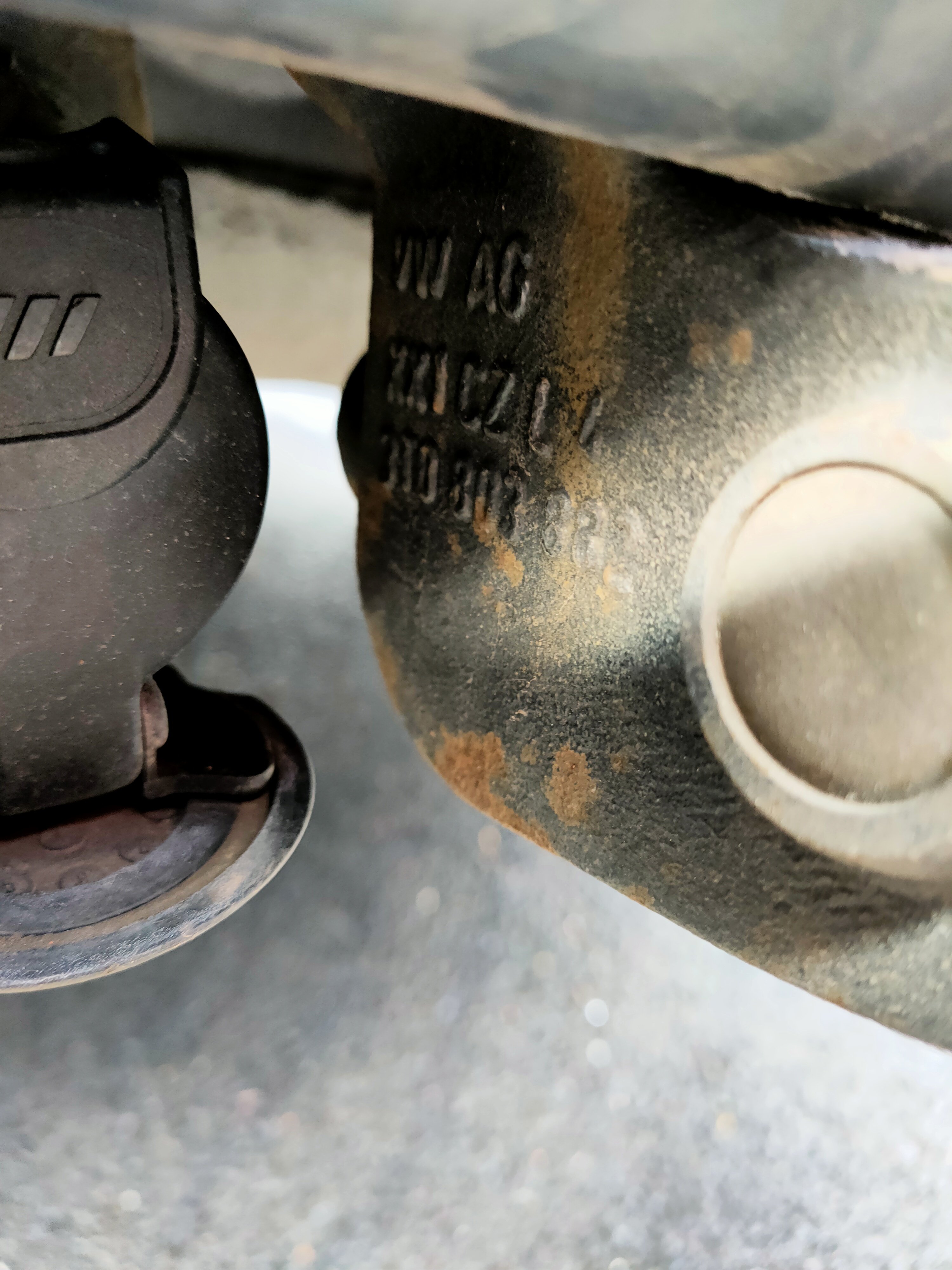

There are some numbers on the actual neck of the bar, but mean nothing to me and assume they won't correspond with the barrel anyway.

Also looking at your original picture, does the red/ green button need to be pressed in at the same time as turning the lever?
