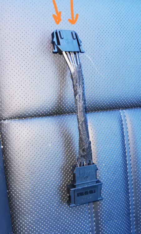

I did it! Take out the connector, turn it around, file down the tabs, plug it in again. 5 minutes work makes a whole lot of difference for the sound.
Just to think that the previous owner drove this car for 169.000km without this 5 minutes fix 😂

Hey guys, sorry missed your postings as I'm very rare in this forum.
Great to see you applied the solution. The connectors are for those who don't want to modify anything irreversible or mess around with pins.

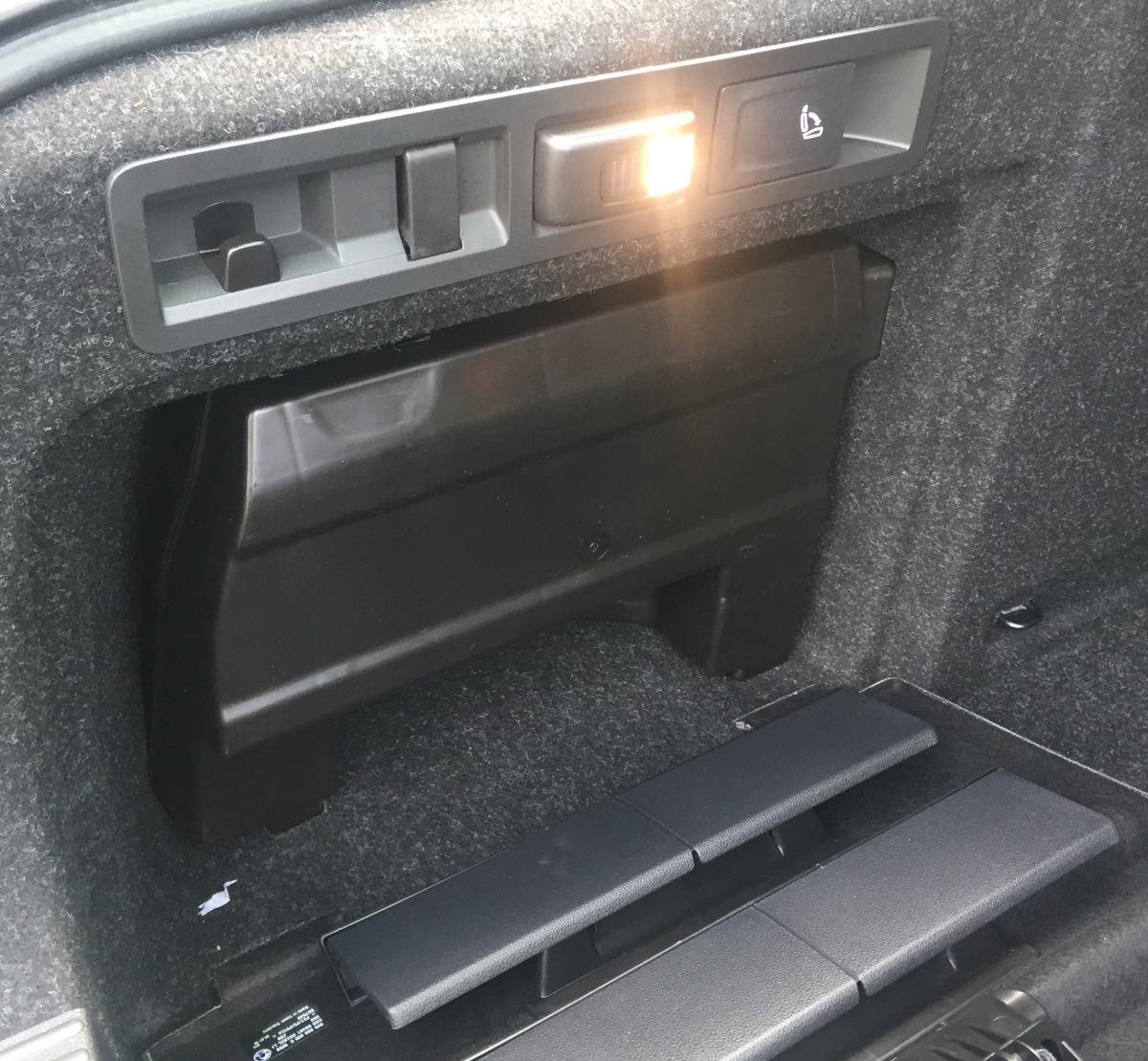

On 16/07/2025 at 16:30, Kirill said:
WOW......Skoda have really gone cheap and downgraded the sub in the Canton system for the facelift Superb!!!
no wonder many peeps of the facelift Superb r not impressed with Canton system.
the pre-facelift occupies the entire storage cubby space on the left of the boot, and is ported into the chassis frame, so u can feel a nice deep and solid base from the sub-woofer.

The topic is about hybrid. It's another solution

On 28/04/2022 at 17:55, spacelord said:
those are the noses which have to be removed in order to be able to turn the plug
