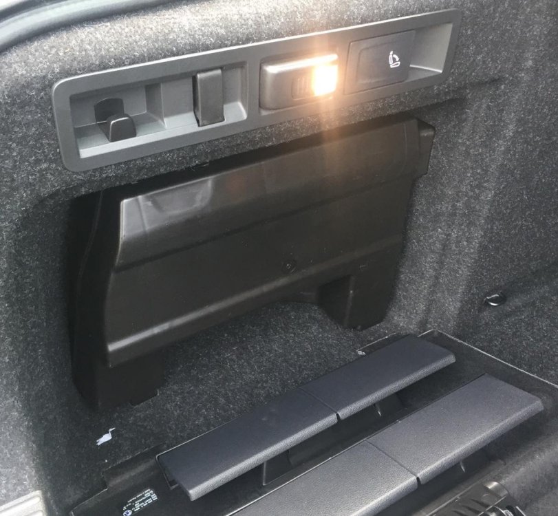

Where is this connector?
I fancy having a look at mine and seeing if I can swap the cables round without ripping the car to  its!
On the sub
So is that all the side of the boot having to come off to access it?
Drop the back seat and lift the carpet next to the seat to reveal the worlds smallest and crapest sub

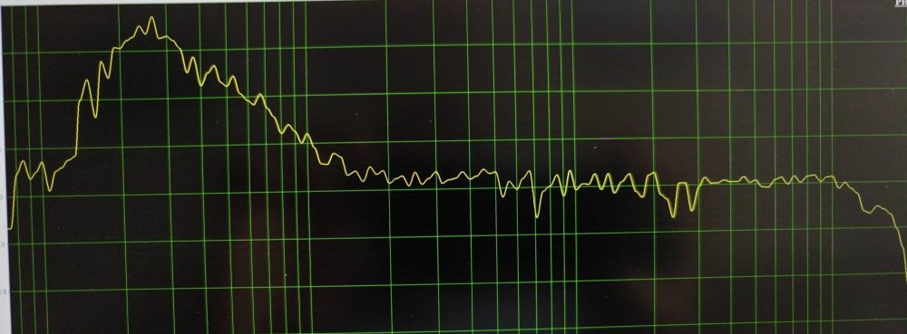

I already have C-DSP with 8 output channels ready to go (was waiting for the car to be fixed from the AAC problems... ). Set up some basic XO the other day and some simple routing to prove it works. I was just very surprised to hear the difference and can now understand why some people are really impressed with the Canton. It sounds okay like that, a reasonable amount of bass that drops to an OK level, but imaging is awful and tonality... no, thanks.
I intend to use cabin gain fully with a sealed box of around 30l, 20kg and a 10" sub running off around 1kW :)  Going to clip it in with some hardware to make sure it doesn't move too much. Highpass is set to 10Hz @ 24dB/Oct so I don't shake things too much.
Someone commented once you can "model" Cabin Gain using a Linkwitz transform with a q of 0.707 from the cabin frequency down (so the half wave length that will fit) down to 20Hz. I feel that's pretty close but I don't trust my mic that low. Too small of a membrane.
343/length in metres x2 should give you the frequency where it starts. For the A2 that calculated to around 57Hz, and I figure with the Kodiaq it's going to be closer to 45Hz.
Adding in a little "hump" at 60-70Hz is another trick to use to make it feel like there's way more bass than there actually is. I will be aiming for "close to flat" :)
A hump at 60-70 Hz produces a very boomy bass. I'd try to get the frequency response flat down to 200hz and start steadily rising with peak at 20-25hz
Like this below. My current setup winning last Hifi competition
