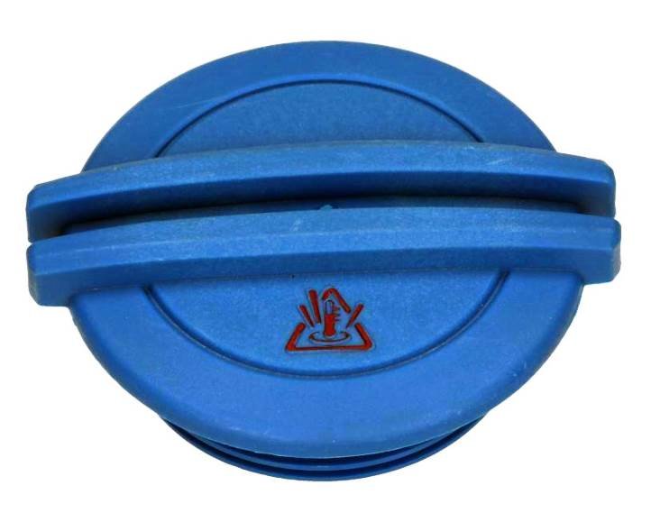

See photos below if your coolant bottle looks like the one below then the other photo is the type of cap you want, note the G12 marking and image telling you to refer to your Owner's Manual.
