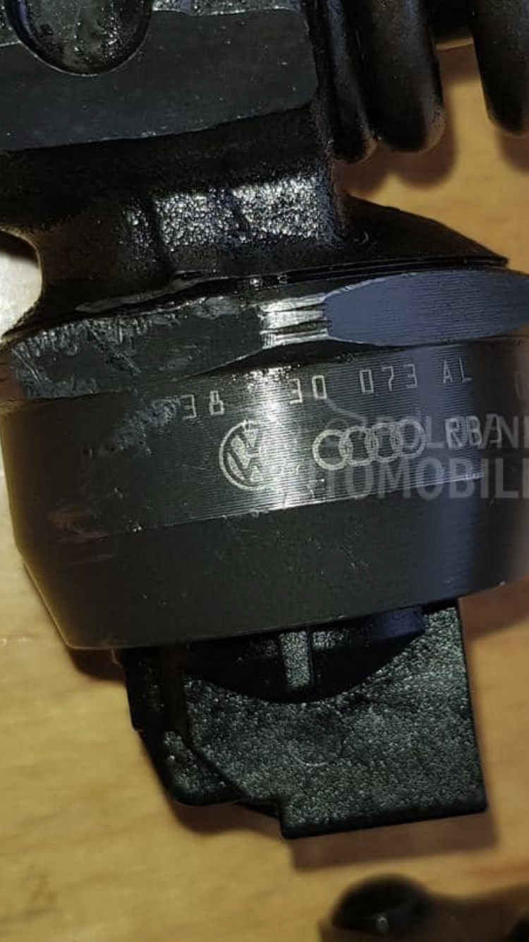

Guys, I got a set of these injectors for 180euros. The owner was selling them as “the injectors for tdi 96kw” and claimed they had been taken out of a Passat b5.5 96kw. Now, according to the numbers, they are the the same as ARL injectors, and better than BLT injectors, right? Are these injectors 520 or 550? (Sepulchrave suggested that some ASZ engines got 520 injectors… while all ARL injectors are 550) If I swap my BLT injectors with these, can I drive the car and test them for any issues before flashing the tune, without causing any damage to the injectors or the engine? Some people are reporting rough idle before the remap…. I would be nice to be able to install them and check them out, see whether they work within tolerances… As I have said, they are asking a lot of money to put a custom tune on the car (BLT injectors and ARL turbo) but with these injectors and ARL turbo, I can flesh a free ARL Stage 1 tune and call it a day, right?
Seems really unnecessary changing the injectors, all you need is the generic map for ARL PD150 turbo on a BLT, incredibly common upgrade done a million times on here, usually about 180 BHP and often done without changing the standard intercooler.

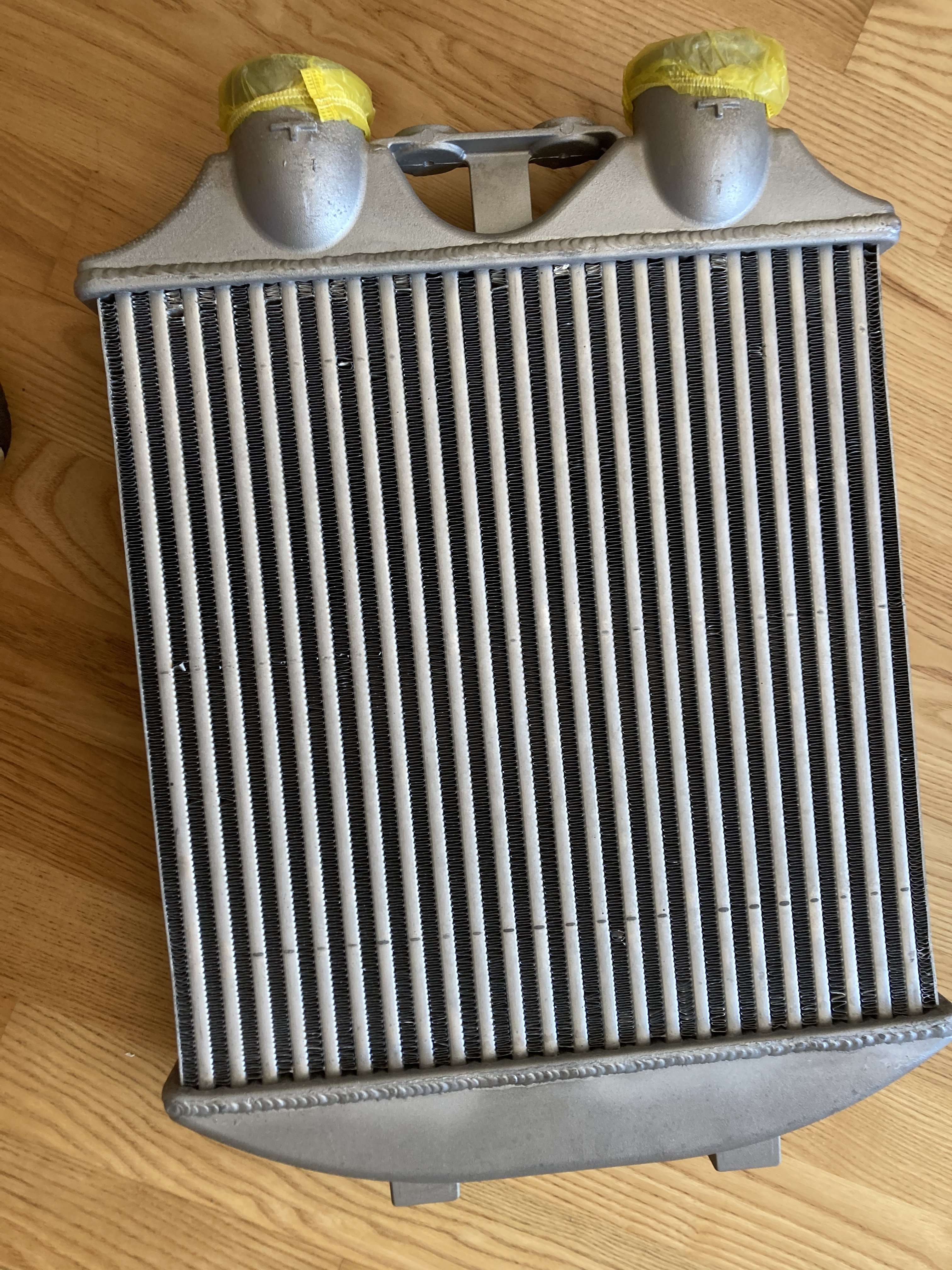

Speaking of which, you can get your leaky FMIC repaired somewhere good at TIG welding.
Why is everyone trying to make this so much harder than it really is?
Been to two ic and radiator repair shops and they said it can’t be done… They said replacing the core is the only solution… and the cheapest that I could get is 250euros for the hob…..So I bought a brand new replacement part for 150euros….  😁
