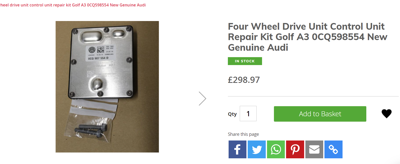

Hmm, I can see on OEMwolf.com, that the 0CQ907554D was superseded by the 0CQ598554 part number (as lll and 7zap both agree on), but neither of those numbers show (on oemwolf) as being superseded by 0CQ907554H.
skoda-parts.com which I've been using lately to find equivalences doesn't seem to know any of the numbers!
  • Sponsor
I wonder...
0CQ598554 is shown as a 'repair set' with the control unit plus two screws.
0CQ598554 is a kit which consists of 2 parts
  Part Quantity
1. Socket Head Bolt 2
2. Control Unit 1
Perhaps the control unit within that is the 0CQ907554H part, but for whatever reason on cars built before 7th Sept 2015 it needs a couple of screws to fit it, that the suffix-D part didn't??
Wild guess. :D
Google search on 0CQ598554 does show it as the control unit ?
  • Sponsor
My guesses aren't working out too well today. :sadsmile:
I wonder if the mounting lugs on the controller have been lengthened for more reliability and that's why they include new bolts ??
  • Sponsor
Or the screws just rust like buggery? 😆
