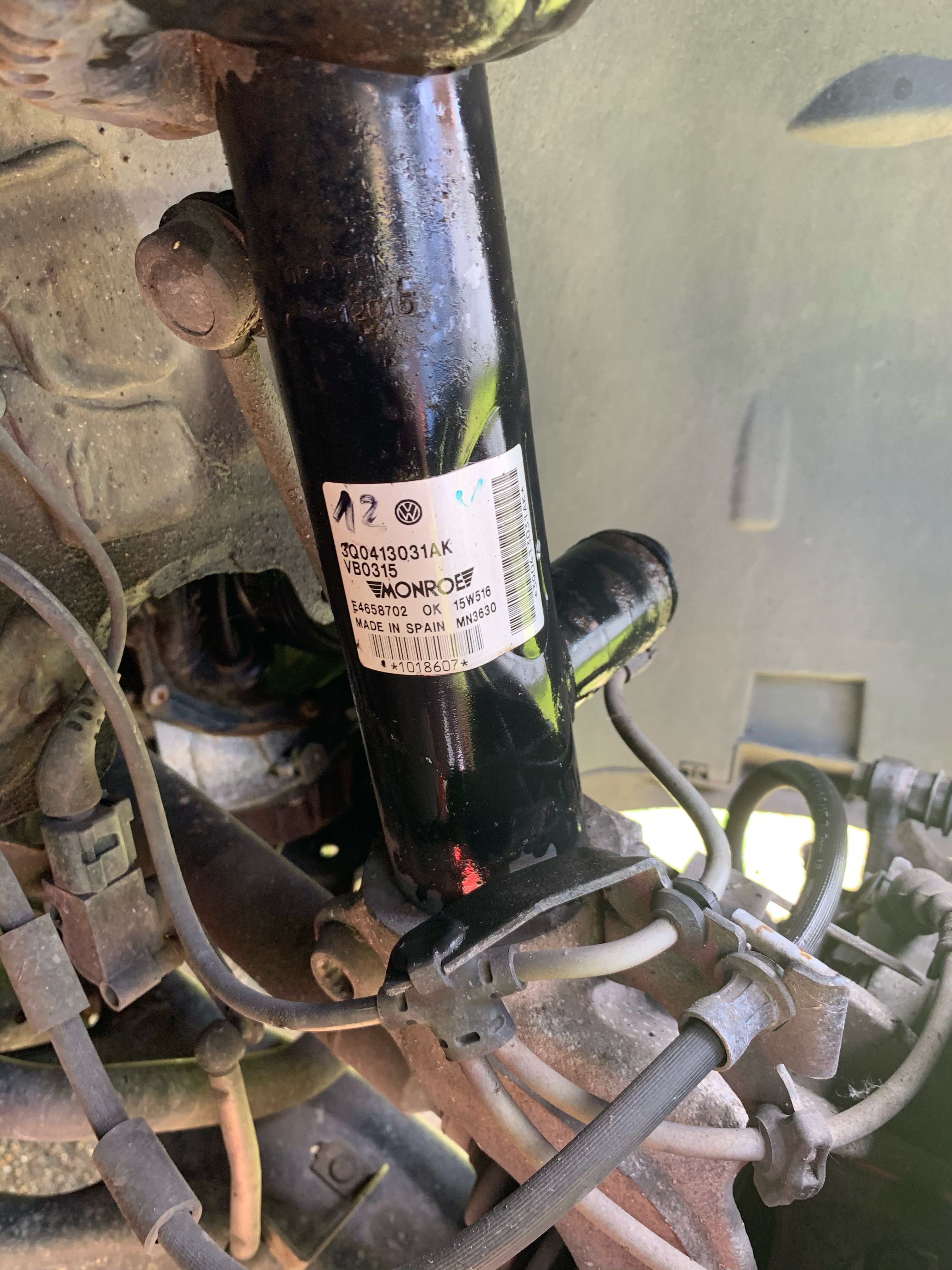

Perhaps this’ll help.
So those are replacements, right?
Curious who's making the OE shocks, could it still be Monroe?
Nope, the original OE units. Took that pic in June 22.
Monroe is OE and you can buy spare ones.
